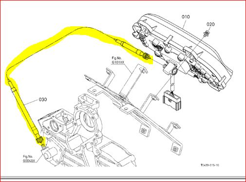

Good afternoon, I have an L3200 2015 would you know if the tach cable is a spinning shaft or something different? Mine stopped working wit h the hour meter. I am afraid a mouse got in there.
