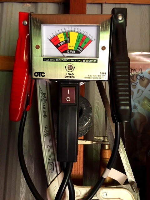

WalMart did the Load Test on that battery and proclaimed it “good”.
With a carbon pile tester? Most places have an electronic tester that doesn't load the battery. Goes off of internal resistance or something. Used to get a lot of calls about generators that wouldn't start. Normally it was a bad battery. As the engine dealer, the generator dealer would be out first and use one of the new electronic testers. I kept an old snap on carbon pile tester in the truck. They are great for many things, but load testing batteries and alternators is where they shine. If it's got a weak cell or short you'll never get the amp draw ou should.
Not saying anyone tested it wrong just don't see many places actually load testing them like we used to.
(y)
Yep, good tool to have. Not very expensive and can save you from going down a lot of rabbit holes.
It was a tester which printed out a result on heat-sensitive paper roll…so I’m presuming it was an “electronic” tester such as you mentioned. Don’t know if they’re not as reliable or as stringent as the old carbon-piles were… But that is also the same type NAPA used, and NAPA is fairly competent in most things they do. (That NAPA guy had an anger-management problem as demonstrated in that exchange. The battery was in the back of my truck, and with a Huge Sigh… he went to the back-room, laboriously carried it out to my truck…Threw the alligator-clips onto the terminals…and before I could follow closely enough to see the actual “load test” …he unclipped it an announced that 13 volts made it a “bad” battery…and hauled the tester back into the store.
I tried to clarify why he thought 13v was ”bad” …and he made the comment about it being “too much voltage = bad battery”…. so hoping to get him to print out the test results (as I knew that tester was capable)… I asked him what the load-test readout was…. as I had wanted to see that result.
He became agitated, virtually shouted …as he grabbed the tester to take back out to my truck… “I’ll DO IT AGAIN SINCE YOU‘RE SAYING I’M A LIAR!”
:oops:
(I have shopped that particular NAPA for 30+ years and it had recently changed franchisee… and this guy was obviously a new employeel)
I stopped him and said, “I’ll tell you what … Just never mind.”.…. and walked past him out the door…and headed to AutoZone. After his outburst I decided I’d stop shopping at our local NAPA until he was no longer working there. (He didn’t last a month.)
Anyway, a new battery solved the problem.
A simple “load test” of a battery is to turn on all the lights/headlights of a vehicle…wait 30 seconds…then blow the horn (if it has one) too see if it is loud/clear… and attempt a start. A healthy battery should have no problem passing that test.
