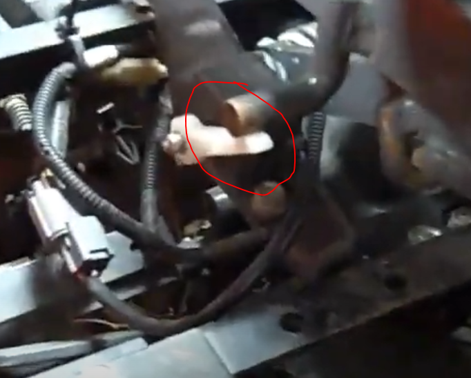

B2620 PTO safety switch function ?
10,347
2,170
Is it possible to loosen the nut and move the lever UP a few 1/16" ???
OR Is it possible to place a pieces of small pvc pipe or any round object and have it slide OVER that rod?
This will make the OD of the rod bigger and then it can push down harder on the lever.

I tried placing tubing over it without luck. As you watch the vidi it looks like there is less downward force on the lever then at the resting position. I am temped to put my dial gauge on it to see if I am getting any movement on the switch.
Thanks for helping to problem solve.

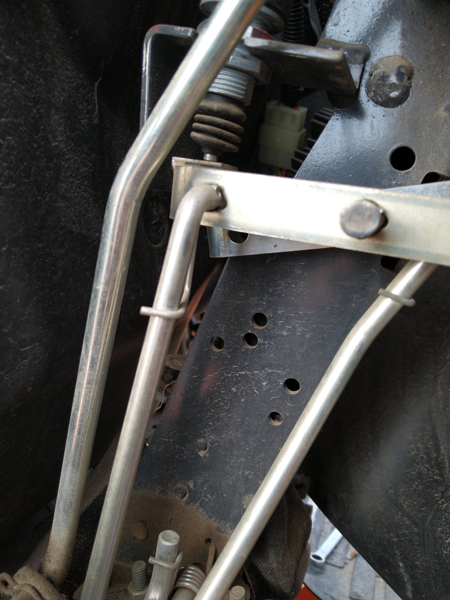

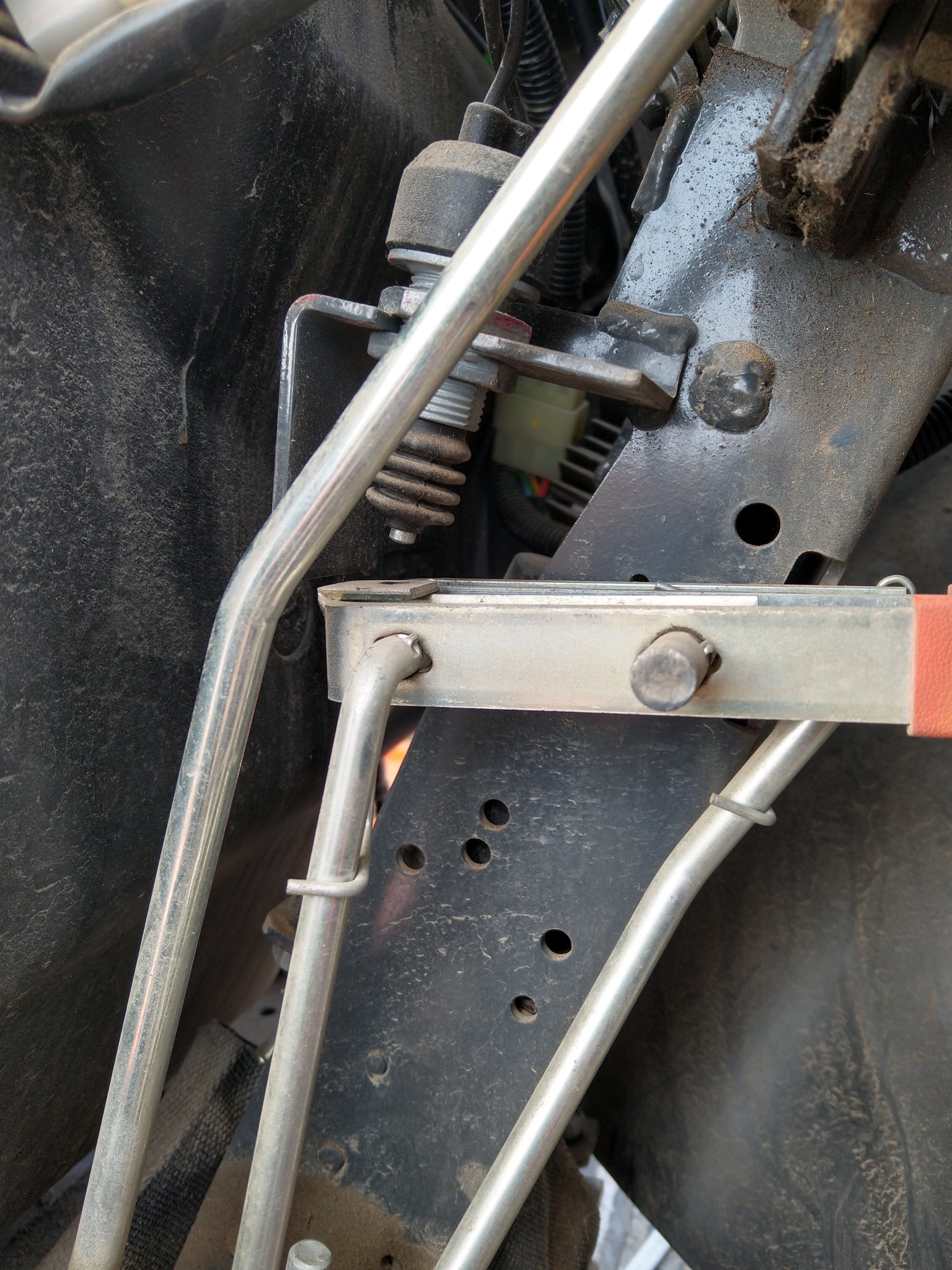

Was the parking brake firmly engaged when you get off the seat?
Asking because my B2650 has a parking brake sensor that when engaged allows for off-seat (riderless, seat safety switch open) rear-PTO operation, like while I'm running the wood chipper or post hole digger.
I adjusted the brakes at the last maintenance to the shortest stroke before brake engagement (1.18 inch in the specs) and when the parking brake was locked in, it turns out my park brake sensor switch was not registering it anymore.
So suddenly the engine killed when I stood up when the chipper was running off the pto this spring.
Once I figured it out, I backed the cowl off a bit around the steering column and accessed the sensor adjustor. Mine took several turns downward of the adjusting nuts to make it operate properly - pushed up when park brake engaged, and open as soon as park brake released.
Brake off:
Parking brake engaged:
Hope it helps!
Brake off:
Hope it helps!
Parking brake on. I have been using a work around by slipping the wiring harness over the level. That works ok but sometimes I forget to do it.
It just seems as if the seat is just not heavy enough to move the lever.

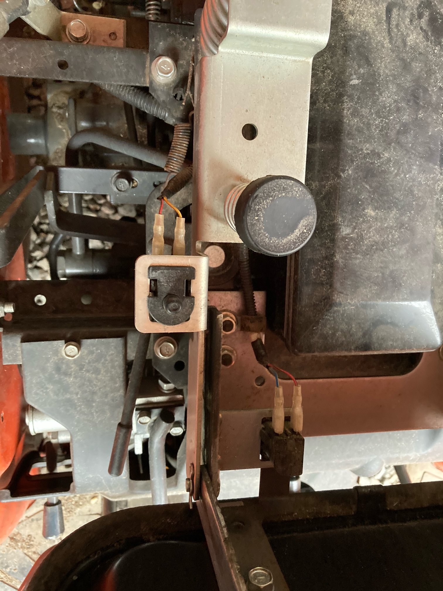

I just saw your post. Sorry for delay. I can take a picture and post it.
apatt
Kubota L3901, B2620
Mar 15, 2021
NH
Here is a photo with the seat up - compressing the up switch. The seat switch for seat down is the compression button in the center of the photo. The seat spring (round rubber) is between the switch and the tool box. So if I remember correctly, I can start the tractor with the seat up to run the PTO. I usually run a chipper or a woodsman's saw off the PTO.

Thanks for the picture. This is definitely a different seat setup then mine. The tool box looks like the same one that is mounted on my tractors ROP. My seat rotates to face rear for operating the BH65, does or did your B2620 have the backhoe?

No, mine did not come with the backhoe. That must the difference.

I went out and double checked and I can start my 2620 with the seat up, standing next to the tractor.
So I was right that when I work with the woodsman saw or the chipper that I can start it while off the tractor. In your case, if you can't start it with the seat up, you could look at what NBryan was saying and see if there is a way to rig it to push the lever down when the seat is up. It should start if the safety is disengaged.

What I do is loop the the wiring harness over the lever when I need to use the pto while off the tractor. This works just fine. It seems even if I could adjust the lever the seat just is not heavy enough to cause any downward movement on the switch. I need to take a measurement with the seat in both positions to see if it is actually changing positions.
