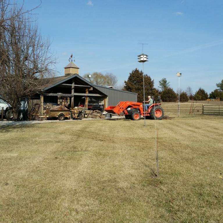

Here's one I built about 20 years ago. Just put new spring teeth on it last year. It is made from the pick up reel of a baler. Doesn't matter if it's a big round baler or a small square baler, the PU reels are pretty much the same. Four of them 6' long. Just build a frame to mount them in and the 3 pt.
It works real well for bringing up the gravel in the Spring after it's been pounded down all winter. A couple slow pass and it look like you hauled in tons of gravel.
The first time I used it on a lawn area it made a wind row and ready to bale. After the first years there isn't much to rake up.

I adjust mine (with the top link) so all the teeth are on the ground at the same time. The teeth are staggered, so they do a good job of covering everything.
Down pressure or weights are not required.
