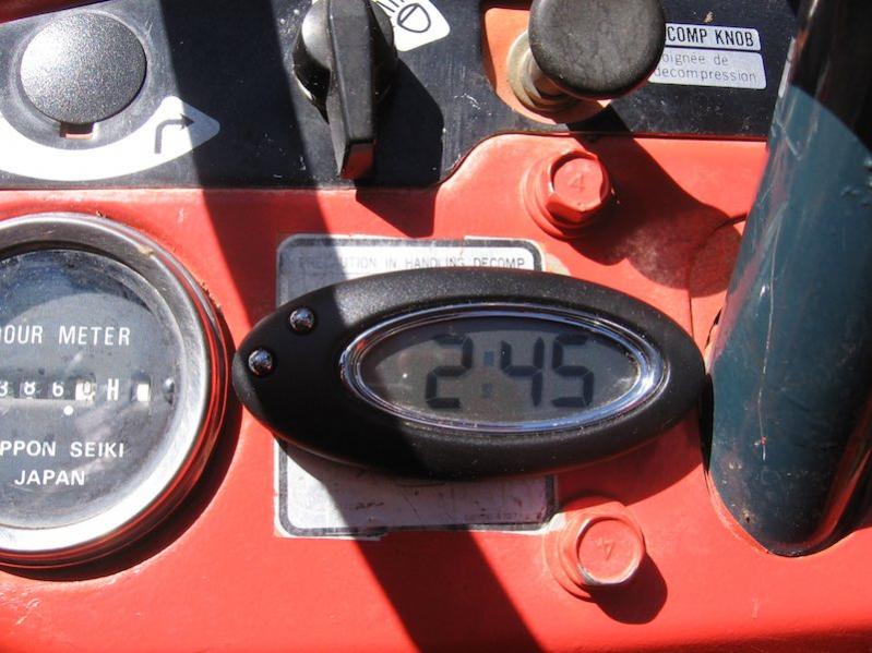

Do you guys use this on the older b models? The knob on my b8200 is stuck, and I think to figure out the issue I’d have to pull the valve cover. Maybe the cable is froze up? Thoughts?

The cable on my B7100 was froze up when i got it. A few zaps with WD-40 and working it back & forth and it is free like new now. I use it on every start up.
Although mine is a knob, not a lever, but same effect.

I didn’t get a picture of the starter, but I verified tonight that the cable is not froze up. The decompression mechanism is definitely froze up. I gave it a light tap with a punch to see if I could free it up but I don’t want to crack the valve cover. As of right now it has no problem starting in the cold so I think I’m just going to leave it. Maybe this spring I’ll pull the cover to see why it’s stuck.
Should I be able to pull the knob when the engine is not running or does this get pulled as it’s turning over?

You can pull it anytime really but can do damage.
Pull it out prior to turning key to the start position to allow engine to spin easily. Then push in when engine is spinning to allow tractor to start.
