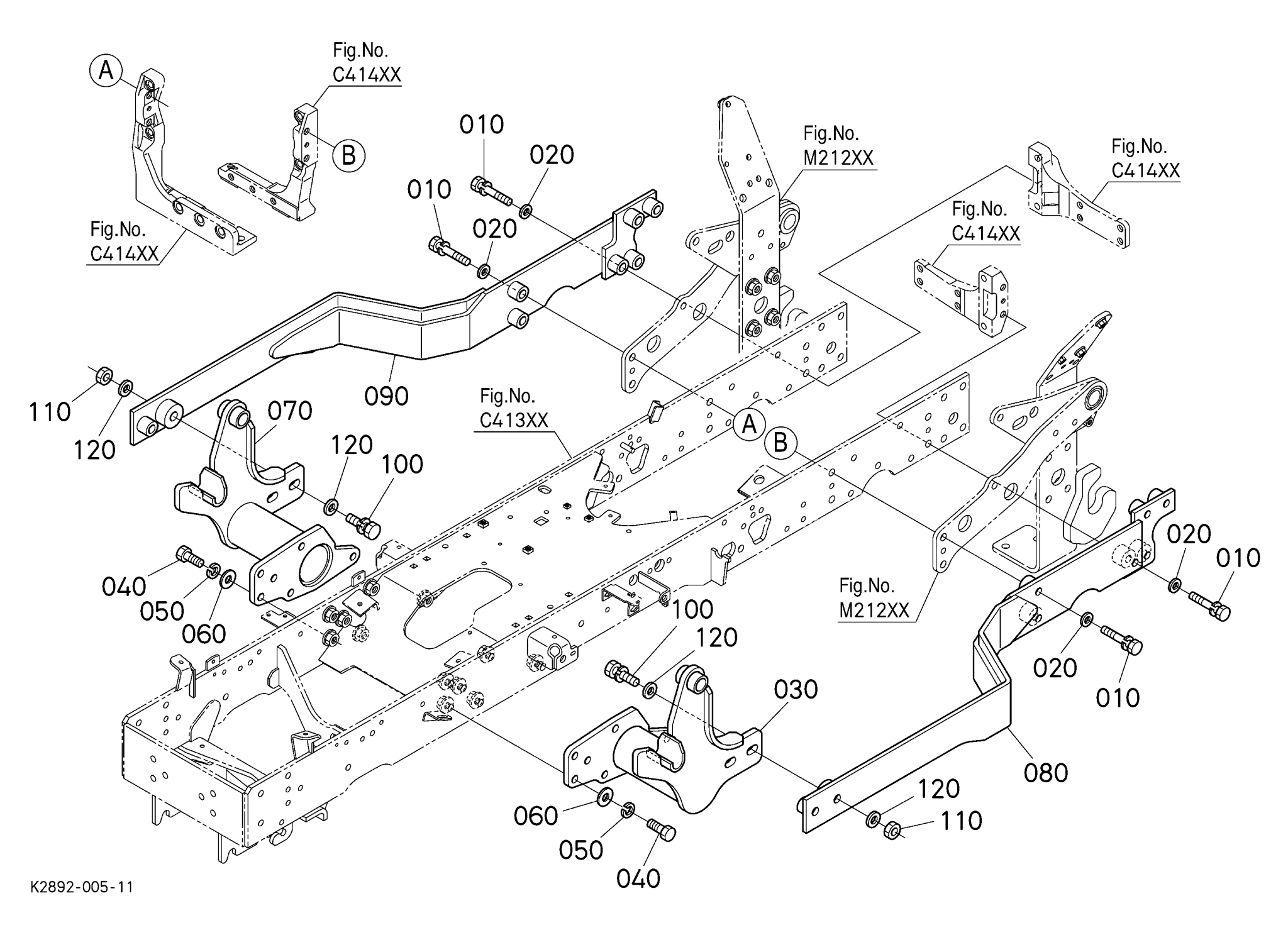

Ok, I was curious, looked up my BX23S at Kub CDA parts...
clearly shows all the bits and pieces for the 'sub frame', though I can't find figs M212xx online... if it's 'cooler' outside I'll look at my tractor to see how and where the 'subframe' is welded onto the front frame. One problem is WHICH 'BX' does the guy have......

well I'd like one of the guys who do know, explain how the diagram shows the subframe stuff.
I'd expected a 'special BX23S only' frame....

He doesn't explain WHY the 'subframe' is welded on or WHY all the parts for it can be bought(see #13 post picture )
I don't know of other BX... have the 'loopback' hydraulic couplers..haven't found real diagrams online. even the BX23S doesn't show it(though maybe hidden in some weird spot ....)
I can't believe the 'front' or 'main' frames are different.
hopefully domeone knows and will reply as to why...
