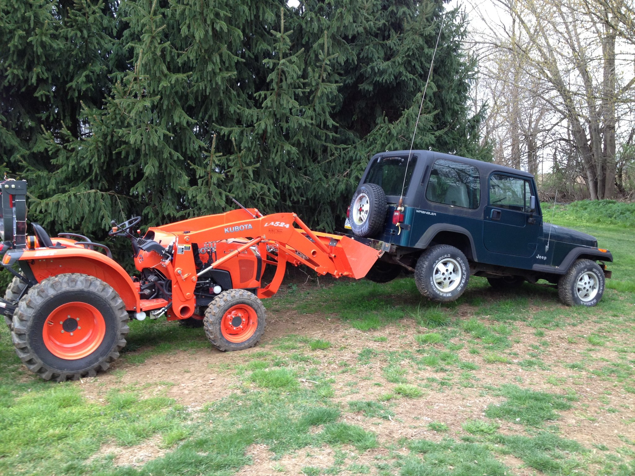

Bought a B series and wished I'd have gotten an L series. First L was an L3200 (below), but I wanted A/C and more HP, loader capacity and weight. We have 3-1/2 acres. Here's what the L3200 would lift.

Bought a B series and wished I'd have gotten an L series. First L was an L3200 (below), but I wanted A/C and more HP, loader capacity and weight. We have 3-1/2 acres. Here's what the L3200 would lift. View attachment 49617
I can do that too but I can pick up the entire vehicle, not just the backend. (y)
