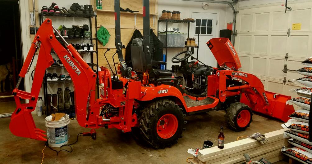

My new BX25D. First things first - Fire up the heat gun and let's get all those silly WARNING! Stickers off!! Besides - with all them stickers gone she's got to be more aerodynamic! :D
Now - Where to get 12V DC power??

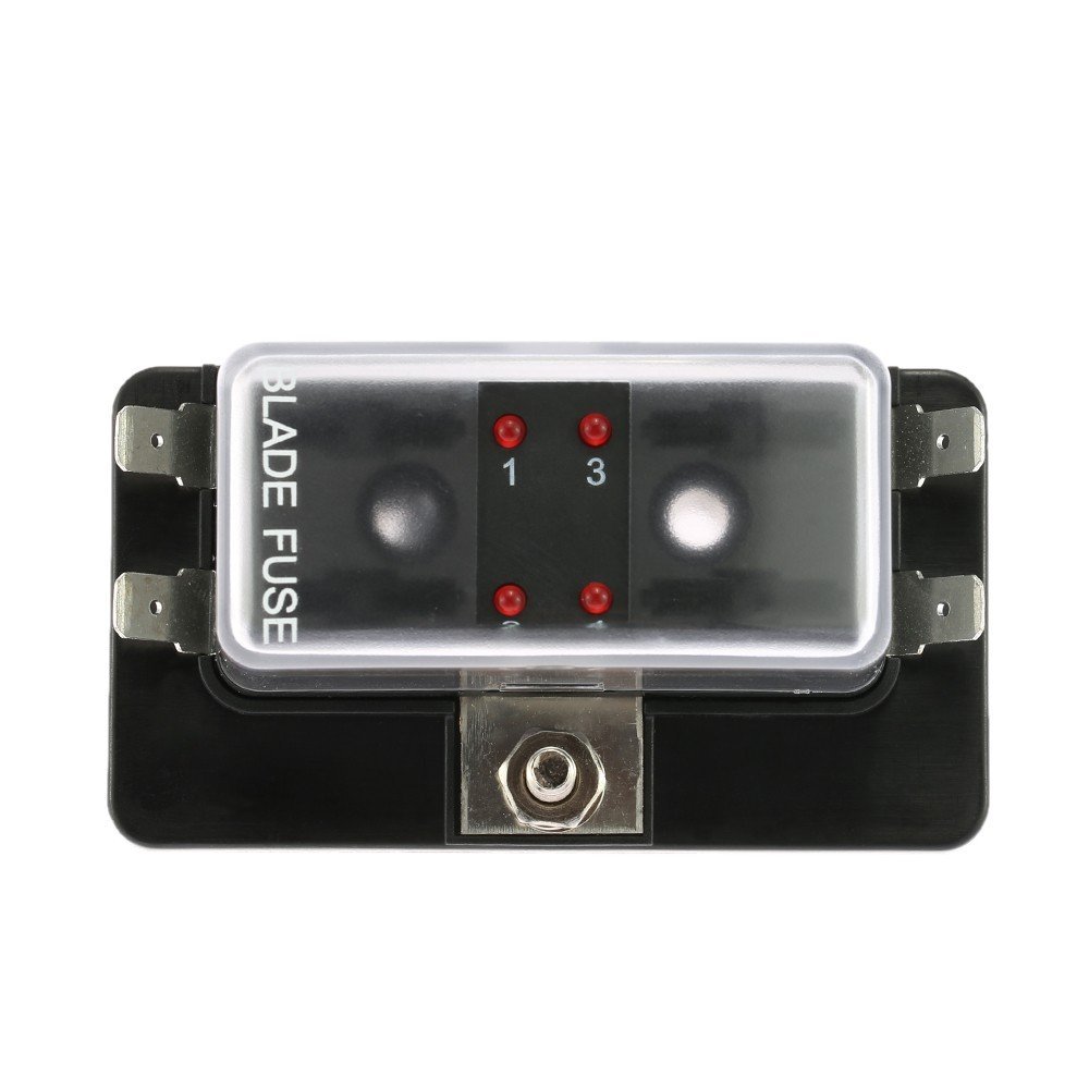

Plus I got some water proof switches, 4 twelve volt relays and all the do-dads to make it work. This way, all the electrical upgrades are being done at once. The fuse box will leave me two other protected circuits for expansion.
NOTE: There isn't a whole lot of room under the dashboard by the battery compartment. I want all the NON-STOCK electrical add-ons to be powered only when the ignition is switched on. On the stock fuse box there is a 12ga (20AMP fused) wire that is switched and feeds the "cigarette lighter" outlet under the seat. I'll cut that out and use that circuit to power the low draw side of the relay that controls to excite the coils through the Expansion Fuse Box. I'll protect all the expanded devices with 10AMP fuses. Even the stuff that goes to the high side of the relays will be protected with 10amp fuses for extra protection.

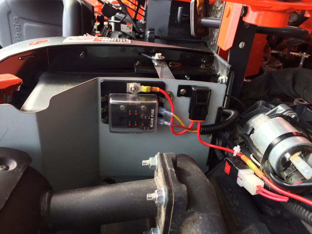

I used those switches too, they work great and have held up to the rain and snow well this winter. I also added a weatherproof fuse block, mine is not switched at the moment, I may do that later, but it works well as is for now.
BotaTrac
Kubota B25D, Kubota L305DT, Kubota L2501D, Ford 681 Select-O-Speed
Mar 16, 2017
102
Hogwarts Academy
Great Job! Clean and very neat......

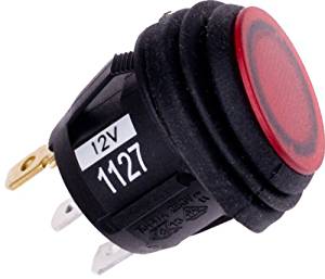

Could you post the link to where you got the switches please?
No problem........
Amazon: http://a.co/87vqNDr
They're $7 a piece with Prime. DO NOT buy the cheaper ones that look the same. I assure you that THEY ARE NOT!. You'll know exactly what I mean when you snap these on and off. Waaaaay better feel. Good luck!
