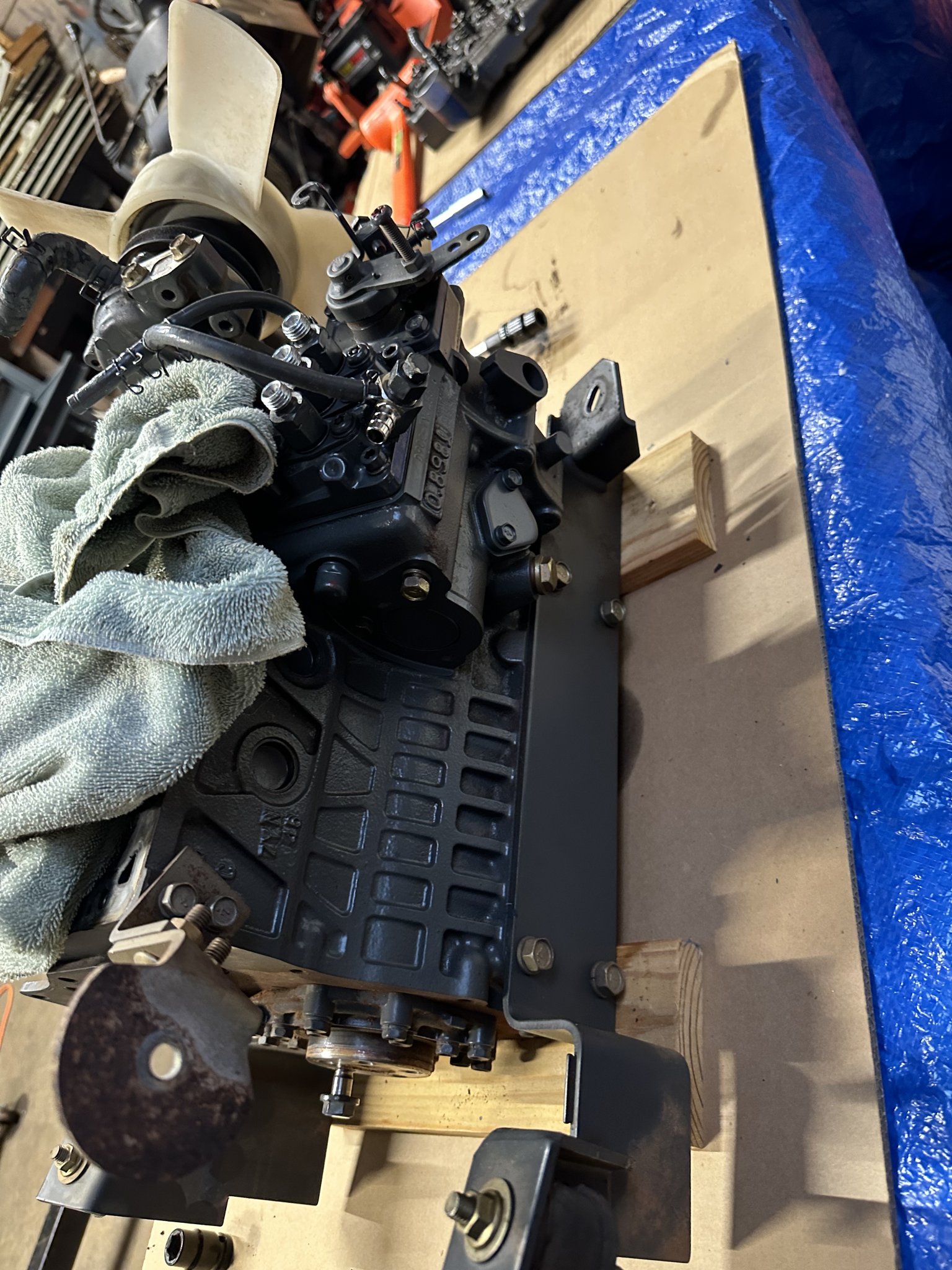

usually on the block under the injection pump. There is a machined surface, under and to the right of the pump, that has the engine number stamped into it. Often it's not easy to find, so look real closely. It should say something like "D902E-28873" or something. Everything after the dash is the serial number.

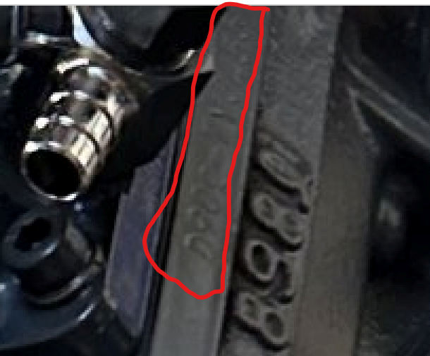

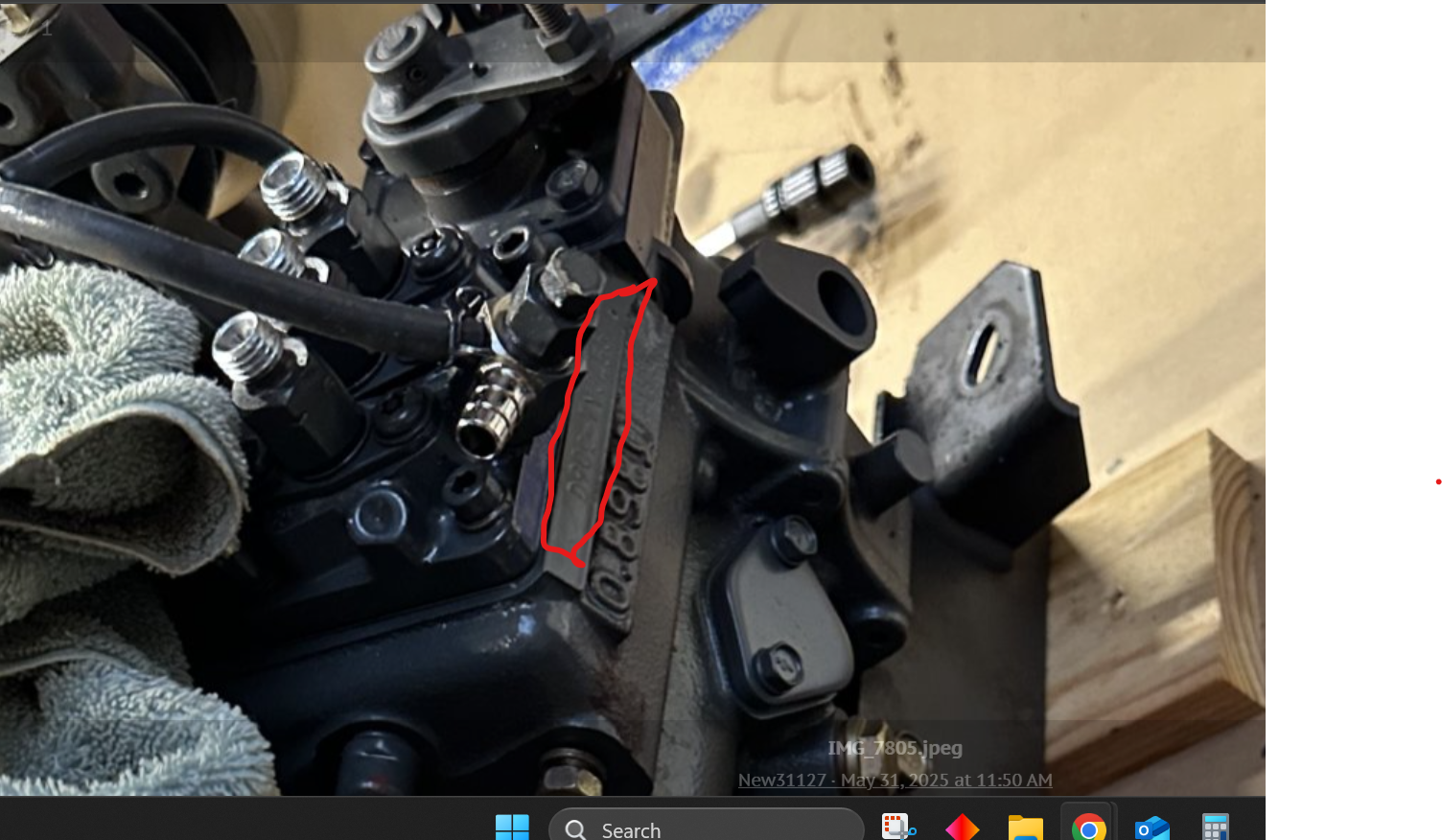

Would be my luck block is already at the machine shop anyone’s eyes good enough to see the rest of the numbers
33,183
8,569
I have really good software and a 32" computer monitor, and I can't make it out.
