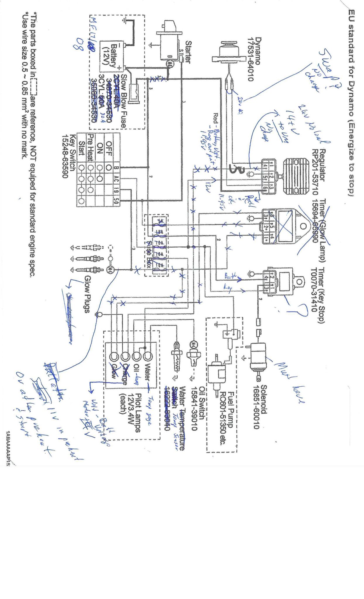

Did that connected and disconnected. Both readings were within the spec. Like I mentioned I even swapped the leads just for fun. Unfortunately I only have a partial wiring diagram. This is a (DELETE) chinese with a Kubota D722 and they won't release any info as it is "top secret". Which is funny as for about 3-4 decades I did maintenance on Corporate Jet aircraft and their info is fully released. Here is what I've got from Kubota and modified as best I can from my work. Since the VR output is low with no load it leads me to believe there is something with the dynamo. But with the dynamo fully plugged in, at max RPM I get 20VAC. Which is spec.

checked ,the dynamo's rated for 14 amps, the the rect/reglator is 6 pins, black MUST go to good ground.
I'll have a look see if I can find an actual schematic of what's inside the 'regulator'

OK, grabbed and turned your diagram and 'they' show pin 2 of the regulator going to a 'ring' terminal that is screwed into the 'frame'. If possible run a wire (16ga+-) from there to the battery -ve.
If there isn't a GOOD ground, reg will not operate properly.
