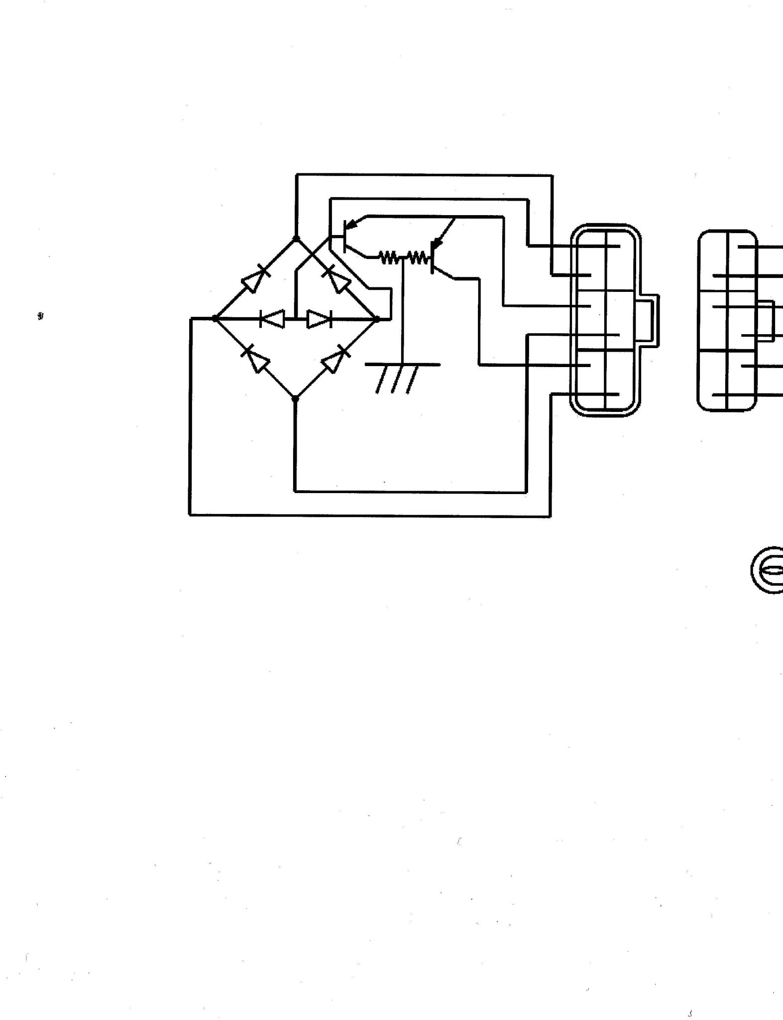

Wiring looks similar to the unit in ZD-21-28.pdf.(from kubotabooks.com)
If so it consists of 2 parts, a full wave bridge for actual battery charging and a section with 2 PNP transistors ,and 2 resistors to control the 'charge ' light.
So if the guts are as posted, there is NO 'regulation' form the unit, rather the battery conditions dictates the charge rate. 20 VAC becomes 28 VDC ,so more than enough.

checked ,the dynamo's rated for 14 amps, the the rect/reglator is 6 pins, black MUST go to good ground.
I'll have a look see if I can find an actual schematic of what's inside the 'regulator'
20 volts going in is good,
I'm supposed to get freezing rain at 3AM tonight.....probably get the 'leftovers from you , thanks !
OK, grabbed and turned your diagram and 'they' show pin 2 of the regulator going to a 'ring' terminal that is screwed into the 'frame'. If possible run a wire (16ga+-) from there to the battery -ve.
If there isn't a GOOD ground, reg will not operate properly.

Assuming the 'VR is same as this one, there are 4 diodes in a bridge( diamond pattern) that convert AC from the dynamo into pulsating DC to charge the battery. there is NO 'regulator'. The 2 diode,resistors and transistors are used to control the 'charge' light .
