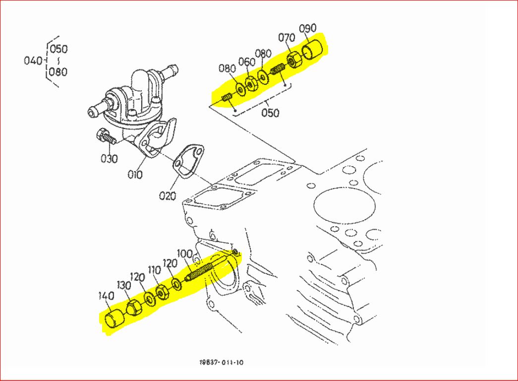

If the injection pump rack will not move to get the pump out, you can try removing the front and rear stops, (they will be under aluminum caps that you will need to pull off to get access to the nuts), note how deep they are set as this is a critical point on it running right when your done.
when the stops are out you can use a fine punch or steel rod to push the rack into place to remove it.
Just to make sure, you have removed the throttle plate and side cover and springs right?
