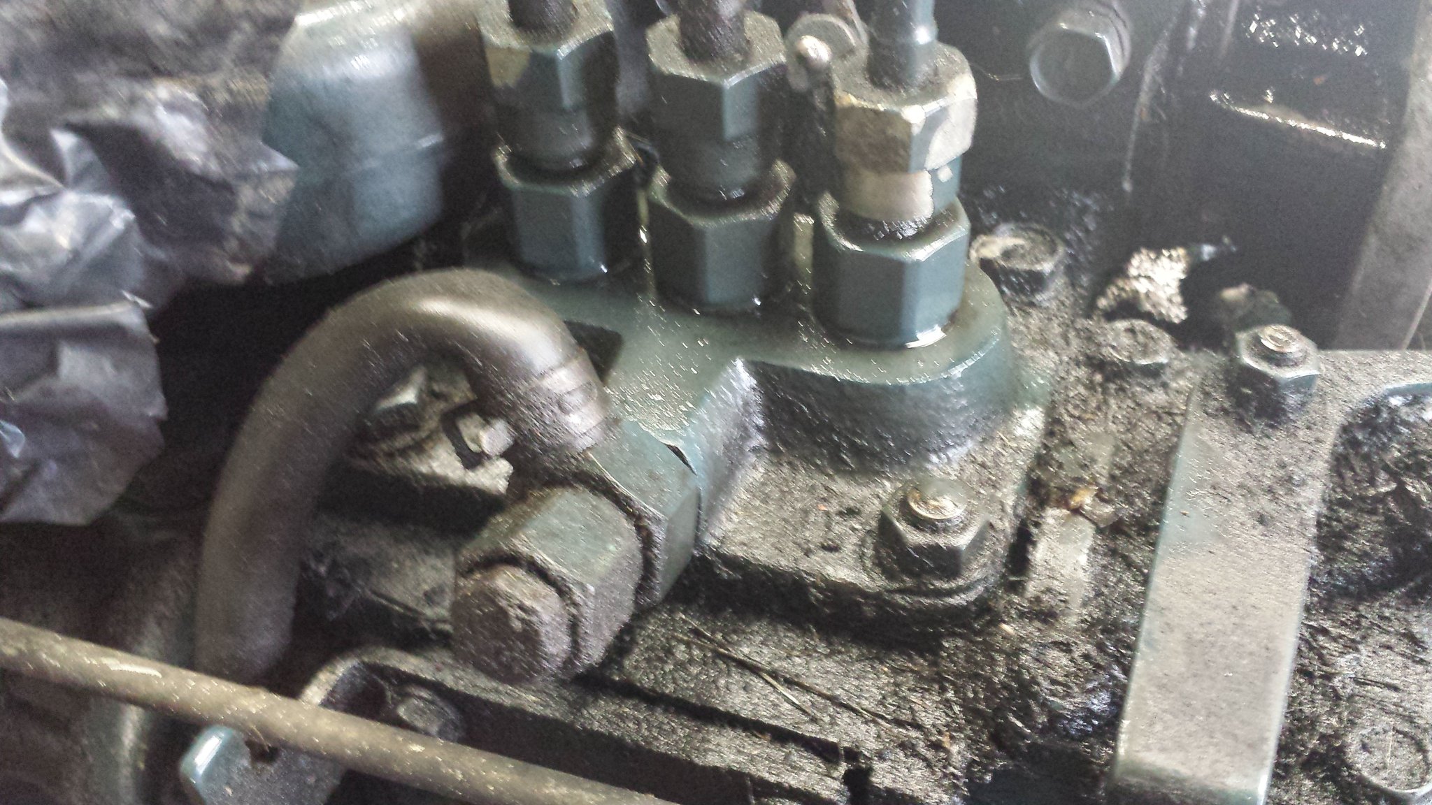

Snow day from work, so I am braving the cold in the garage to do a bit of work on my new to me G1900. I replaced the dead fuel pump so she will stay running and quit starving for fuel. Now to tackle this fuel leak. Leaking fuel from between that clamping plate that holds the injector elements into the pump body. Is there an O ring in there that i can carefully replace? Runs fine, just leaks fuel and makes a mess. A reman on ebay is over $400 or more. If there is a simple fix, I would rather try that first to save some money. Yes its dirty, this thing lived on a farm with livestock, so its gonna be a bit ugly till warm spring weather when it will meet my pressure washer and some degreaser. At least she will stay running under her own power now more than just a few min. Baby steps here. Mike

Simple fix ...... but IF THE middle one - you need to remove left or right to get to it!!! I tried to make a 17 mm fit in between ..... took a box end wrench and ground out the middle to loosen the middle nut........ nope - wrench broke as I expected it might.
Make sure you are holding the bottom nut as you remove the top - 17 mm on top I think.... and 19 mm on bottom - If memory serves me.
Mine needed a new O Ring - that ring was easy to replace - getting it off was the fun part.
Be careful ONCE it is loose - there lots of little springs and ball in there...... drop one of those on the gravel drive and it sucks to find!!!! BTDT! ok - not really.... I was warned to go easy when removing.
Mine was a mess too!

Yes, there is an oring on the plunger you can replace. I dont know if this matters or not but the safety screw holes on the plunger tangs closest to the engine block are slotted. Mark the position of the tangs with a chisel, punch or something so you can get them back in the same position. Ive no clue why one side is slotted but I marked mine before I pulled them when I saw the holes were slotted/egg shaped.
Who knows yours may not be slotted.
