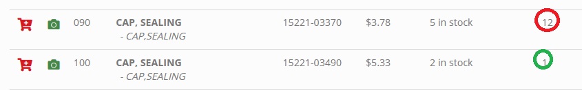

There are two different sizes as shown below. 12 of the smaller ones and 1 of the larger.
