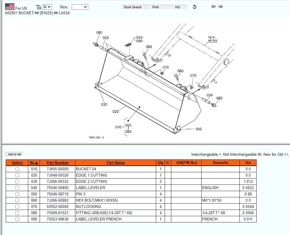

D dkbswim Member Equipment B2601 Feb 6, 2021 31 23 8 columbus ga Nov 21, 2021 #22 19thSF said: There is an edge available for the pin-on bucket. I don't know if it would fit. View attachment 70129 Click to expand... those are the weld on cutting edges if you were repairing a bucket

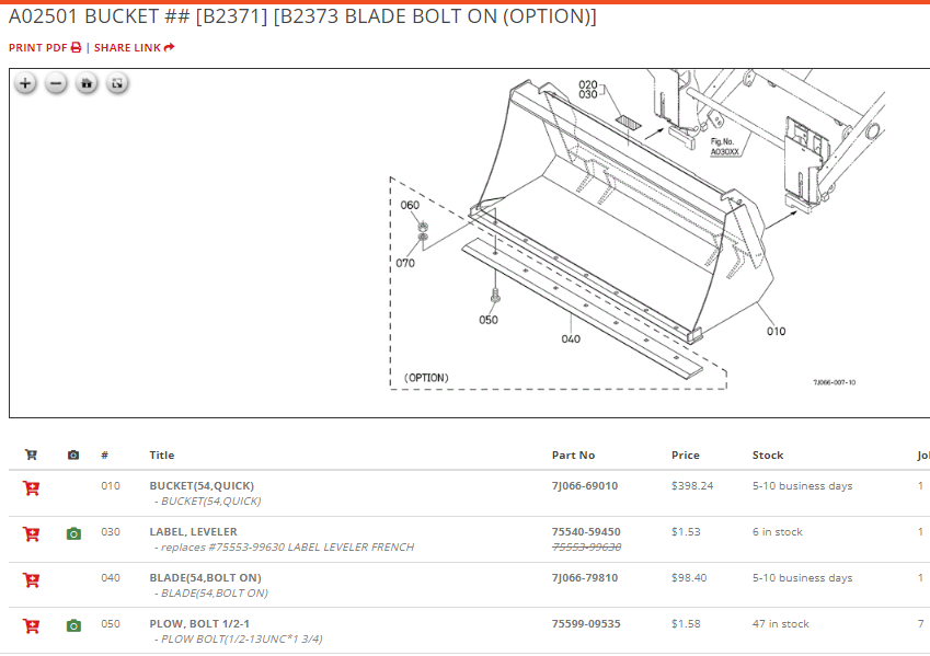

P PorkBolt Member Equipment B2601, 60" MMM, SSQA FEL, Kubota Ballast Box Sep 22, 2015 38 3 8 Elburn, Illinois Nov 22, 2021 #23 Petey Kubota said: Any one know where to get a bolt on cutting edge for the bucket on my Kubota b2601 with a bucket model number b2324 with seven holes that are ~7 3/8 inch spaced. and total bucket is 54 inches Click to expand... What’s the intended use?

19thSF Active member Lifetime Member Equipment B2650, loader, MMM, pallet forks, tooth bar, rear blade, JD 318 w/plow, JD X350 Mar 1, 2020 398 120 43 Glendale, Rhode Island Nov 22, 2021 #24 dkbswim said: those are the weld on cutting edges if you were repairing a bucket Click to expand... Thanks, I see that now.
