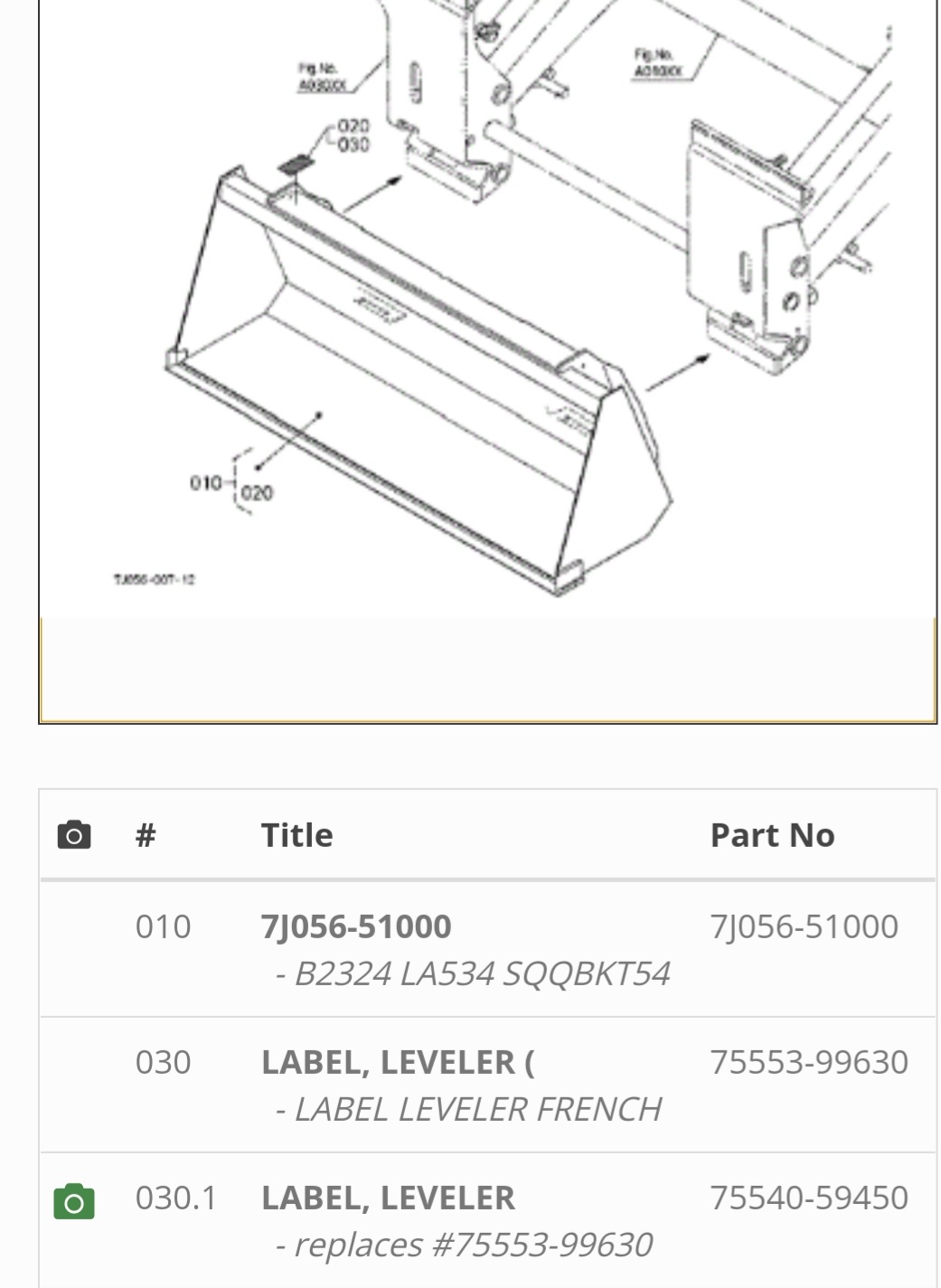

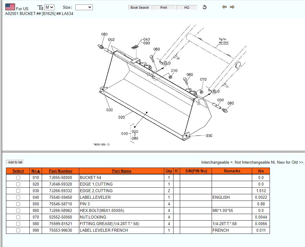

Here is the parts diagram I found for that bucket. Couldn't find any reference to a cutting edge.

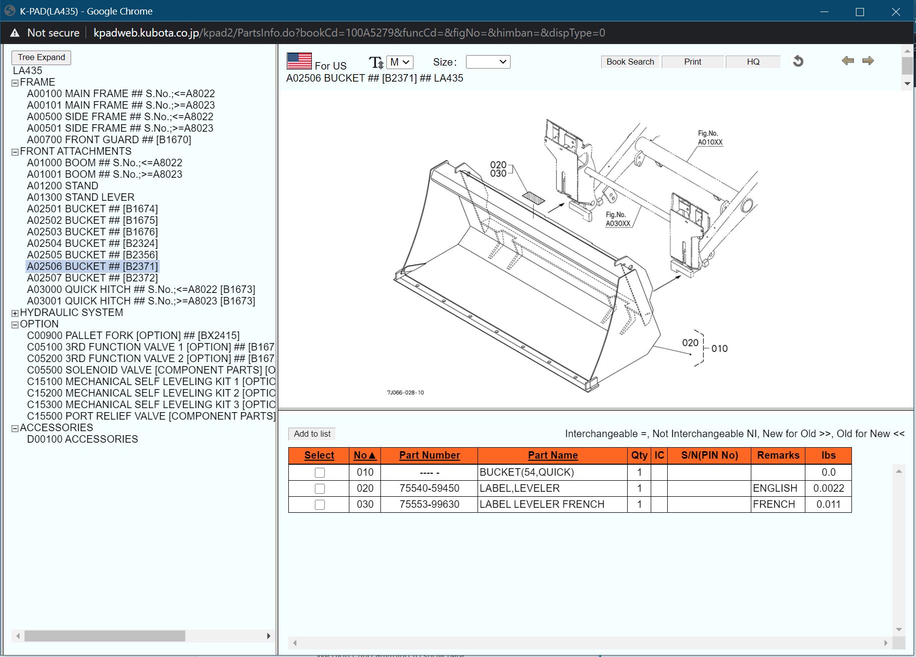

The cutting edge for the 54 inch B2371 quick attach bucket on the LA435 is accessory B2373. Not sure if that would fit your bucket?

weird. I found the bucket with the holes for the cutting edge, but not the cutting edge by itself.
