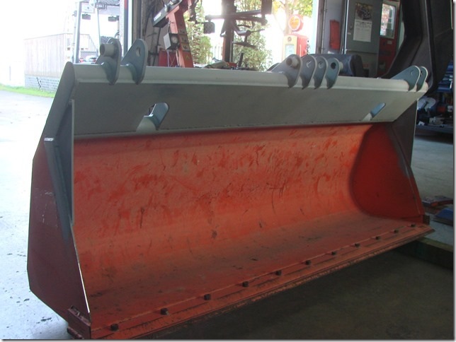

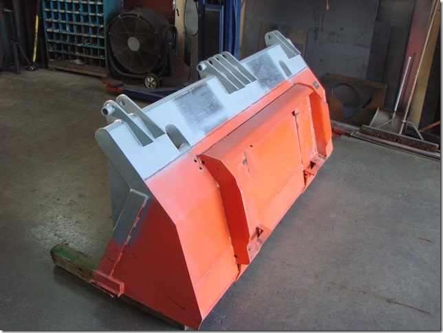

Seeing its along weekend I decided to start my latest project. I'm converting the bucket that's on the 5740 to a grapple bucket. I got a good bit done today. I had fabricated a spill guard on it a few years ago and wanted to keep it so I'm working around that but so far so good.

Hmmmm this should be interesting,, Oh and Happy Thanksgiving my friend

Thank you. You guys don't have Thanksgiving the same time as us? Now really. Do you find that old bucket interesting? :D
