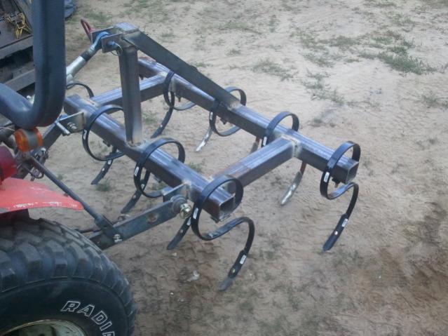

I made my own spring tooth, I have 2 sets of teeth for it one narrow one wide.
Wolfman that looks great! I have a bunch of 2" Square from a project and I want to make one of those for behind my L260 once I get the trans put back together. How many tines should I look at getting and do you have any dimensions that I could copy for mine?
Thanks! This site is the best!
33,385
8,699
It's out on loan to bearskinner right now, he was ripping up a little land last week, when I get it back I'll give you dimensions.
I just use a little miller wire welder, but it works for me. ;)

Hi Wolfman. Did you need to add any weight to your cultivator or does the geometry of the tines pull it into the ground. Thanks for the great advice from all who replied to forum.
HighSierra79
B7100d, M6800 w/FEL, 7' mower, 7' box blade, 42" LP tiller, 5' rake
Sep 1, 2013
74
MO
I bought a nice dearborn two row, cut in two sections, and made a three point hitch for the other section. I got it at an auction for $150. Now I have a middle buster/one row cult, hipper/hiller, and a dedicated cultivator with 4" sweeps. One unit became two. Best part, the old dearborn allow you to move horizontally/vertically the position of your tines, and allow great diversity if you have old horse drawn stuff laying around, discs, etc.
33,385
8,699
The tubing adds a little weight but yes the tines actually keep it digging nicely!
