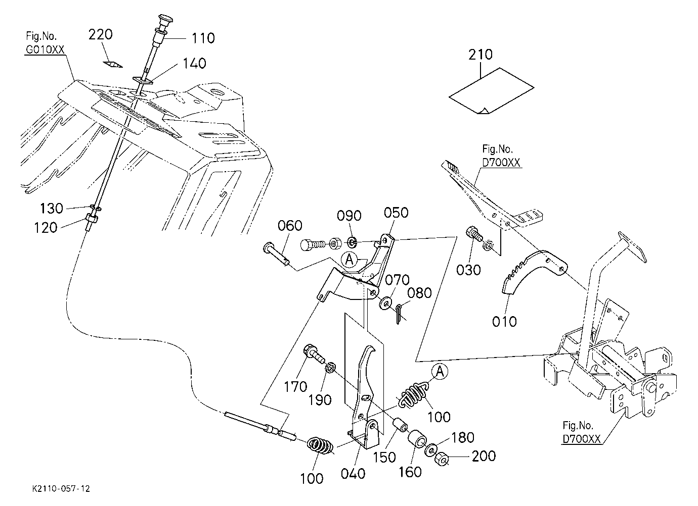

I see mention of an optional Cruise Control on my G2160. No mention of how it works or the breakdown of parts etc. I am a little interested as I noticed when I am pulling my sprayer going up hill the machine slows considerably. I don't think it caused me any issues but I would like to perhaps be able to set a speed and have the machine "hold" it.

I looked at online parts...nothing obvious about 'cruise control'...

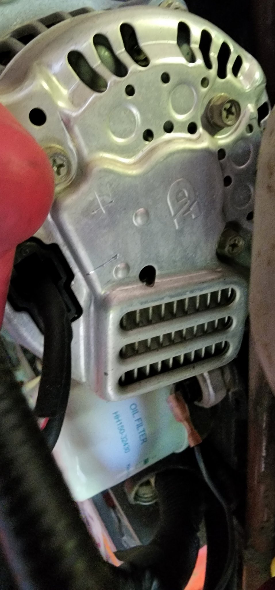

unknown if alternator has a 'tach output' signal (which most alternators will have if diesel engines )

Post a pic of the back of your alternator. Maybe someone can spot a tach signal terminal.

Hey, will do. I may have it out today and will shoot a photo. I gotta say that cheap little tach I put on my little Honda tractor was awfully handy. When I used my sprayer, I simply set the engine speed to 2200, engaged the hydro to full "mow" speed and turned on the switch. All I had to do was maintain the 2200 RPM

Not sure this will help or not, but on my B2910 all cruise control does is hold the direction of pedal in a certain position. I don’t think it maintains speed at all when slopes are encountered. So I never use it and give it a big thumbs down. (n) No comparison to cruise control in my road vehicles.
