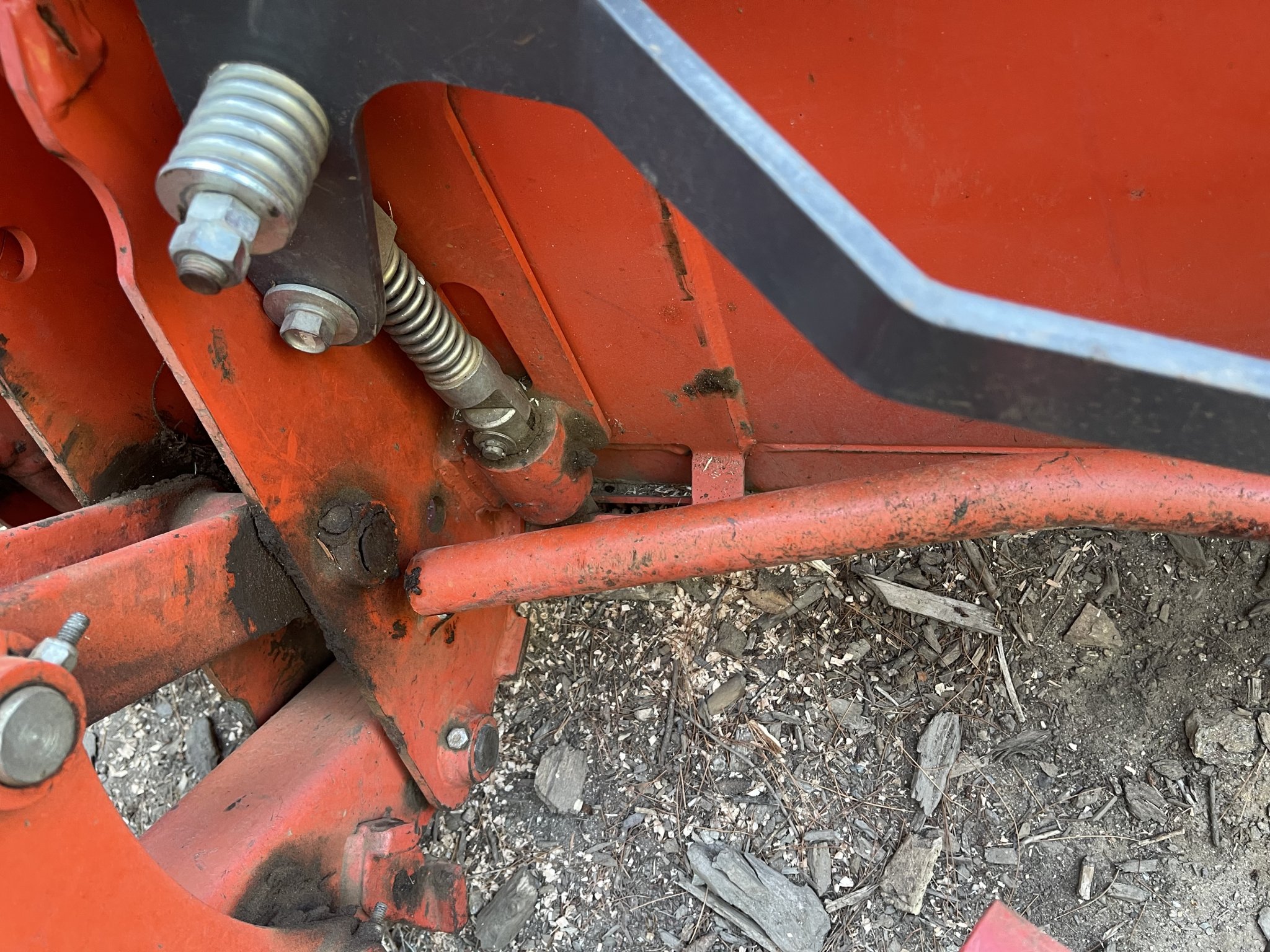

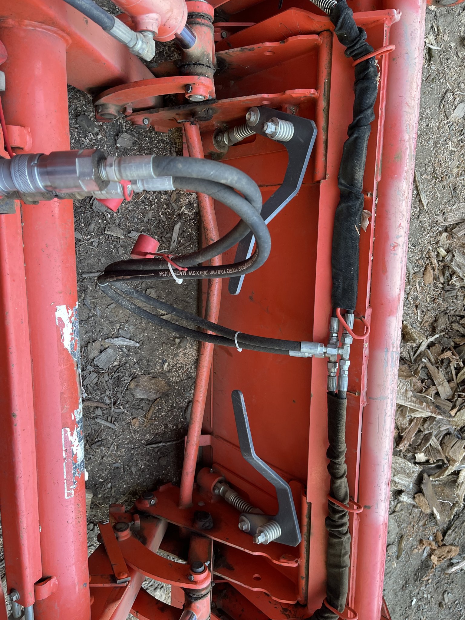

Hi, I lent my B26 to a friend and he managed to break the bar that goes between the quick-release pins (I'm not sure what its called). A couple of questions...
What's the easiest way to get this fixed? I assume find a welder to straighten and repair the bar?
I assume the bar is important otherwise it wouldn't be there. Am I going to run into problems if I try to take the bucket off and put some forks on? e.g. is that bar essential to keep the quick release pins in line/sync IMG_2449.jpg IMG_2450.jpg ?

take to weld shop, cut out old bar, weld in a new one. Be SURE to coverup the latching parts first though !!
keep bucket on, measure the distance to be sure it's square ,true, correct.....
old bar will always be 'weak' and you can cut/weld new one faster and cheaper than straightening the old.

That bar does in fact keep the ssqa plates in line. I bent mine a little when one pin got released by a stick popping up while backing up and the forks bottom caught a stump on one corner. Straightened flat again easily enough using loader hydraulics and a hardwood block.
If you release the ssqa from the loader bucket with that bar snapped the plates will drift out of parallel alignment with the hydraulics operating them unattached. The loader frame will maintain stiffness of the boom side to side, though.
If the ssqa plates aren't too badly out of line when trying to attach the pallet forks, then curling the forks up all the way, once the top of the ssqa plates have been hooked into the forks properly, will force the pistons to re-align flat to the forks frame when the curl hits top.
Then the pins can be locked. Once the pins are engaged the pallet forks frame maintains stiffness and that broken bar has no active purpose.
So I's say go ahead and use the forks even though swapping off the bucket might be a little trickier until that stiffener bar gets repaired.

Replacing it with a new piece of HSS ( hollow structural steel) would be best, and just as fast as trying to straighten the old one. I would go with a piece of box material, stronger and easier to weld.

A quick update, I ended up purchasing the replacement part (I got the last one left in stock in the entire country) and my friend paid for it in full. I got lucky next time I'm saying no.

I had the same issue on my L3901. I detached the curl ram on the bent side where it connects to the loader arm on top. Then I put a hitch pin in the same hole and used my Hi-Lift jack with the top assembly folded down. I put the jack on the top of the Quick attach plate and the other end over the hitch pin. I jacked it to about 1” beyond straight to allow for bounce back. It worked to perfection. Took about 20 minutes. The part alone was over $1000 and wouldn’t be available until sometime next year. Hope this helps someone…Mike
