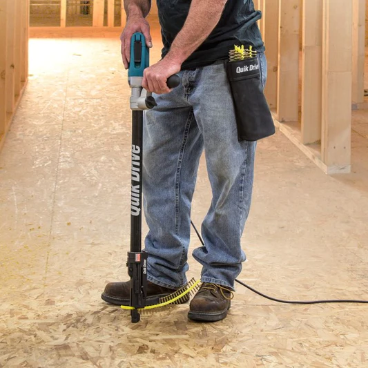

I think they suggest a screw every 6 or 8 inchs so I rented a stand up style, belt fed, screw gun from Home Depot and it took 1 or 2 days to put in all the screws in my entire house ( ~10,000+ screws if I remember correctly).
I have no crack or squeaks anywhere in my house.
