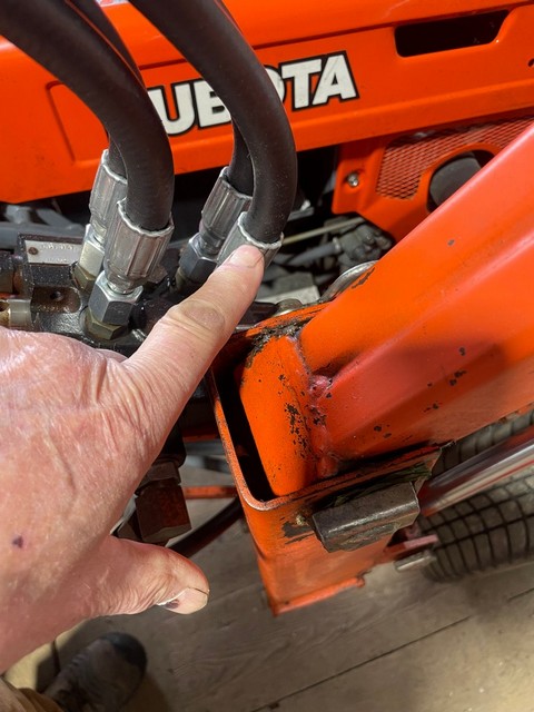

The three connections to the tractor are:
PUMP
That is the rightmost hose on the outlet block and it delivers pressure out to the P port on the valve
POWER BEYOND (PB)
Also known as High Pressure Carry Over (HPCO) this is the leftmost hose on the outlet block. It carries return pressure from the N port on the valve back to the tractor to power the three point. You must install a power beyond conversion sleecve in the N port to use this function.
TANK
This is the hose going to the top of the transmission. It carries low pressure return oil from the cylinders back to the reservoir. It connects to the T port on the valve.

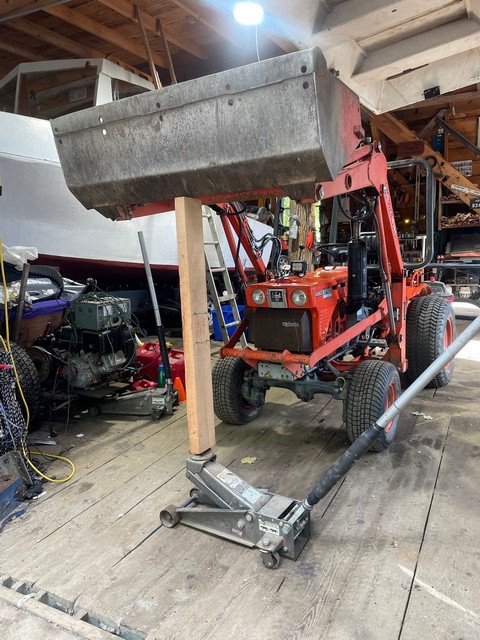

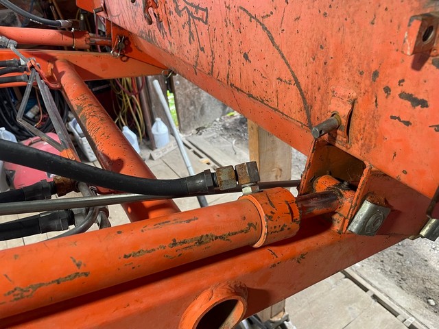

Thanks, Dan! I did the test: Results here.. I'll be back about valves next...
Blocked up before plugs
Port to lift extend
(Trying to be sure I did this right!! Heres line to the lift cylinders "Extend")
valve port to Bucket "Retract"
Line on bucket cylinder "Retract"
Lines Plugged
OK, removed the support. Results:
LIFT cyclinders leaked down 1 inch of cylinder rod travel in 30 minutes !
BUCKET cylinders didn't move much initially, until I put my 170 pounds on the blade. After pulling bucket down to center of travel they leaked down 1 inch in 60 seconds.
* Don't ever bet on Dan being wrong, at least with Hydraulics.
SO I'm in the market for a valve, and Sometime 2 bucket cylinders. I'll be back next, when I look at all the lines again. Re: "Market" - Not absolute, but I'd prefer some Amazon valve because I have some credit there and not a lot of floating cash... SS does have adapters.

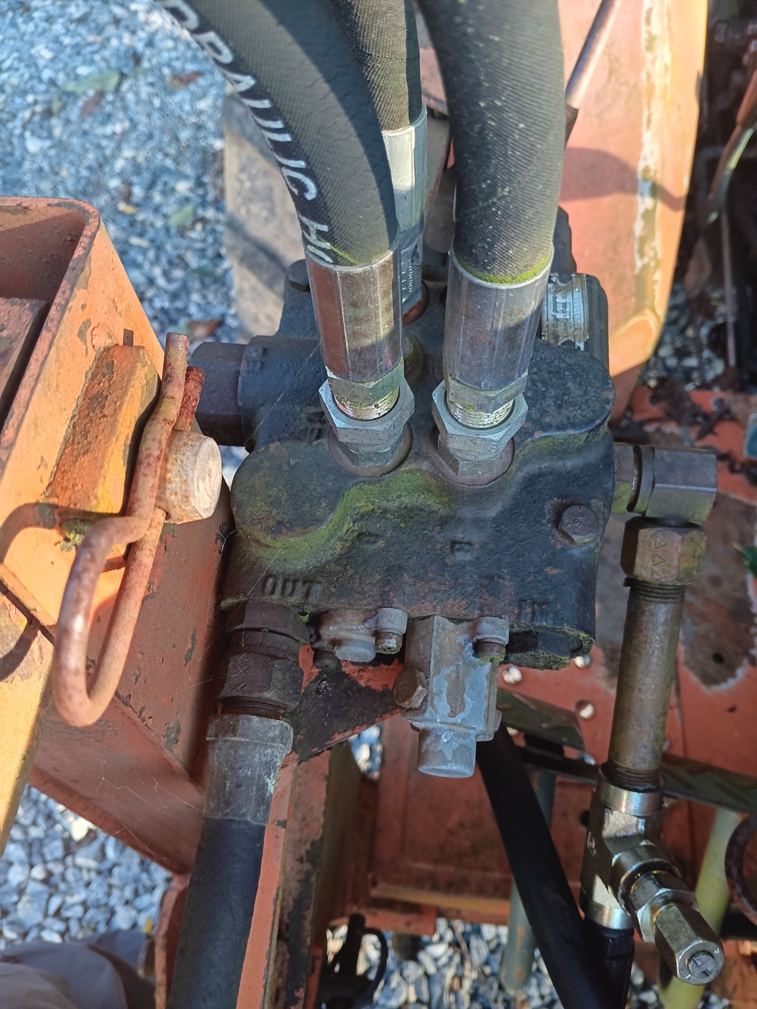

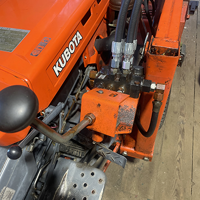

Hmmm. My OEM valve does not have a FLOAT position for the lift.
Is it possible to connect a cross valve between the two connections to the lift cylinders to optionally Float those cylinders? Is this ever done?? Might be good for snow plowing? Hmmm...
If the valve is OEM it should have float. Post a picture of your valve.
Edit - pictures earlier in the thread. That valve looks like OEM and should have float. Move joystick to lower position and then push hard.

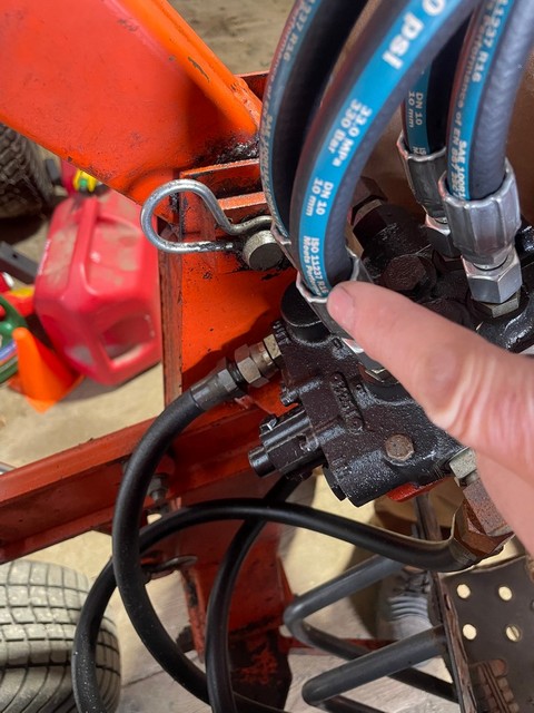

Hi Dan, pushed real hard and didnt travel differently... (Photo)
BUT: The joystick is worn. I'll ty to move the spool manually...
I DID find some interesting stuff. Seems it IS OEM,, HERE

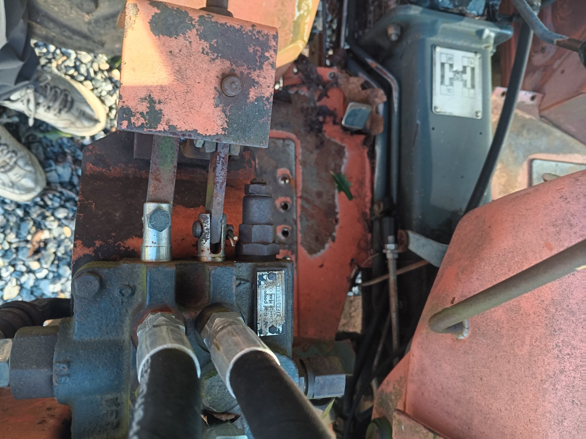

Post a picture of the other end of the spool. Here is mine. Last two pictures show position of spool in pressure down and float.

... position of spool in pressure down and float.
THANKS for taking photos and taking the time to discuss this.
I will take photos but I think my valve looks just like yours. I will test the possible positions but it looks like my total spool travel is same as yours. Does yours FEEL different in those two active positions? IS there some kind of detent?

The spool in mine is clearly further in.
There is a detent between pressure down and float.
Post a picture showing the backside like I did and we will know for sure.

your valve has a fourth position (float detent) end cap.
Sure does... Have a good photo from morning light that shows it..
AND testing in the driveway, there IS a difference between holding a smaller-movement down and an all-the-way ' FLOAT.. NO Detent though..
