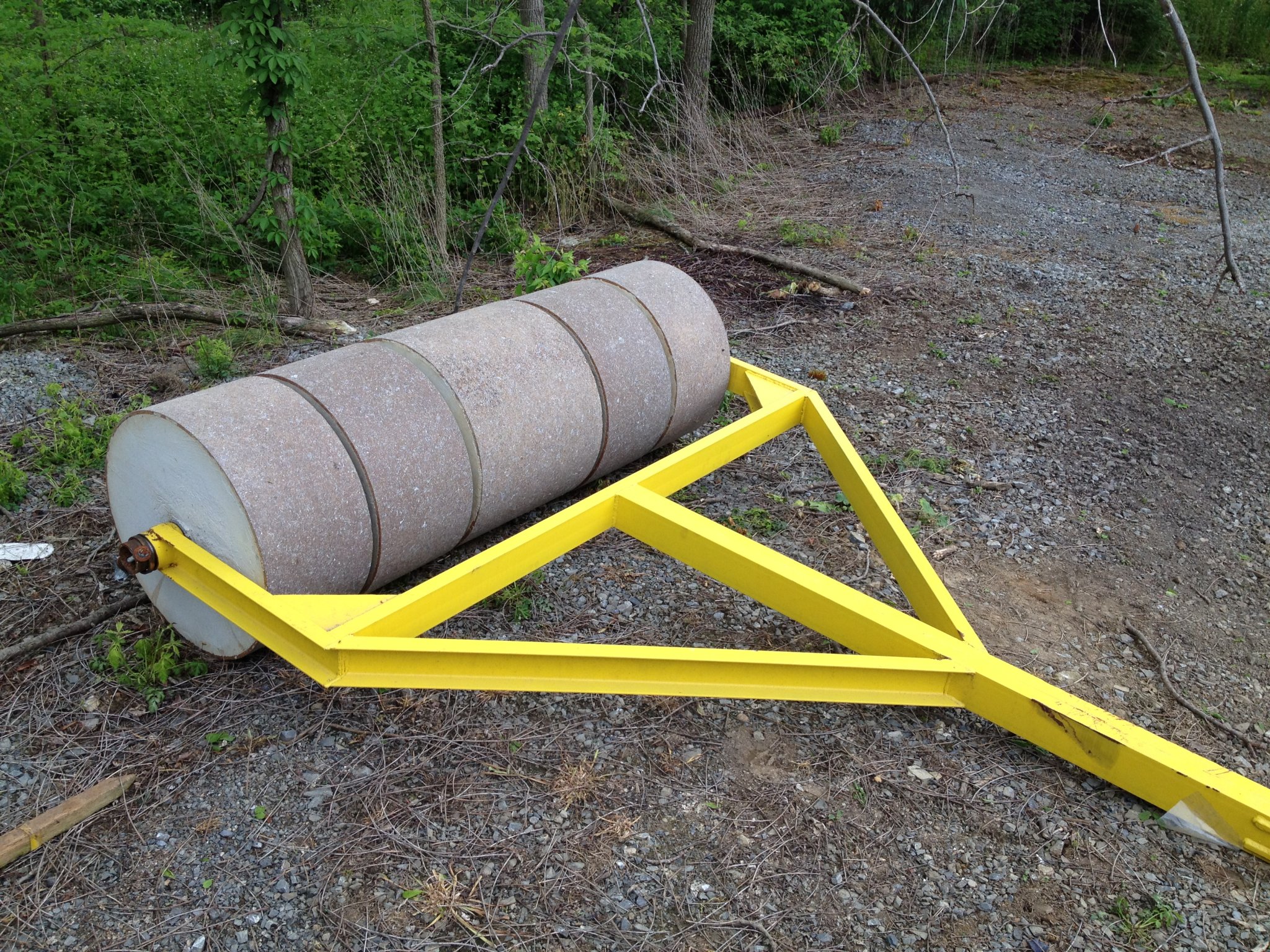

We made this at work a few years ago to dress up some larger areas of gravel material storage. It's made from 12" slices of 24' SCH 40 steel pipe with an 18" piece in the middle. I went with sections to assist with turns. If it were all one piece there'd be some skidding, especially on short turns. Connected to the drawbar with that long tongue it'll turn easily.
The pieces have rebar spiders that hold pieces of 3" SCH 40 pipe in place for the axle to pass through. These are 13" long. The extra 1/2" on each side of the concrete donut maintains a 1" space between the sections so they won't bid on turns. The main axle is a piece of 2-1/2" pipe running through all the sections as an axle. That provides enough play to let the individual sections have a little freedom of movement.
It worked well on the gravel areas. We tried it later on some asphalt millings and it didn't do the job. For that we rented a vibratory ride-on roller. I brought it home once to roll an area down by the creek to get rid of some bumps. It was ineffective there as well even though the ground was soft at the time.

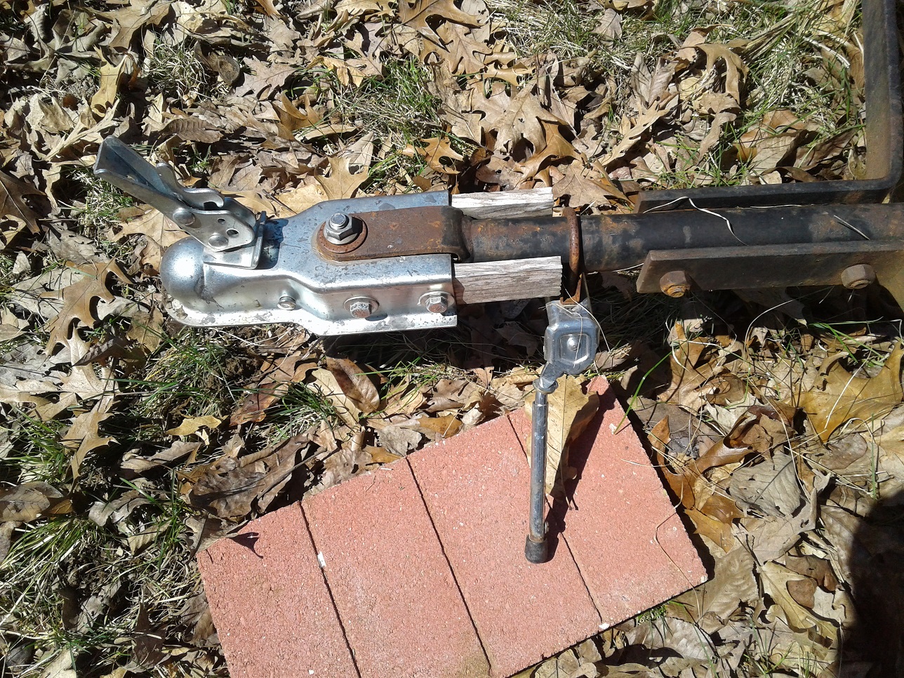

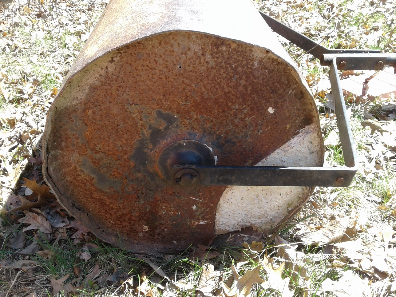

4' used roller filled with concrete weighs around a ton hard to hook up here's my mod for a trailer mover.

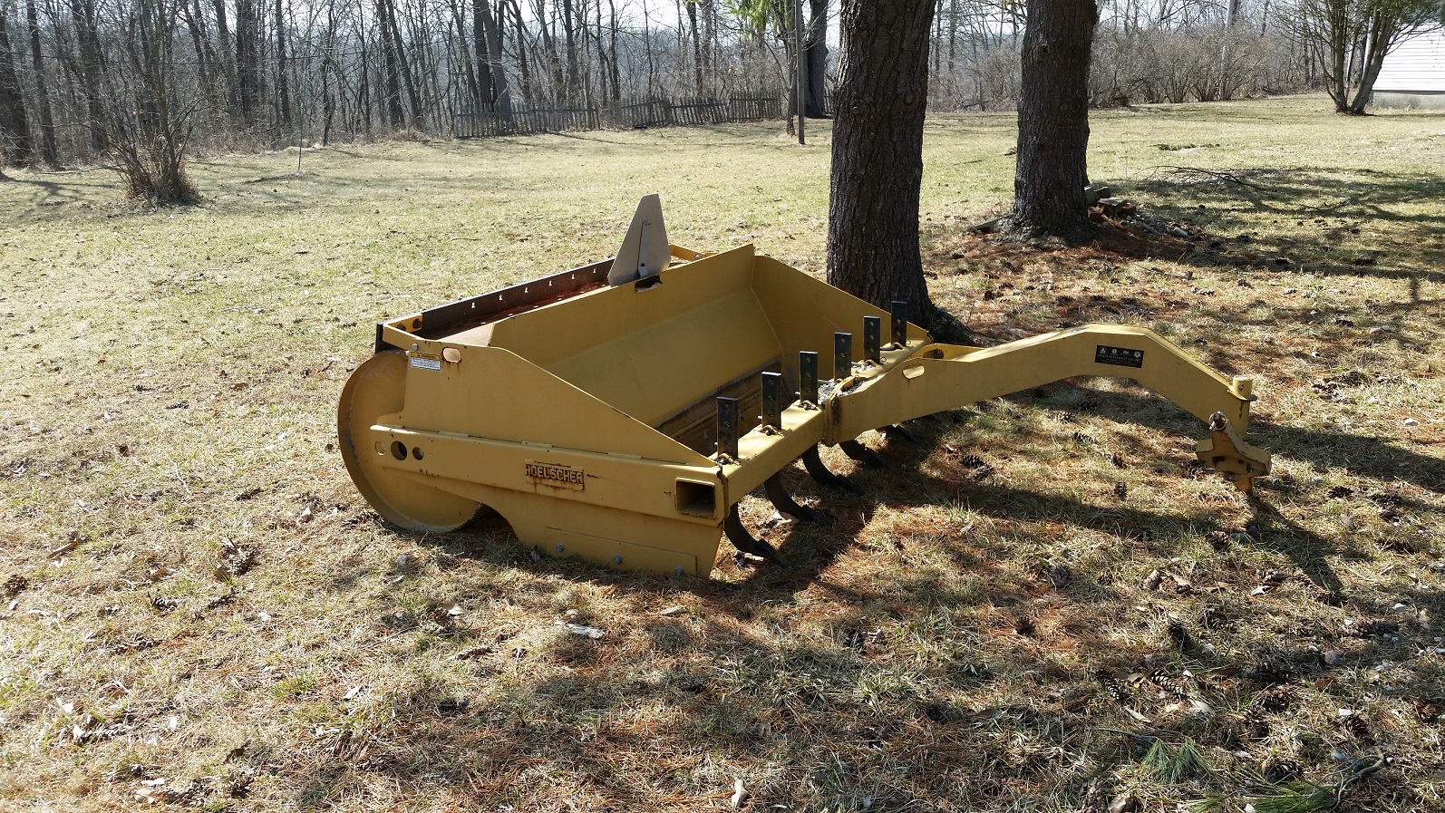

Commercial "Rolling grader" empty weight about the same as cement roller.
Have 3 different tractors for power units. Fun to show off, gives neighbors .

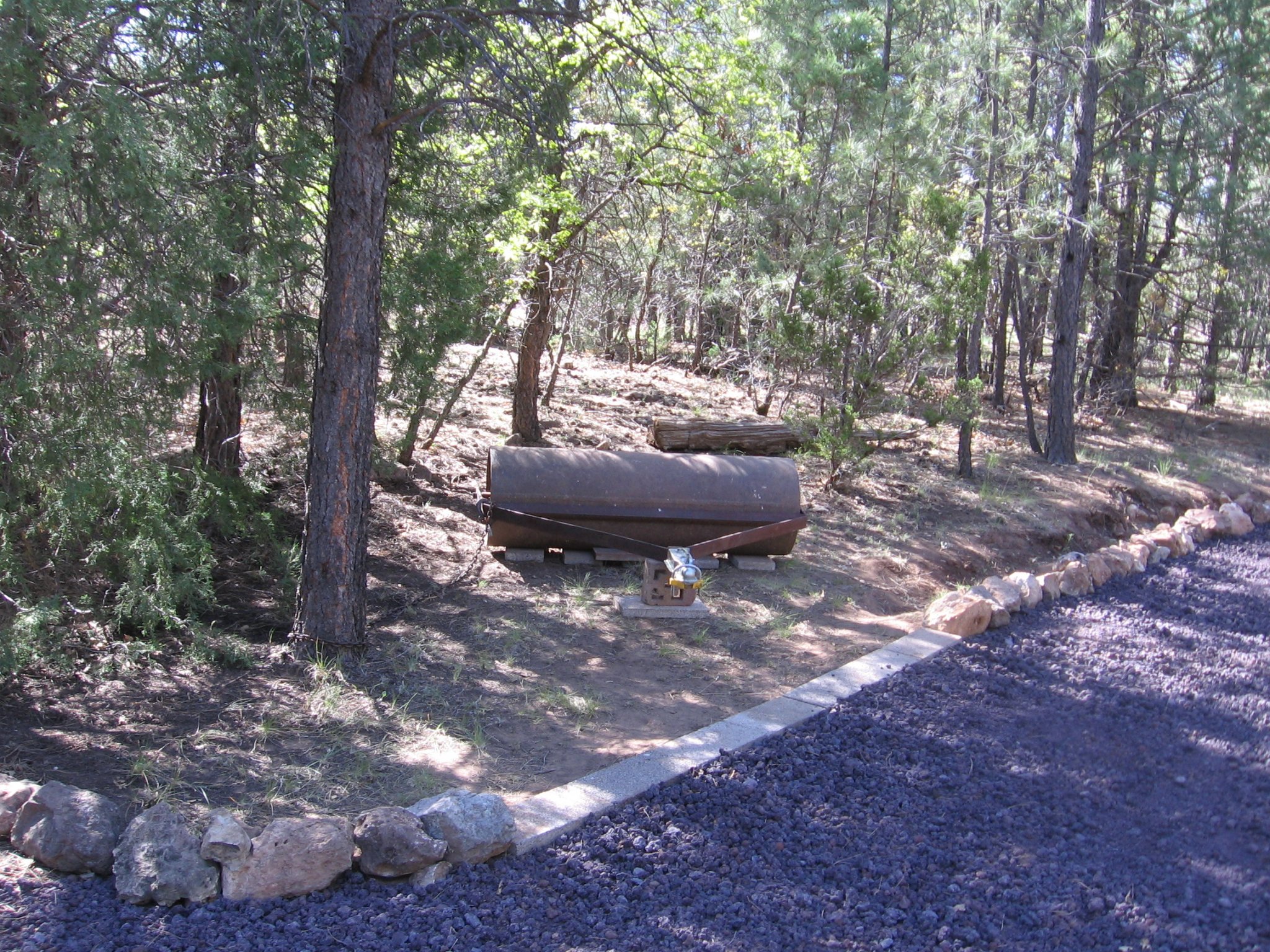

Saw this thread and then realized I didn't have a decent pic of my roller/compactor. It's ancient, the guy I bought it from was in his 40s and he said it belonged to his grandfather. He was asking $100, talked him down to $80, then while loading it, I got stung twice by bees that were P.O.ed by his son shooting at the hives with a BB gun. He lowered the price to $65. 60" wide, 920lbs, full of antifreeze.
I added the 2" coupler later.

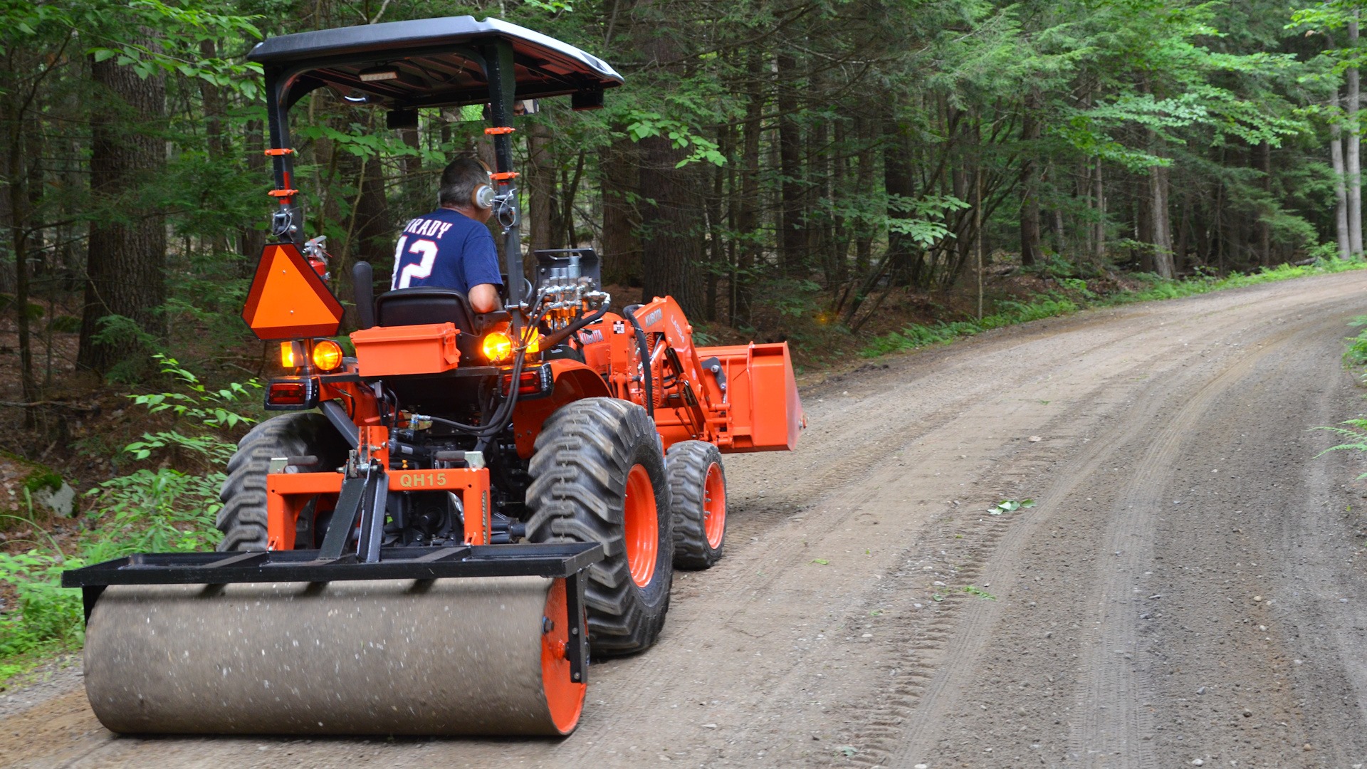

I have a buddy with an elevator company that hooked me up with a 60" piece of 1/2"x20" steel that I used to make a roller. It weighs just over 1300lbs. (full) and works very well. I use it primarily to set a road after boxing/raking and to roll out lawns.
