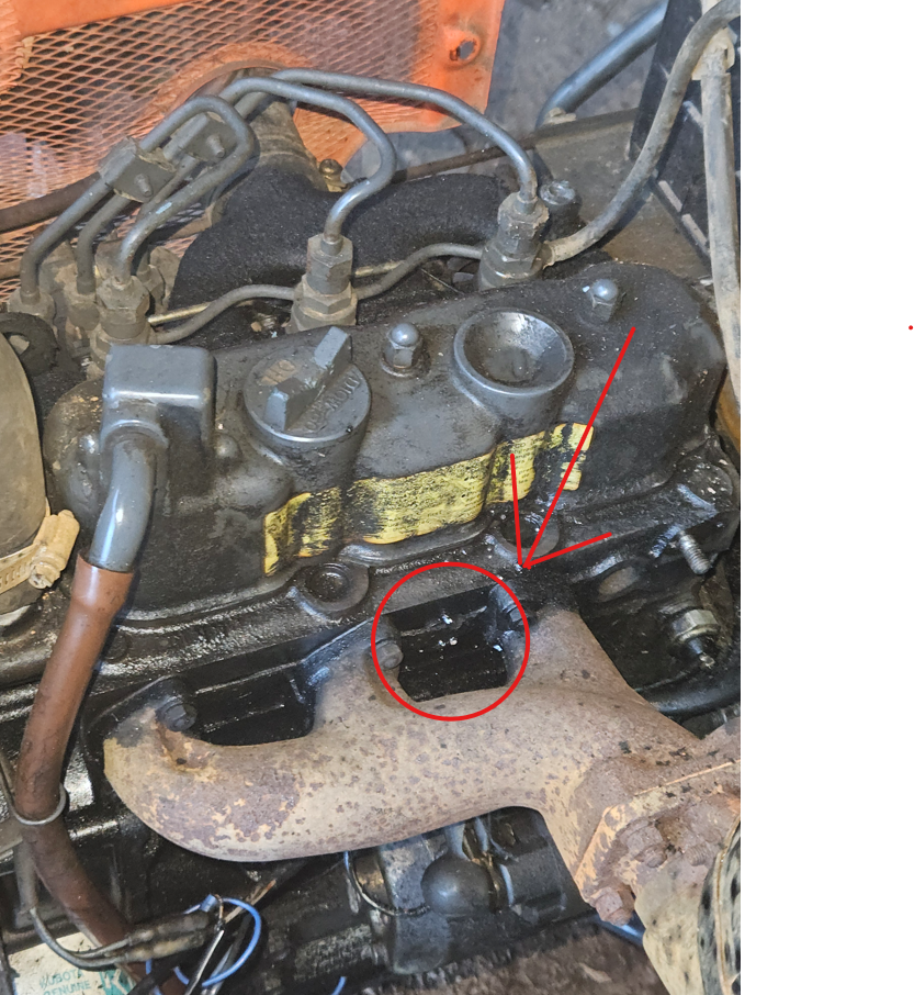

While that crack has been dealt with (even if just for the moment) I'm not out of the woods yet. Found at least one more maybe-serious spot.
Here's a backed away picture to place the spot:

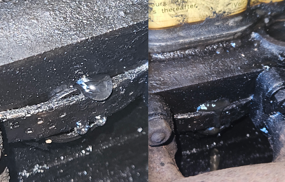

Here's a couple pictures of the same spot zoomed in on it:
Looks like this isn't held in flush and it should be?

That is a frost/freeze plug pushed out.
Since your initial crack was just in the head, and not in the block, and you've found this plug pushed out, I would tap the plug back in and do a pressure test on the cooling system. Look for other external coolant leaks and maybe even drain the oil and leave the drain plug out while doing the pressure test to check for any internal coolant leaks. As NIW has said, the cylinder head would be the cheapest fix if that is all that is wrong.
