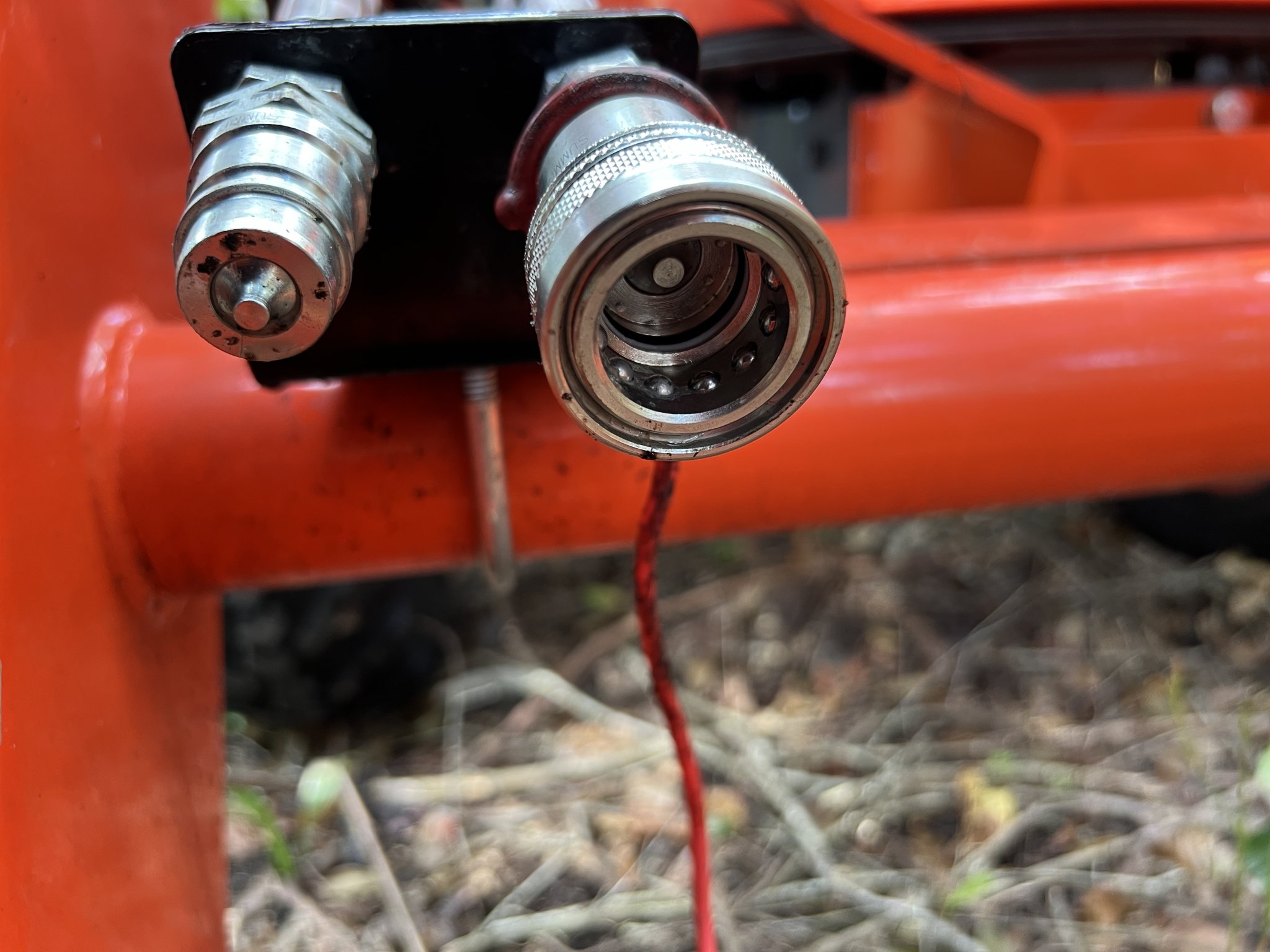

Can someone tell me what kind of couplers I have on my tractor?
The 3rd f(x) is Summit hydraulics.

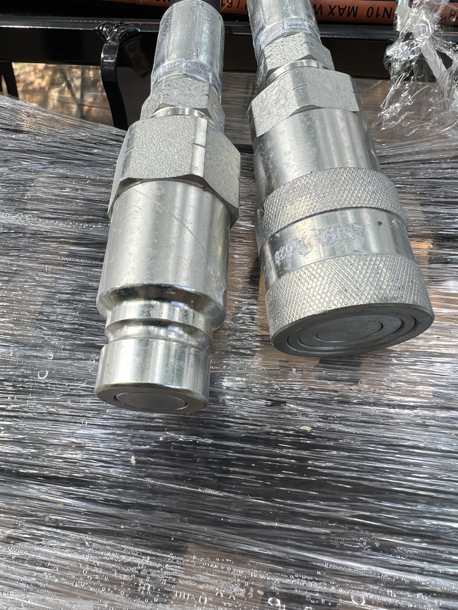

The Homestead implements grapple I must have selected flat face.

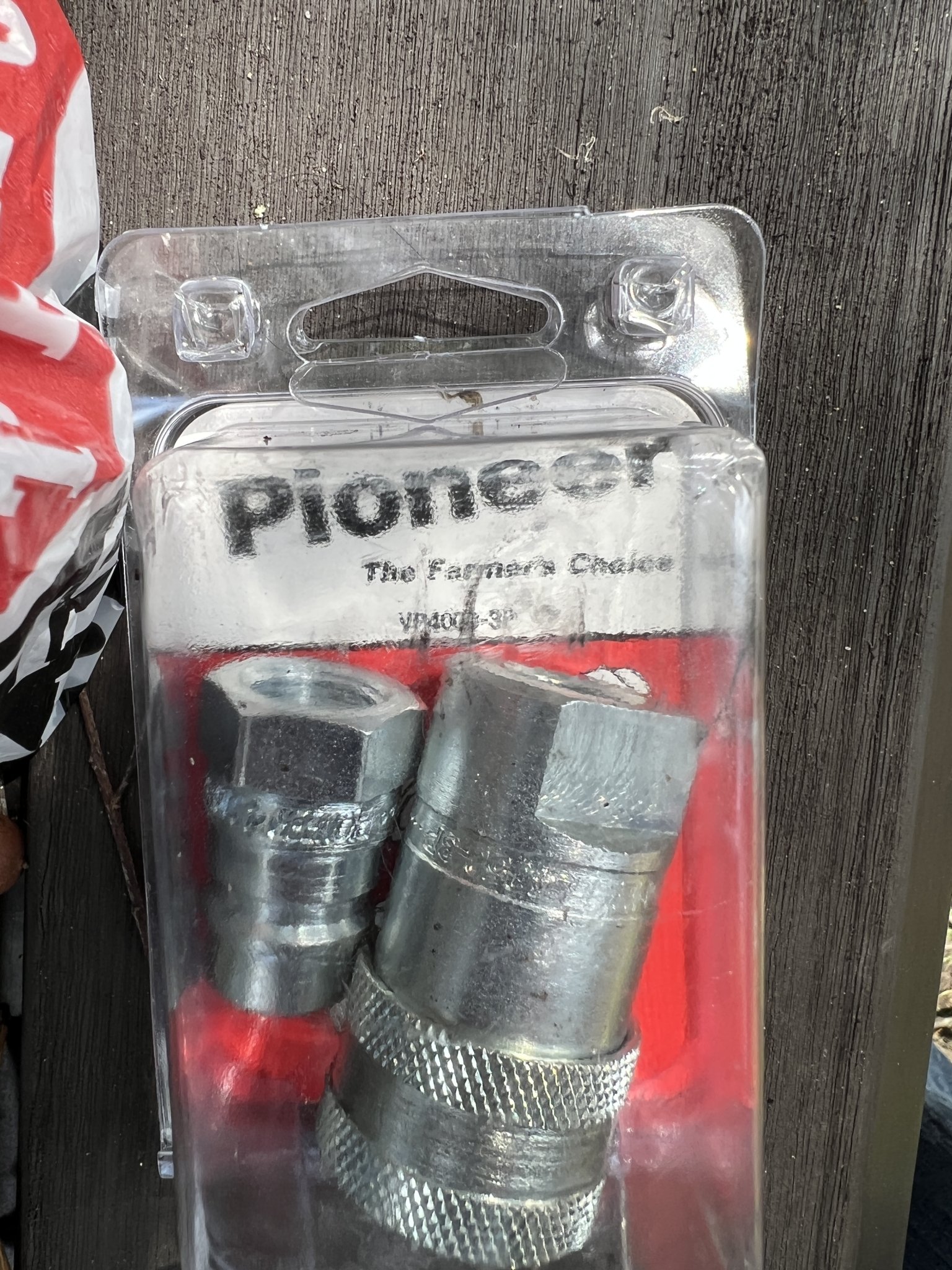

I went to TsC and picked up these Pioneer couplers but they will not attach to the 3rd function.
This is on the tractor
This is the grapple
This is the box I bought to replace the grapple flat faces

Couplers have to match flat face males to flat-faced females. Same with the Pioneer couplers. Just swap them so there is both a male and female on one hose pair and do the same for the other hose and everything will work. If you want all flat-faced couplers, then go to Amazon and buy the Summit brand of flat-faced couplers or buy additional Pioneer couplers at tractor supply.
This is the grapple View attachment 88835 View attachment 88836

  • The Summit web page says the L01 3rd function kits come with 1/2" body Ag couplers. Your picture shows poppet valve couplers
  • The packege on your TSC couplers appears to say VP4000-3P which would be 3/8" body Ag couplers with poppet valve.
  • A 3/8" coupler will not mate with a 1/2" coupler-
  • You need 1/2" body poppet valve AG couplers and the Pioneer number for that is VP4000-4P. They will have a 1/2" NPT thread which may not match the ends on your hoses.

Lioks luke youe hoses have JIC swivel ends. Remove the adapters from the flat face couplers. My guess is they are oring fittings at the coupler. Measure the dianeter of the threads on the the adapter and order couplers that match the adapters.
