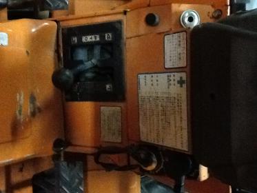

How do I stop the PTO shaft from 'revolving' once I remove the slasher. I have attached 2 photos. You can see there are 4 gears with the PTO. I would have thought that having the selector in the middle, neutral, position would disengage it. I also see that in the manual there is a lever called a Restrictor' for the PTO, which is next to the gear selector. My tractor does not seem to have one although above the horn there is a small bit of chrome which seems to be missing a switch from the middle of it. I have no idea what that is??

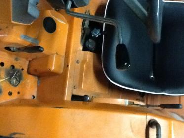

I have also attached a pic of the levers to the left side of my seat. There is the Hi-Lo, the 4WD selector and then what I think is the Mid PTO lever, which I believe I really won't need. I have even tried running this in neutral but it does nothing. The only time the shaft stops revolving is when I hold the clutch in?

It's prolly just oil drag, that is keeping it moving. To test, Start and rev up, take a scrap piece of wood and hold against the shaft, should stop immediately, without much pressure. I stop mine, by hand, all the time, when connecting an implement...:D:D

Nope. No good Dave. I can slow it but then it just speeds up again. I have everything in neutral so I don't understand.
Pop the shifter tower, and top off the PTO gear case, and take a look at the shifter rails, and gears below. Could have something shifted in the gear train, and just barely making contact...:D:D

I'm not in the least mechanically minded but I'm assuming by shifter tower you mean where the lever is directly under the steering wheel . With the 4 gears to choose from.

Guys is there anyone on here that has a similar PTO lever/speed system (pictured) that I do? As you can see by the pic there is no restricting lever above.
If someone els s tractor has a similar system I would love to get a copy of the relevant operators manual as there is not one for my L1-22DT. The manuals I have only seem to have to he two lever options, with a Restrictor lever.
I not only want to find out more about this system but it may explain why the PTO shaft continues to rotate even after the mover is disengaged.
Yep, that's the beastie. It is possible that if you have a lot of wear on the stick, that it can jump the gate. I have a similar setup on the L2202, but have always been able to stop the rotation either by hand, at idle, or just by putting the shaft I am trying to connect against the turning PTO, and holding on...:D:D

Mine spins when nothing is hooked to it as well. But like Dave, it's just a slow spin that I can stop by hand. Usually stops spinning after running for a while and the oil has warmed up.
Dave are you saying your PTO setup on the L2202 is the same? The four speeds to select from? If so would you know where I can download a workshop manual. Mainly the PTO section.
If you can slow it down by applying force against the PTO shaft - than it's not a mechanical connection issue that's causing the problem - it has to be "gear drag" as mentioned earlier. There is no need to pull cover.
You could try a different oil (i.e. lighter viscosity or multi-weight) to reduce drag if this is an issue you want to correct
PS. Please don't try to grab any rotating object. I don't object to pushing a board up against the rotating shaft (even that can be dangerous), but don't grab the shaft. With gloves, a metal bur/splinter on the shaft could grab a glove and twist your arm.
