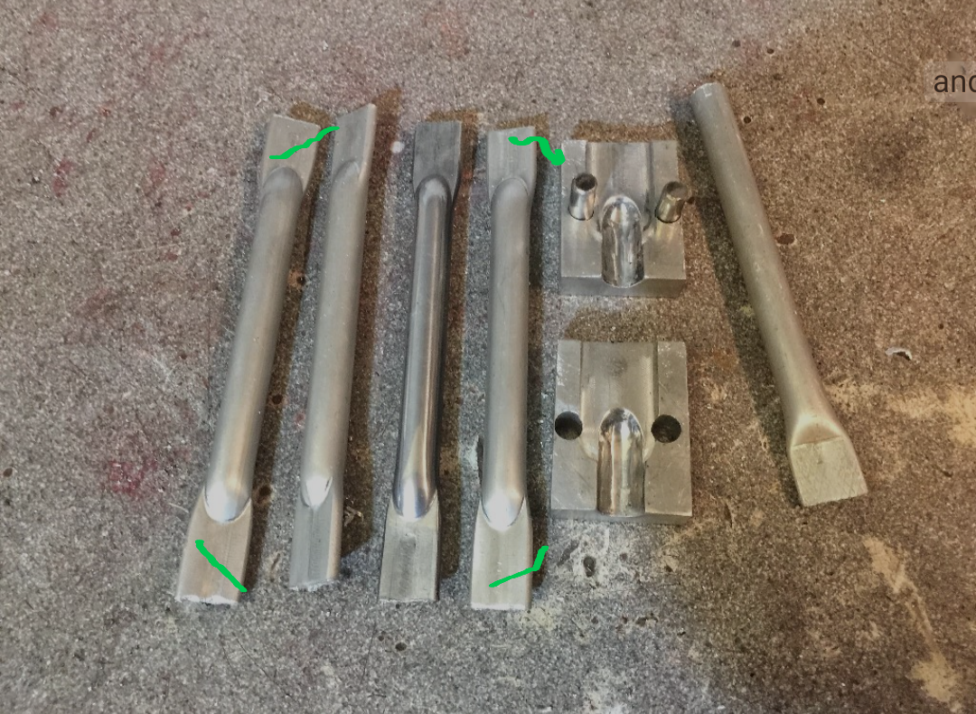

Welding those clips to the pipe should be straightforward, but you seem to have a lot of experience with coping so go for it.
There is another possibility, you could flatten the ends of the web members, cut them to length and angle, then weld each side to the chord. The fancy way of doing this requires a die, though.
The connection method you choose should be considered by the truss designer.
There's no practical way to flatten the ends of the pipe that I'm using (1/4" wall) but I like the way that you're thinking. I'm going to be coping the joints so the only thing to resolve now is how I can efficiently and effectively mark the ends of a bunch of pipes with different angles.
I've made and used heavy paper wraparounds, but for the quantity you're looking at I like @Russell King's plastic templates, especially since you have a printer.

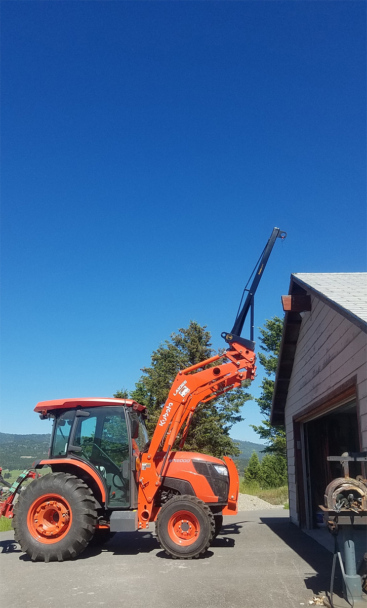

A 30ft 6:12 truss made entirely from 2" pipe with a .154" wall is around 450lb. I went over my calculations in my notebook and realized that my original plan was to build a 30ft x 60ft barn so that's most likely what I'll do given the location and such.
I bought a CAI 84" boom pole a few years ago that's rated at 1,800lb and it'll be interesting to calculate whether or not the M6060 in "power" setting can safely raise a 30ft truss so that the bottom cord is 16ft off the ground. Obviously the tractor would need sufficient counter weight on the 3-point, and the ground would need to be level to reduce the chances of tipping the tractor over.
Here's the boom pole on the MX6000 which is a fair bit smaller than the M6060. I think it's about 16ft to 17ft to the apex of the roof of the garage.
