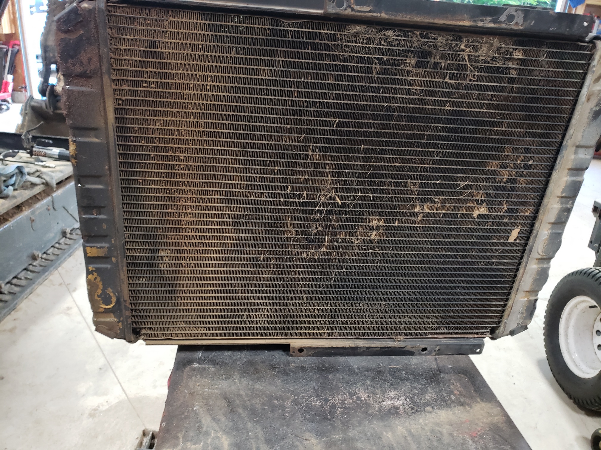

Got stuff taken apart, excavators suck to work on.
Coolant looks good, thermostat looks good but im replacing anyway. Belt to water pump. looks glazed. Water pump not weeping, no play in bearing and very slight resistance when turning it by hand.
The radiator is plugged externally. I soaked it in purple power and flushed the fins for an hour. got most of the crud.
Before pics: This is the intake side of radiator
Look how caked up inside. Could barely see light through it

UPDATE on this.
I flushed the radiator externally 2 times soaking first in purple power cleaner then flushing with the hose then blowing out with the air. Did this twice i got about 95% of the crud. And i straigtned some fins that where flattened over.
I replaced the thermostat, WP pulley belt, 2 gallons coolant and new 13psi cap.
Runs nice and cool now. Its about 85 degrees outside and i just worked it for an hour and half pretty hard and stayed well into the green zone never even coming close to yellow zone on temp gauge. Im guessing the only real problem was the radiator fins where plugged and only allowing a little bit of air to pass through.
Im guessing my hydro oil will stay cooler now too as the plugged radiator must have blocked airflow to the oil cooler as well.

I was really surprised how plugged the radiator was. Bet you were too.
Remember the 185 upper and 170 lower temperatures? For giggles sometime check again….bet the difference will be surprising.
Glad you got it.
Job well done! 👍
