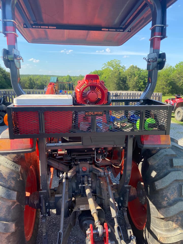

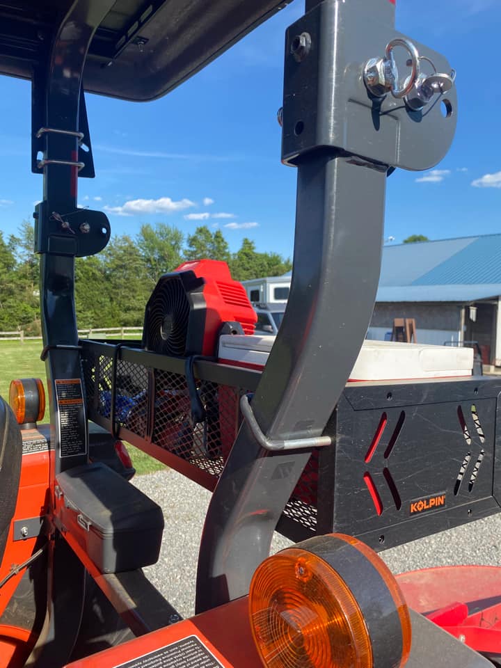

I attached an ATV rack on my ROPS with rectangular u bolts. It will carry a lot more than a small cooler.

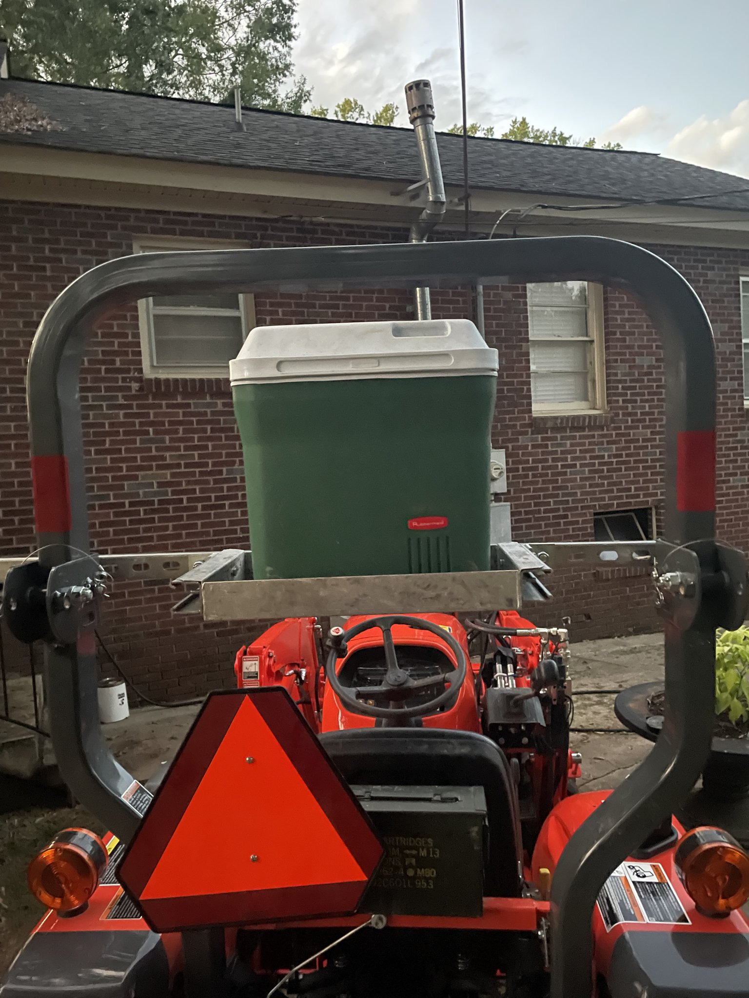

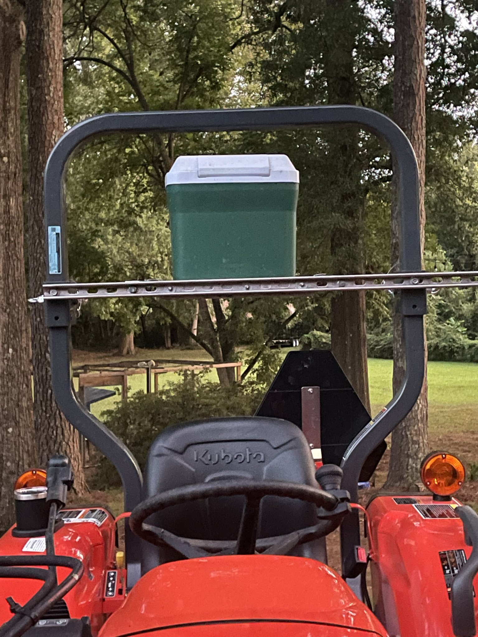

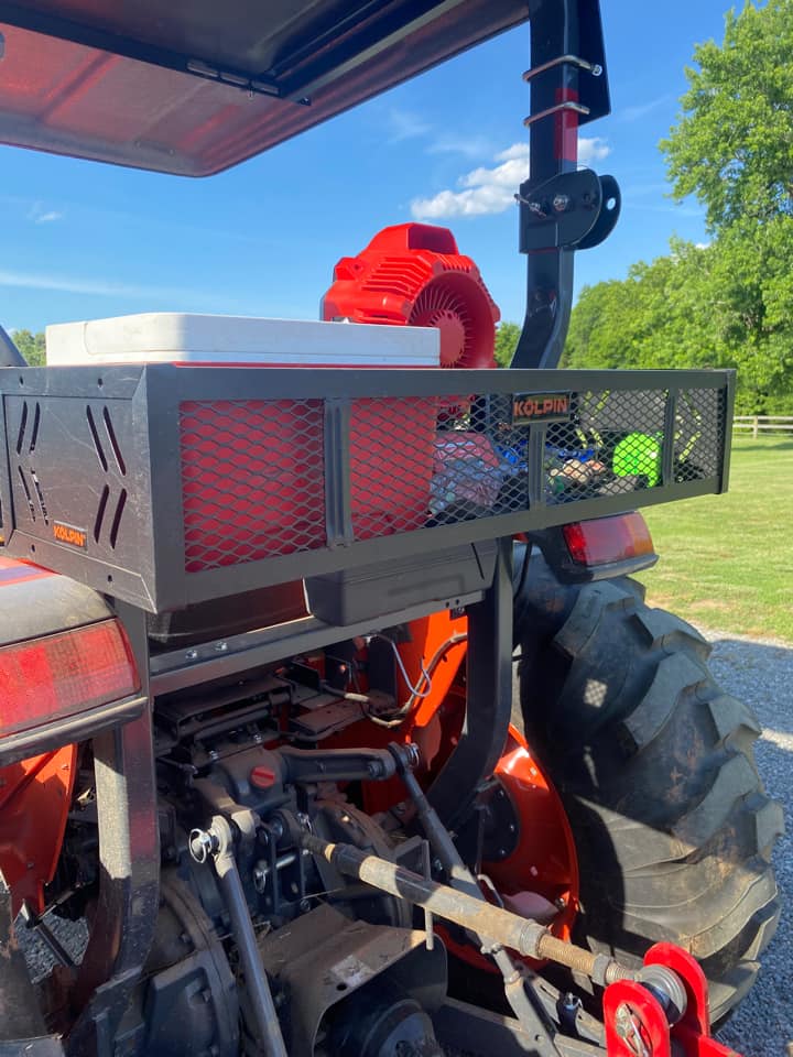

Ended up finding some scrap electrical strut laying around the house and an old SS toolbox tray from my old truck. A couple 90 degree fittings and bolts and came up with this. It mounts using the ROPS bolts and can be removed with just 2 bolts. Just have to cut the one piece down to the correct length.
