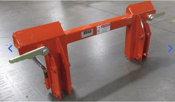

Thanks for the reply. I looked through the ATI web site and did not see the ssqa listing for my La364 loader. Do you have a part number for this conversion?

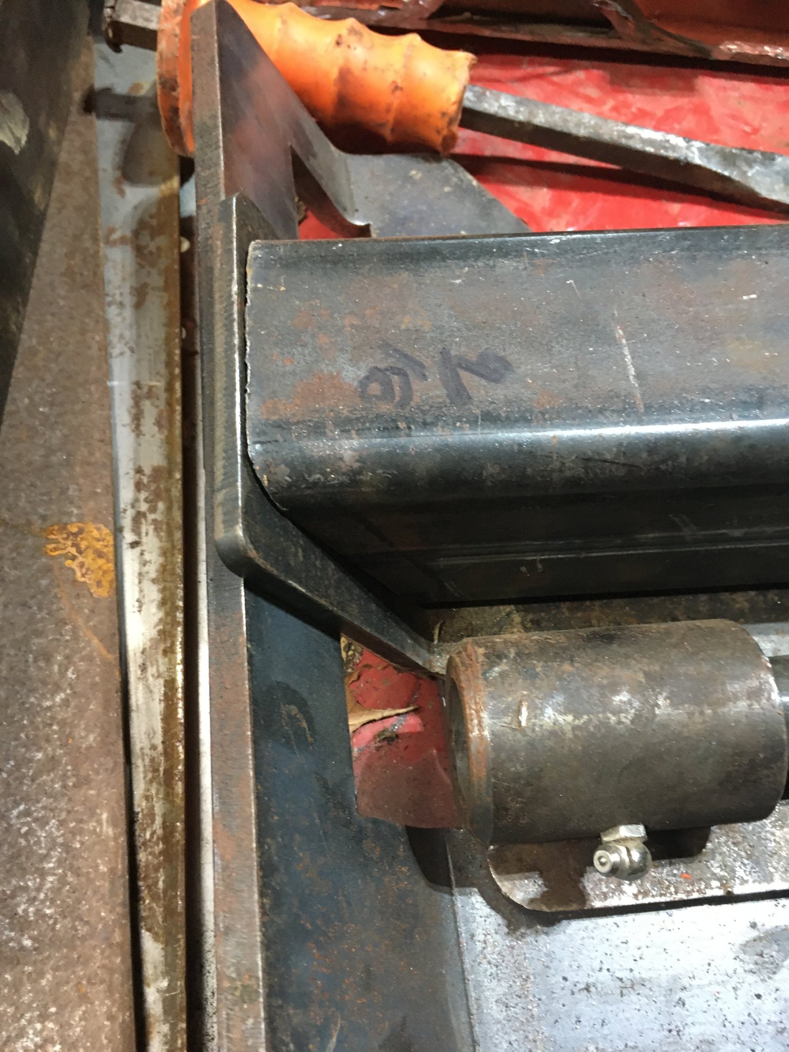

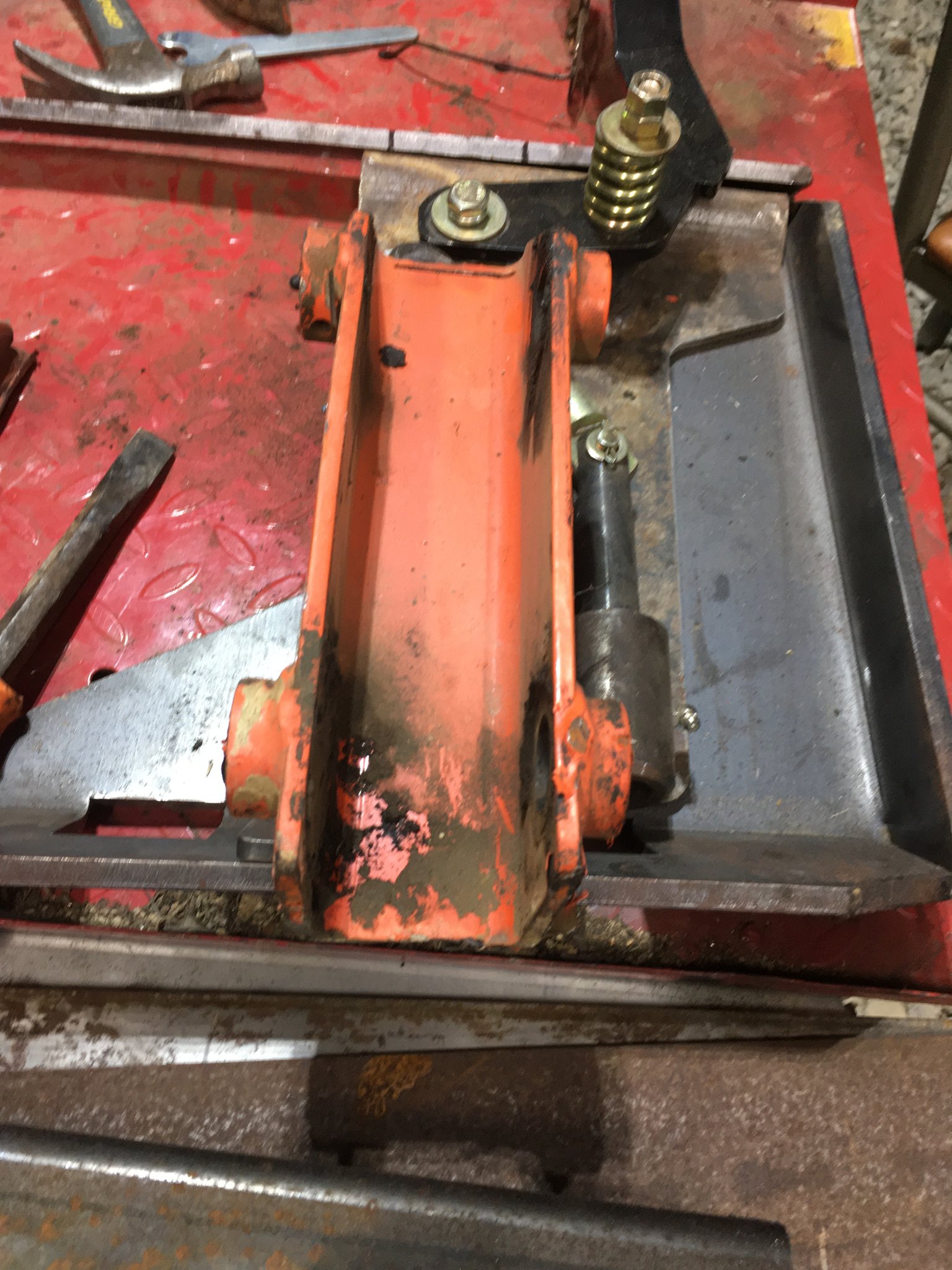

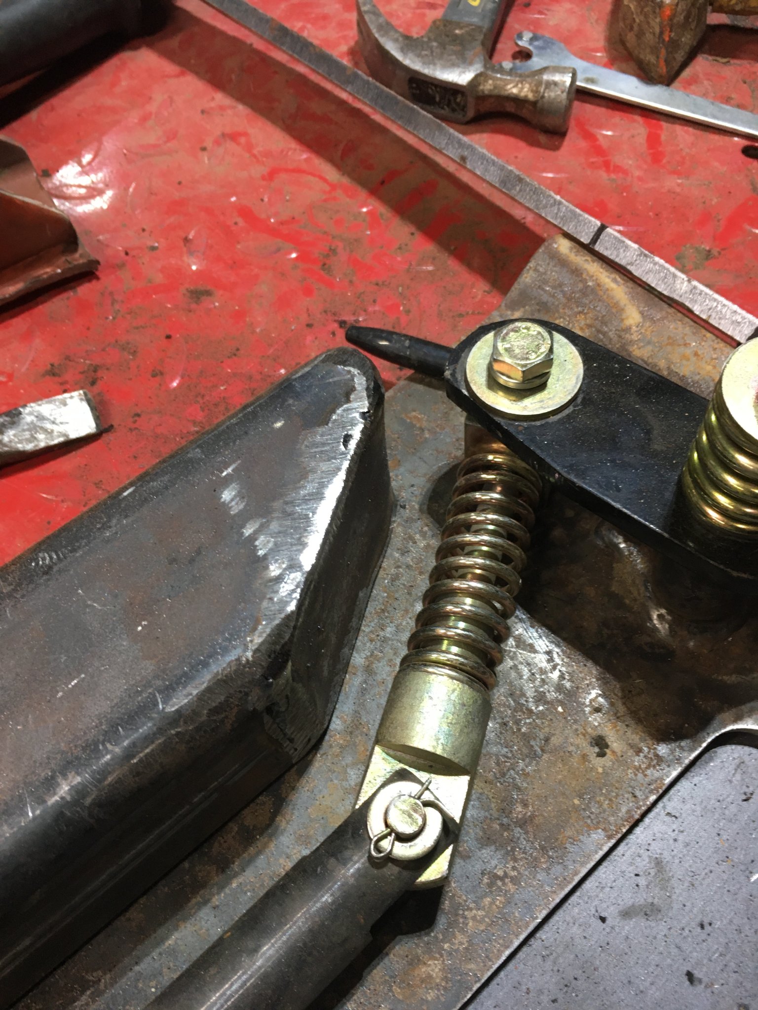

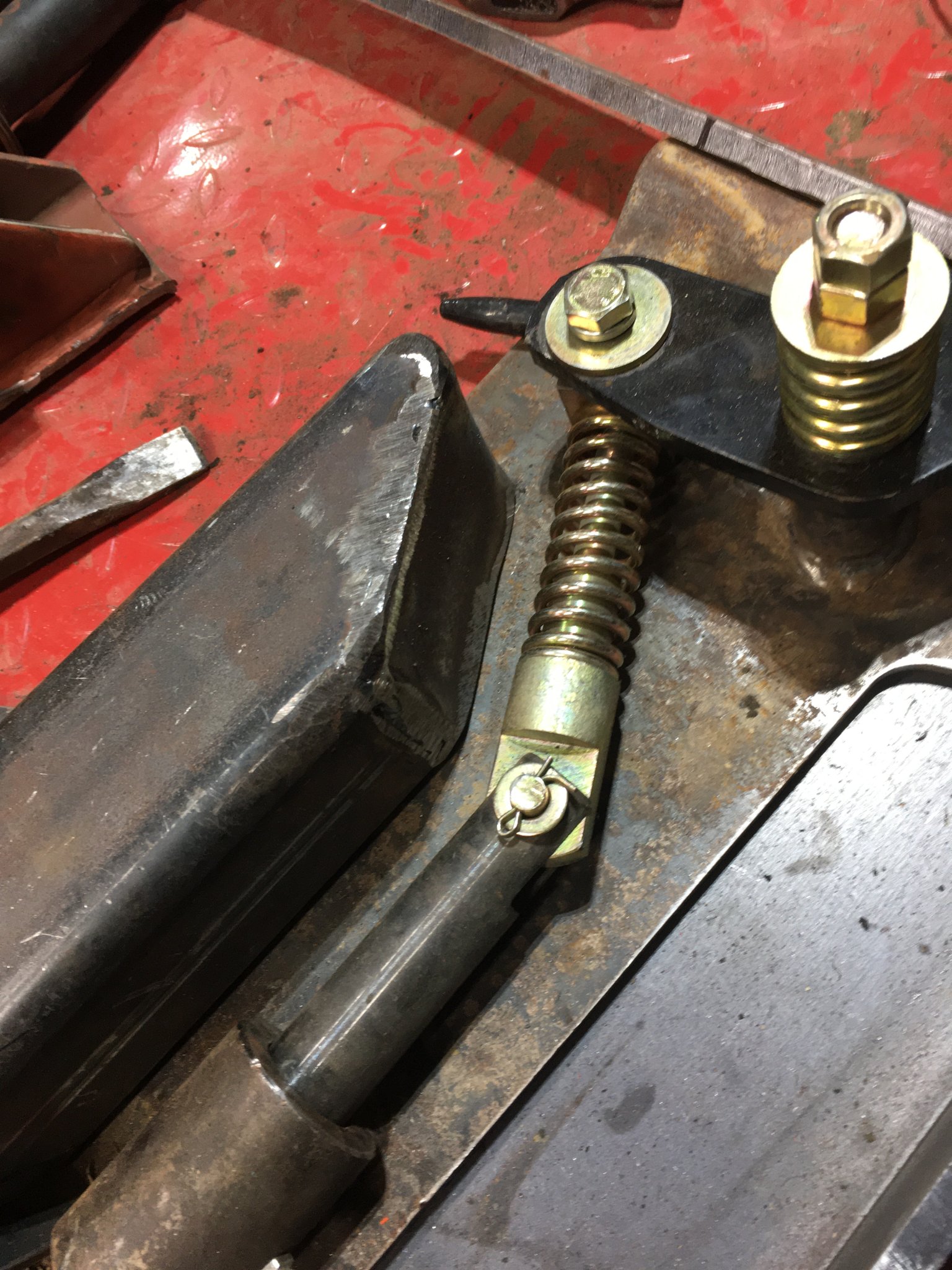

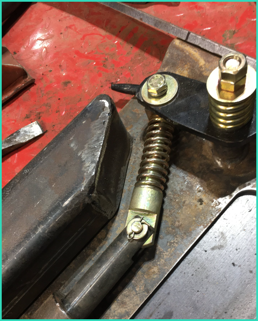

progress so far:
