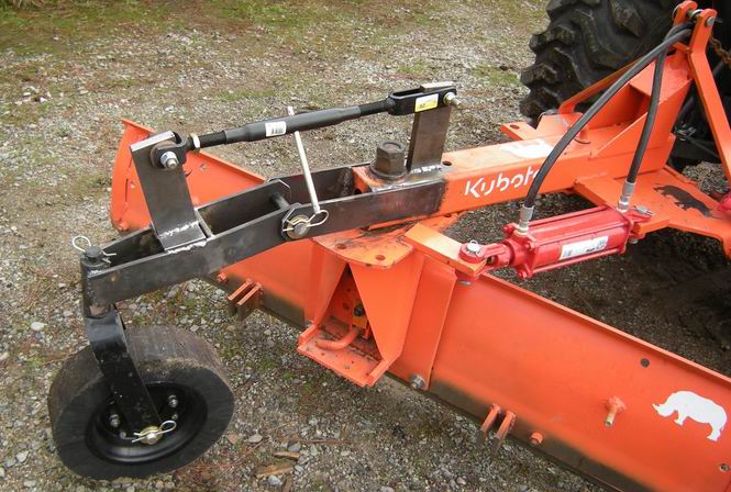

I bought a RHINO rear blade 30+ years ago for driveways & ditching , and cannot say enough good about it. The blade tilts and pivots, and the arm swings for offsets. The RHINO is very heavy duty, with about a 3/8" moldboard. I cannot say enough good for its being heavy duty - after 30 some years it is still going strong and straight. It has been GREAT for the driveway, and TERRIFIC for snow! With offset and tilt keeping the ditches clean is a walk in the park. Last year I built a rear wheel for it (an option with many of the currently available blades), and now it acts like a road grader and is awesome. It also allows me to keep the blade just above the gravel for snow removal. I don't know about box scrapers, but sure like what I have!
