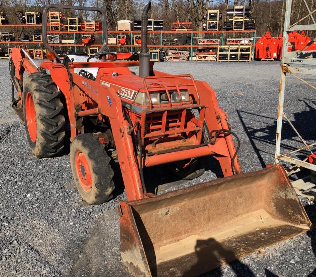

How good an idea is buying this L3250 with LA650 loader and Woods Groundbreaker 6500 three point PTO backhoe? The meter says 1555 hours. The front ag tires are so worn the lugs are no longer present on the centerline. The rear tires look replaced and still have some mold flashing. Would we guess the hour meter is on its first time around, or second or more? It’s got just a little rust on spots that got stressed and paint worn off around where one’s feet go. Both tractor and backhoe seats are shot. The fuel cap is missing, with baggies and rubber bands instead. It’s at a Kubota dealer in Delaware, who’s asking $9000 for it and says that other than needing a new seat, and having a little oil seepage that does not require fixing, everything checks out on it. I’m contemplating offering the asking price if they’ll add a new seat and new front tires, and working from there. I don’t need financing.
I’m not certain what is standard on an L3250 and there are NONE listed at TractorHouse.com. This one has 4WD, high/low range shifter near the fender, a forward-reverse column shifter to the left, a 4 speed column shifter to the right, and a ROPS. From what I can make out, the L3250 is a sturdy model built from ’89 to ‘91
Am I right to believe these are “shuttle shift”? Do these require clutching when shifting? Seems like the Internet has as many different explanations of how shifters operate as the dealer has tractors. Also, there’s a control I don’t understand, a big knob on a stout shaft that points rearward, coming through a vertical slot below the steering column, at about the same height as the pedals. It’s close to where the brake pedal latch is on my B6200 which also moves vertically, but this knob looks pretty serious for a brake pedal latch. The 2WD/4WD shifter, PTO shifter, and differential lock pedal are all accounted for. Anyone know what it is?

Looks pretty clapped out to me. 1550 on the meter, no way. Probably disconnected for years or not operating (did you see if it was)?
I run bar tread tires on my M's and do a lot of pavement running between fields and I have 2500 plus hours on both tractors and my front tires are maybe half worn down. Maybe.
I'd say it has over 5000 hard hours on it.
9? no way, maybe 5. 9 for a sucker IMO.

Your comment here, "Both tractor and backhoe seats are shot. The fuel cap is missing, with baggies and rubber bands instead. It’s at a Kubota dealer in Delaware, who’s asking $9000 for it..." tells me I'm not interested.
If the previous owner didn't care to keep the fuel clean i'm not guessing what else he didn't do! That thing has been rode hard and put away wet!! I'm guessing you buy it, and you'll spend a good part of the 10-20 years you need it with it needing repairs to be able to use it. Move on....
I bought an L3250 two years ago that could be that one's sister. Front tires looked just like those, machine beat to crap. It ran. Was used in a horse breeding farm in Okla. Used every day to haul off processed hay. I sold it to a scrap yard for $1200 when I discovered the slight tapping noise was not an injector, but a spun bearing on the crank.

I looked on Cl in MD. Not many choices as compared to here. I'd expand my search field towards the West. Might take a little more time, but I believe you can come up with a much better tractor at a good price, and that would include hiring someone to move it to you for 9K!
