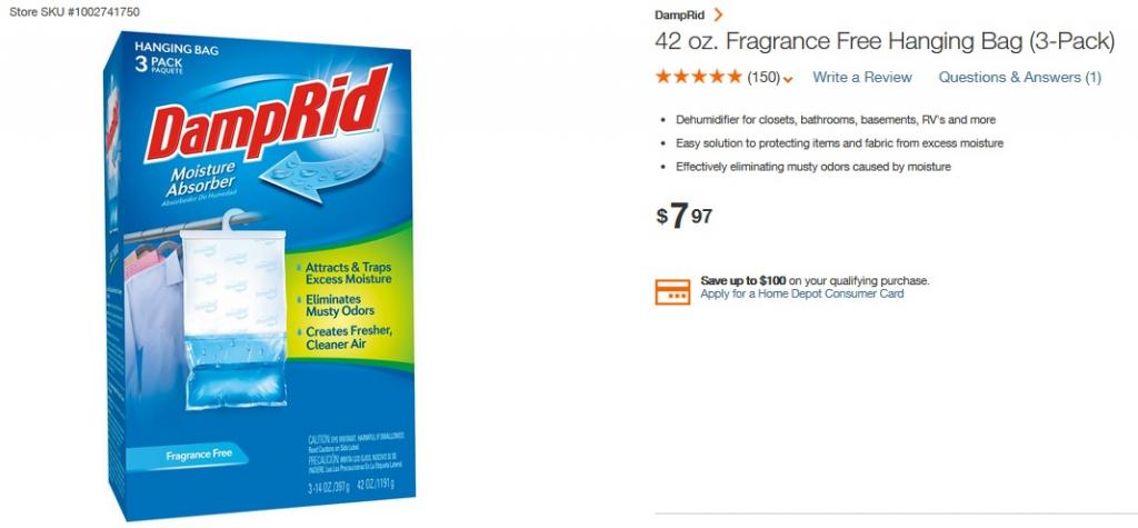

The most effective way to remove moisture is using Silica Gel pacs.
A dehumidifier will only dry air down to the dew point of the air temp / Relative humidity level.
A desicant, the small pacs found in most electronic stuff, dries air to next to zero moisture.
Amazon sells them.
https://www.amazon.com/s?k=silica+g...prefix=silica+gel,aps,178&ref=nb_sb_ss_i_3_10
Home Depot sells them for people traveling in southern climates where clothes in suitcases end up smelling musty. Product name is Damp Rid.
https://www.homedepot.com/p/DampRid-42-oz-Fragrance-Free-Hanging-Bag-3-Pack-FG83FF/302991964
Make a bag out of Aluminum foil. It transmits zero moisture thru its structure unlike plastic zip lock bags. Enclose the display inside the bag with many gel pacs. They will draw the moisture out of the display but you need patience. Creating a couple of holes in the back of the display will help.
Likely far better method to dry out cel phones than the rice method.
Dave
