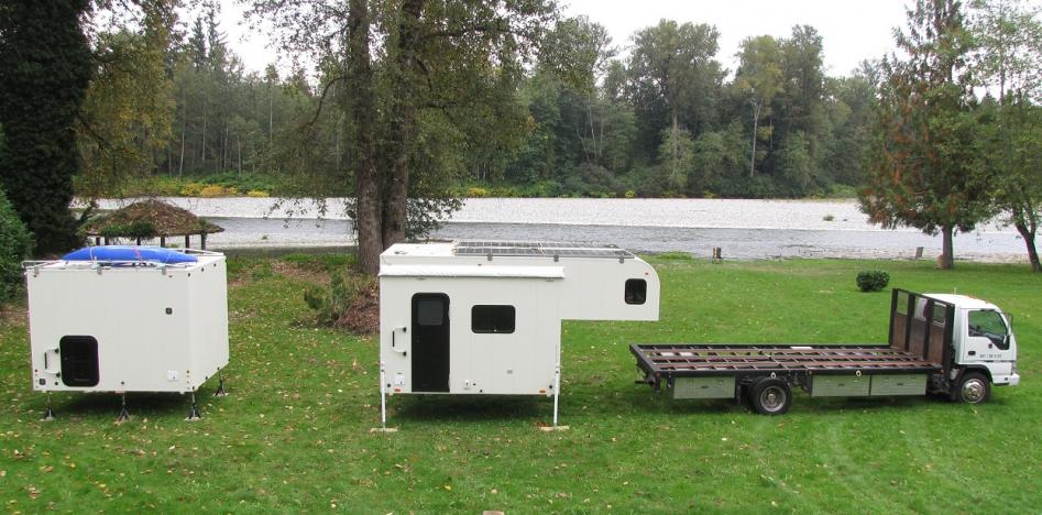

Nice excavator and truck Jfet. How do you get the camper on and off? Does it have legs?
When we welded up the steel frame for the camper we put in three tubes welded on each corner. We then made a 3 prong bracket attached to a truck jack which slides into the tubes at each corner. We store the 4 jacks under the truck in one of the 4 foot long aluminum boxes.

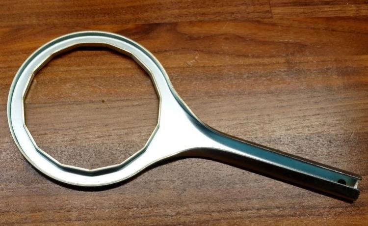

Can you please post a picture of the Filter wrench that came with your hoe? I would like to email to the former owner of mine to see if she has it. Would really appreciate it.
That a really nice setup Jfet. Thanks for showing.
