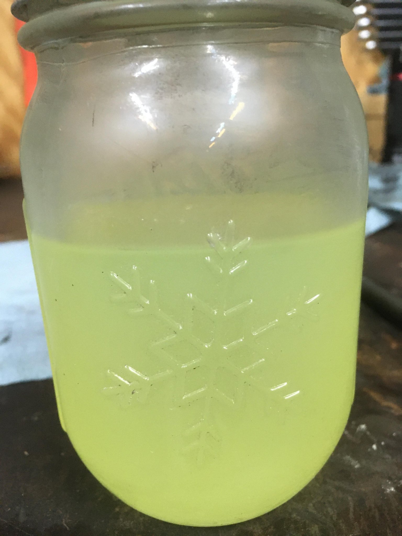

Pic is from last year. Normal road fuel from the pump. I believe it was Shell or BP. We got a bitter cold snap for a week or so and the lows were in the single digits to negative single digits. That was rather unusual for the area. The fuel is treated for your region averages but not the random severe temps.
I set this jar out overnight and took the photo in the morning. Granted, a full tank in the truck would not have lost as much heat as 8 Oz in the jar. But the lines, filters and such would. I use an additive at every fill up. Those that don't had some issues for a couple days.
