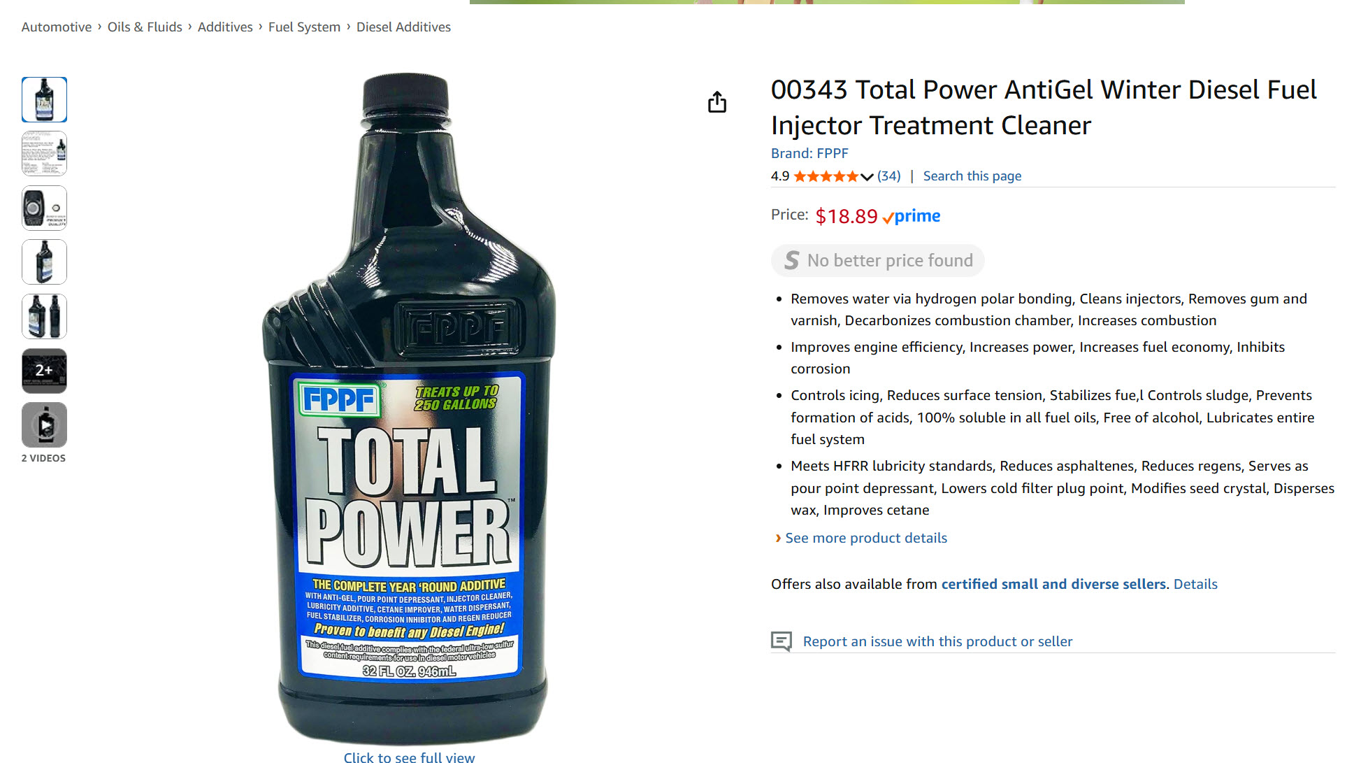

I use the FPPF Total Power Fuel Treatment all year long, works good as an anti-gel.
The product photo you posted shows product number 00343, I found this on Amazon, but it says it's for winter use?
