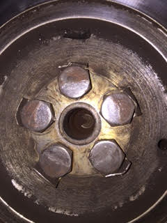

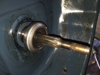

Here are my questions:
1. Does it look like my throwout bearing is in correctly?
2. Does the clutch need to be replaced? I dont have a measuring tool.
3. How do I get to the pilot bearing. Does the flywheel need to be pulled? If so, how do I loosen those bolts? The flywheel just moves with the wrench.

Looks like you have the throw out bearing on backwards!
The part the spins looks like it's facing the rear.
Clutch disk looks useable, by the pic about 1/2 life (guess).
No you don't need to remove the flywheel, it will come out with it on.
Get the new pilot bearing and you'll see it's pretty small.

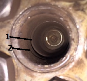

Sorry to keep posting questions, but I can't find my pilot bearing. I think it might be so worn down that I cannot find it. If you look at my picture, you can see the first line where it looks like it worn down. Is it #1 or #2 where it indicates the end of the pilot bearing? Or is it even there?
What is the best way to remove that? Should I use a hacksaw blade to cut the rest of it out?

Ok. Looking at the picture above, the line 2 is from the shaft that goes into hole. The shaft has a line on it in the same spot. So the line 1 is where the pilot bushing is supposed to stop.
My question is this. Is the pilot bearing/bushing even there? I don't see any sign of it. I probed around for the hole that is supposed to be part of the pilot bearing and there is none. That makes me think it is worn down completely. I ordered one online anyway.
