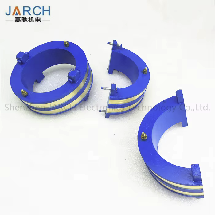

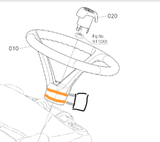

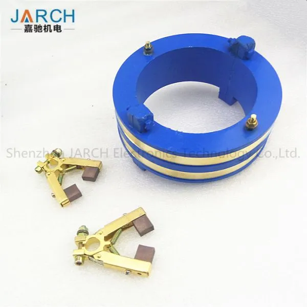

I would not see that as so pessimistic. Two copper rings attached over the hub of the wheel and a brush holder from an alternator would do the trick with very little effort.
I didn't look into this too much in depth but something like this would work.
It's a 2-piece, 2-circuit slip ring that could be clamped onto the base of the steering wheel itself. Two circuits- one for +12VDC and one for 0VDC. No idea if the size is correct though. If this was something I wanted to do, I'd dig further into this. Some 3D printed protective guarding would need to be made.

curious, I googled 'hollow slip ring 5amp' and came up with LOTS of them !
It's all in the 'details'... aka what diameter the shaft is and height... for sure someone does make something that'd work..

Option B:
Get something like this:
Cut the ends off and wire it in.
