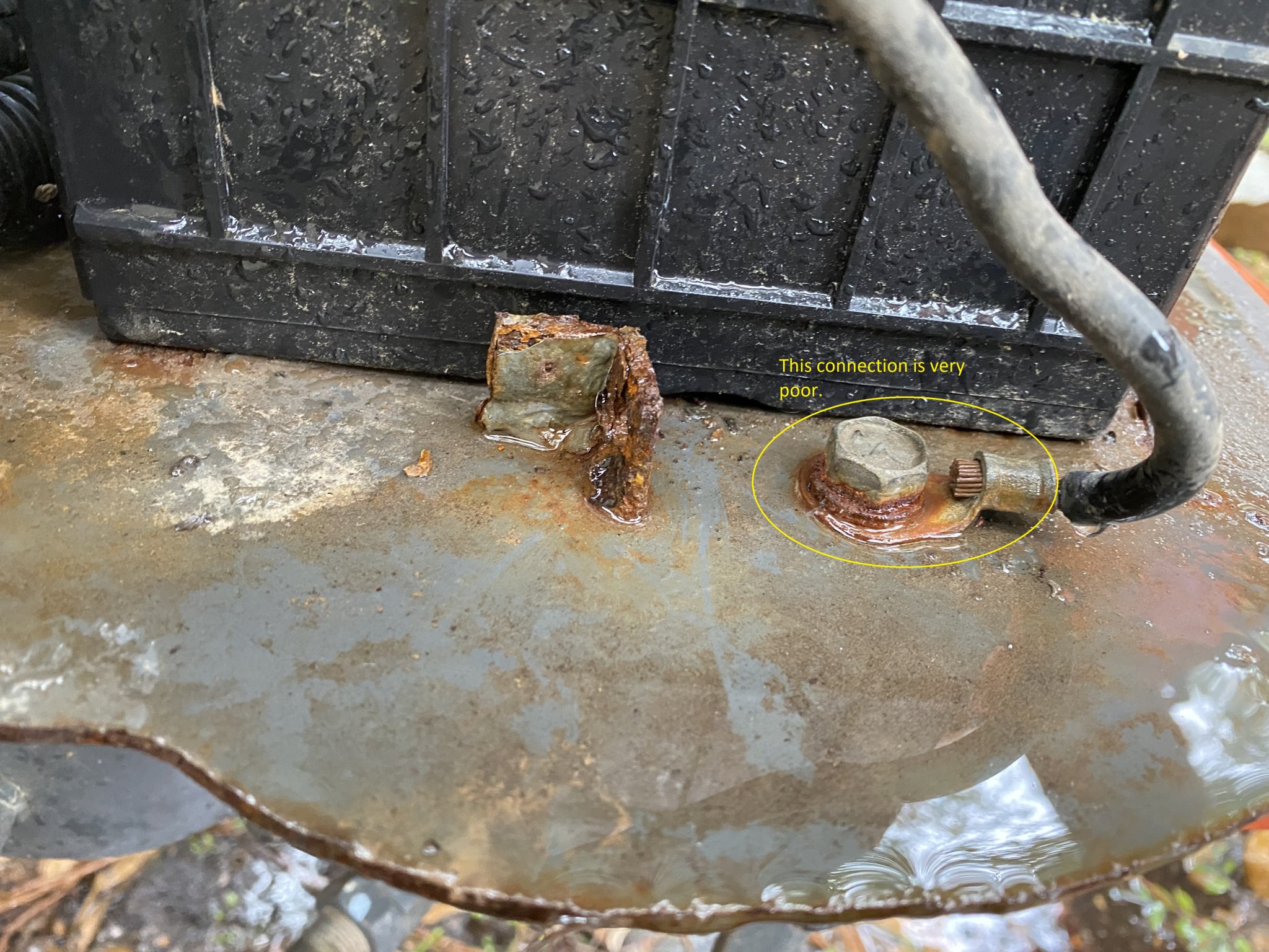

My L3301F clicks when I turn the key but it won’t turn the starter to start the tractor. Have checked seat sensor switch and others, etc. New battery too. I suspect problem is with solenoid but how do I test? Also have been reading about after market Starter Relay Kit as a solution.
Please post photos of the top of your battery and where the ground cable connects to the tractor frame.
Many problems like you describe can be visually diagnosed with this info.
Follow Wolfman's advice but in the meantime post the photos.
Since, as a new member you cannot post photos, I will send you a private message containing my email.
Send the photos to me.
Look for the envelope symbol at the top right of most pages.

I looked over the photos you emailed me and your connections are in terrible condition and could well explain why you cannot get her started.
This is a critical one;
Every single battery cable joint needs to be opened, heavily wire brushed, corroded bolts replaced, frame touched with an angle grinder to get to shiny bare metal. There is a couple of hours of work. Then your tractor will start like new.
If you are not used to doing this ask a friend or neighbor, call a mobile mechanic. The costs will justbe labor and few parts.
Dave
12,954
5,682
Don't waste your time trying to clean that cable, buy a new one. What you don't see is the corrosion eating from the inside out in that cable. The end of the cable is exposed to water, water wicks into the core, corrosion starts, and never stops.....
I've seen it wick over 120' (yes feet ) in a communications cable I used 3 decade ago.
