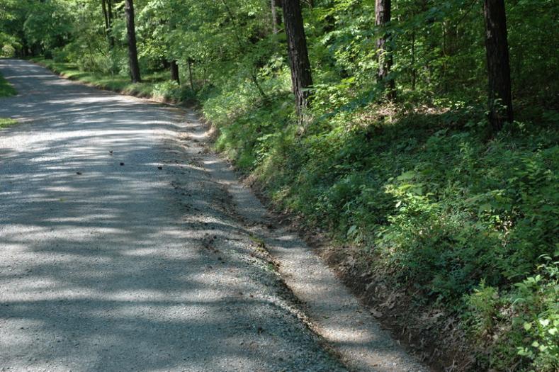

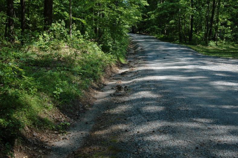

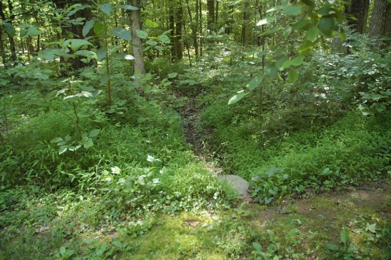

Ok... some pictures.....
Views of the ditch that needs to be excavated. The Drain pipe and the other side of the pipe that needs to be cleared some.

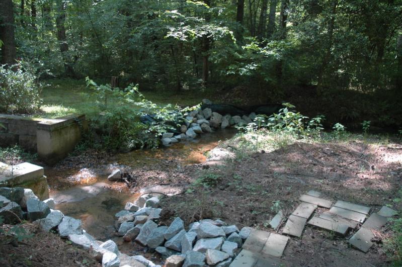

A while back, I was talking about moving rock with the BX and how easy it was. This was 4 tons. I need 4 more. I get it free from a neighbor so I have to be patient. But there is enough there now to deal with the occasional flooding (we just experienced 5" of rain and it did not crest the rock.
You may also recall I am excavating about a 50' circle to be a sort of silt basin. I have a tiny feeder stream I had to cross. First place I got the tractor stuck the day after I got it and had to get a neighbor to tow me out. Now there is a 8" pipe and lots of cement block there along with more Rip-Rap.

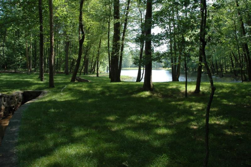

Next is a Downstream picture of my 'Canal' I built ten years ago at the waterfall toward 'the lake'. You can hear it clearly from the house. Followed by a view of the canal Upstream toward the bridge I built and then past that, is the Rip-Rap work.

Ran the tractor almost all day.
22 bucket loads of lily pads I had previously rakes from part of my little lake, that took from 8 am to just before noon to pitchfork into the bucket and haul to the dump site. Ground sure is soggy from all the rain (5") we just got. Almost got stuck a few times.
Then I attacked the ditch. Using the 12" bucket, no teeth, and a garden tractor pulling a little garden tractor dump trailer, I cleared the forty feet of ditch. That took three hours to dig, haul the mix of sand/gravel/dirt to a path back in the woods and I covered/smoothed out an area where roots were making for a bumpy ride. Each cart is about 1/2 yard and I did six or seven carts full.
Then I excavated out the ditch on the other side of the drain pipe about 8" below the bottom of the pipe and about 8' long, seeing the pipe was about 1/3 filled with silt because the people that owned the ditch and drain pipe, never maintained it. Now with a good rain, it should self clear. I set the bucket down and drove away, using the bucket to scrape a ditch path.
