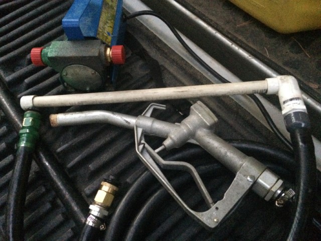

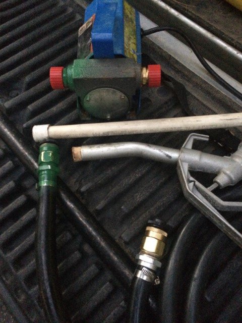

No Zip Lock bags here. It was a bit dark but I went out and took a couple of pictures of how my setup is now:
First, the nozzle has a cork stopper to prevent dust/dirt intrusion and it works very well. The suction and output hoses now have garden hose connectors making the entire setup easy to assemble/disassemble. The openings have caps/plugs and the suction is painted green to prevent a mixup. The PVC suction tube has a cap and is simply wiped off before and after use.
This setup is handy dandy and I seriously doubt that any other modifications will be made.

Thanks for doing that, Magicman. Looks like I've got some thinking to do to get a set up that will work to get the fuel into the tractor, keeping it clean, etc., but also reducing the perfume!

This fuel pump came about as a necessity after my shoulder surgery this past February. I added a 12v block on the sawmill to power the pump, and the battery terminal on the starter serves very well on the tractors.
After the fillup, I let the pump purge the pump and hoses back into the fuel jug. I wear gloves so no problem with the perfume.

Thanks magicman, especially for the photos. I would like to make a similar rig. I have a spare battery that I could leave nearby on a tender. The fill in the 2650 is up on the hood, and if I put about half of my 3 gal in the L tractor first, I can balance on the mower deck and hoist the rest up to balance on another box, but this is less than fine.
