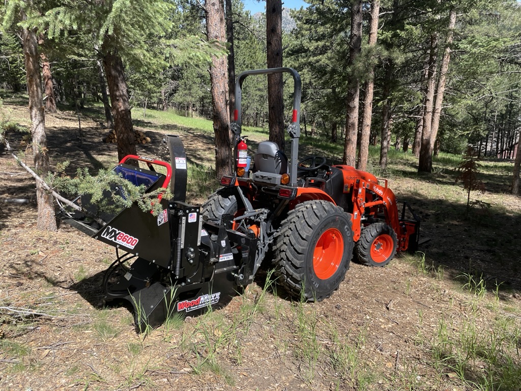

Wow. I traded up from an 18hp DR manual-feed chipper, and this is not even playing the same game. Paying for the hydraulic feeder was *totally* worth the money. Can throw limbs in from 3' away instead of standing there feeding them in by hand the whole time. Probably 8-10X faster getting through a slash pile.
The hydrostatic feeder on the MX is really good. Nice to have the variable speed and instant direction changing.
The MX has very stout construction - the metal seems thick enough everywhere it should be.
(The biggest deficiency of the DR, for those interested, is that it had only 1 knife on the flywheel. Thus, the feed rate is really slow. This one was >15 years old; I think they've gone to a two-knife design for newer models.)
I did have to switch my 3pt to the inner arm holes to get it low enough to pick up the chipper from the ground. It was a little nervous driving around my very hilly property with that load on the back, but the LX did great. I was able to go everywhere I could reasonably expect to (3" rear spacers installed for the summer).

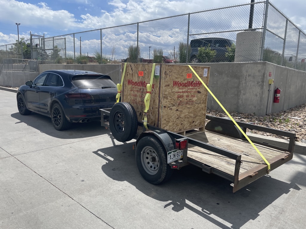

There were out of stock for a while, so I got on the waitlist. When they sent an email saying they had some stock, I ordered that day. Ordering was easy-peasy.
There was a slight nuisance with the shipping - their selected carrier (Old Dominion) claimed they couldn't provide a short truck for delivery to my home in the mountains so I'd have to pick it up a the OD terminal (an hour away). When I went to pick it up, it was obvious that OD doesn't deal with customer pick-ups very much - no signage for how to get into the place, or where to go. Once I got in (had to call to be told which gate to enter), I passed no less than 100 short trailers on my way to the pick-up dock... then waited 30 minutes for them to bring out my skid and put it on my trailer. Maybe their excuse is being short-staffed - pretty sure I never saw more than 6 people in motion at a time in the half hour I was waiting, and this terminal has 213 bays.
That's not exactly Woodmaxx's fault, beyond them perhaps choosing carriers that are more consumer-friendly.
I *did* get some funny looks and comments related to my tow rig..
