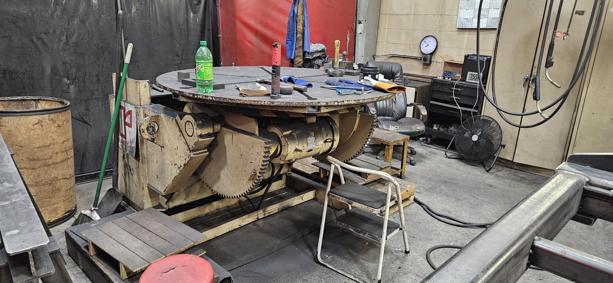

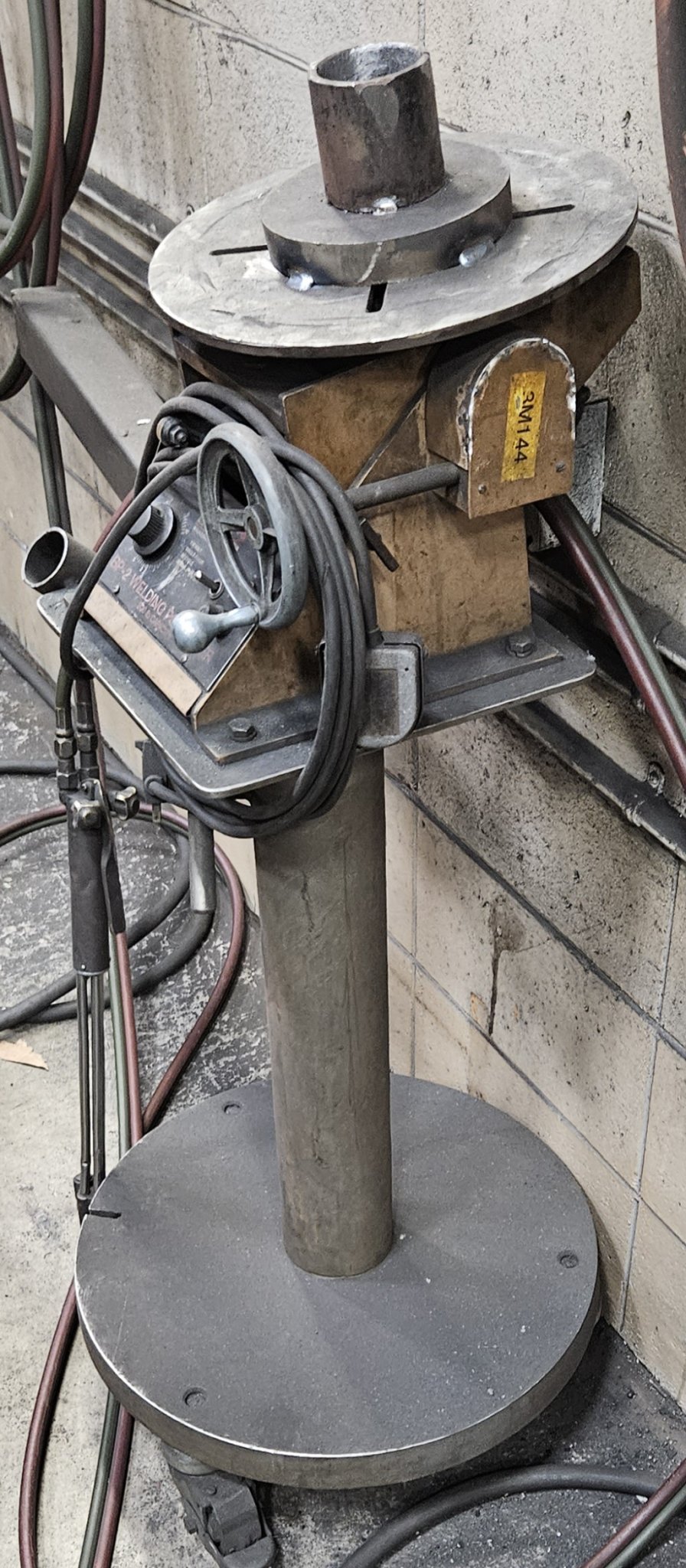

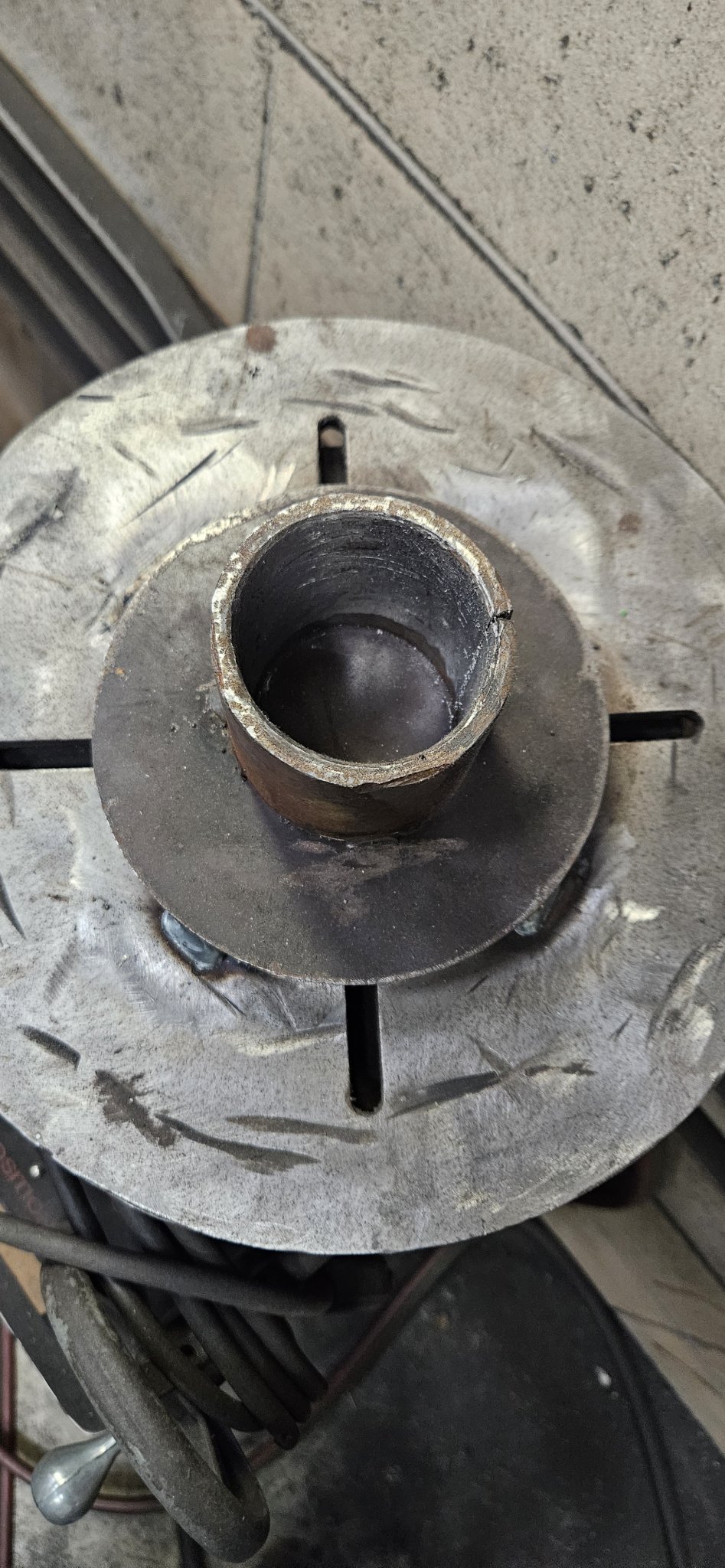

A weld position table is generally flat and the work is clamped to it via hold-downs that fit in the slots in the table. We tack welded a hub to one for a job where we weld something that looks like a brake rotor (and will grind the tacks off and remove the hub for the next job). The threaded spindle on yours hopefully unscrews.
We have a slightly bigger positioner too, if you're wondering.

That's a 'Big Ole" positioner for sure!!!

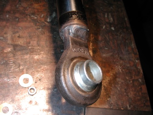

About then, I put together my own top and tilt setup for my B-2910. Not that I ever could TIG very well, but I accomplished the goal and nothing has broken between then and now.
Couple pictures from back then, taken from a thread I posted at TBN at the time:
