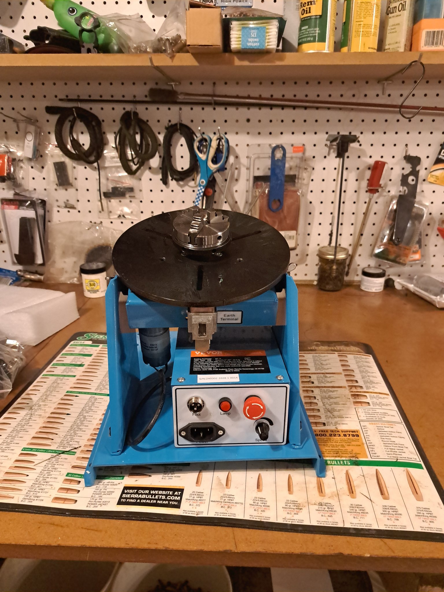

The "Amazon Fairy" visited me recently and here she is.
This is an "itch" that I have been wanting to scratch for quite some time.
Taaaa daaahhhhh......my first "welding positioner"
My first thoughts are
1. Looks good'ish.
2. Chuck is puny.....I kind of knew this, but it was even smaller than my "minds eye" had pictured it.
3. The "turntable" itself is of decent size.
I also decided to grab an "arm rest" to help keep my had/arm a little more steady (pictured on the right)
The "directions" (if you want to call them that) say that the max amperage is 85A, but I figure that is due to the tiny ground clamp wire they have on it.
So I plan to ground it directly the the "big lug" and bypass the small grounding wire.

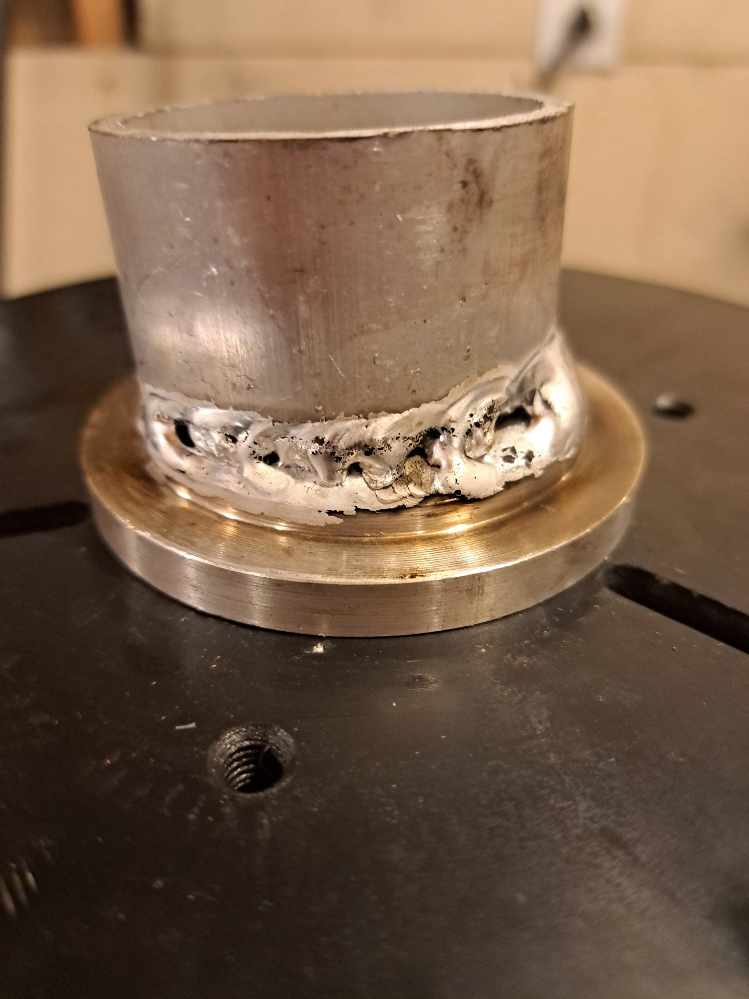

The first bead was bad.......I mean, real bad. The term "hammered dog sh!t" comes to mind, and I am not a happy camper.....
I mean WTF is going on here?
There was something "off" about the pass, it just did not feel right, but damn......
It looks like Helen Keller did this......
I will admit that at first I had to make some adjustments to the speed to get her "dialed in", but this is nuts...
Then it hit me like a sack of hammers......You were in "DC mode" and forgot to turn on the gas, dumbass!!!!!!!

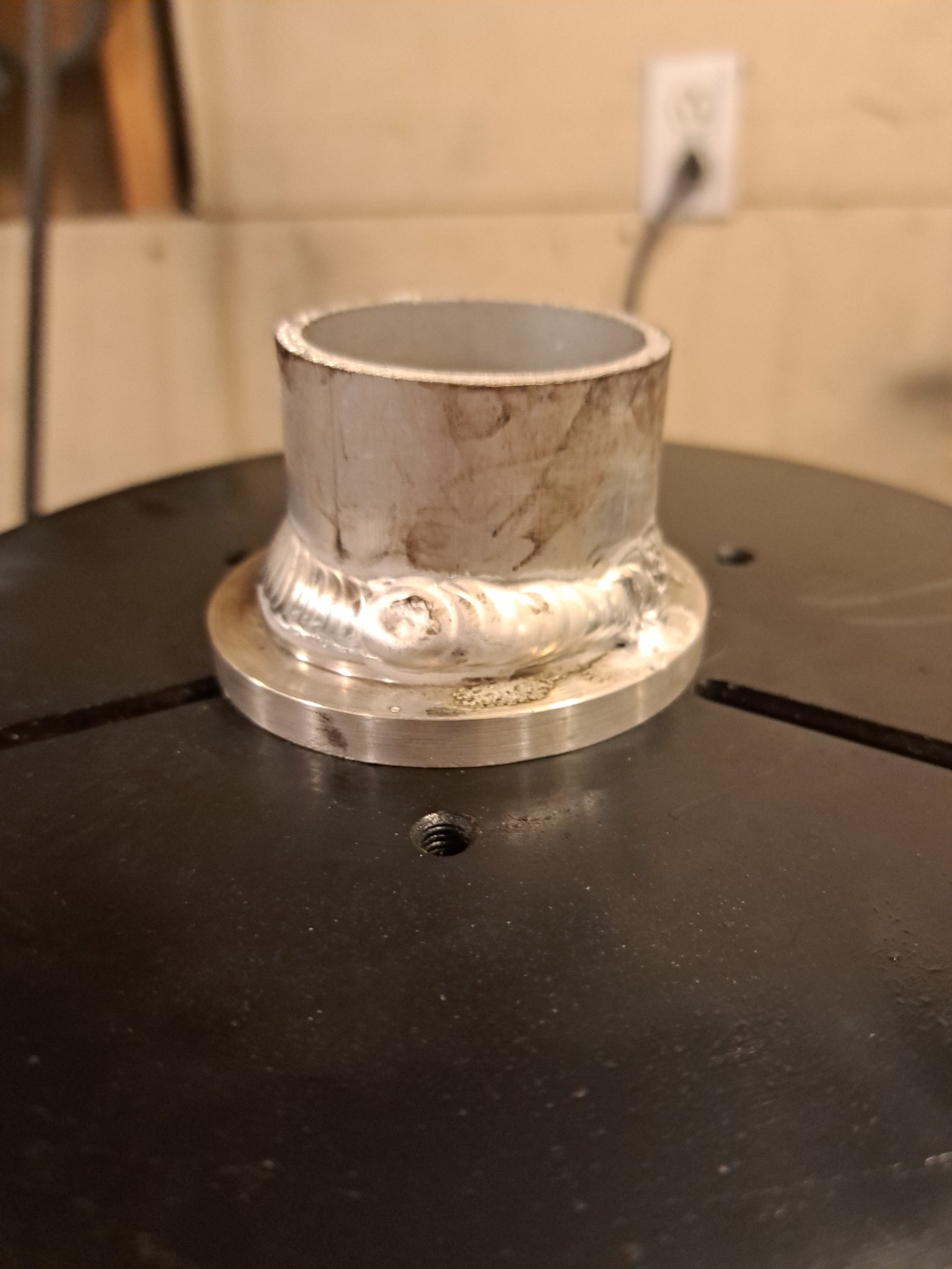

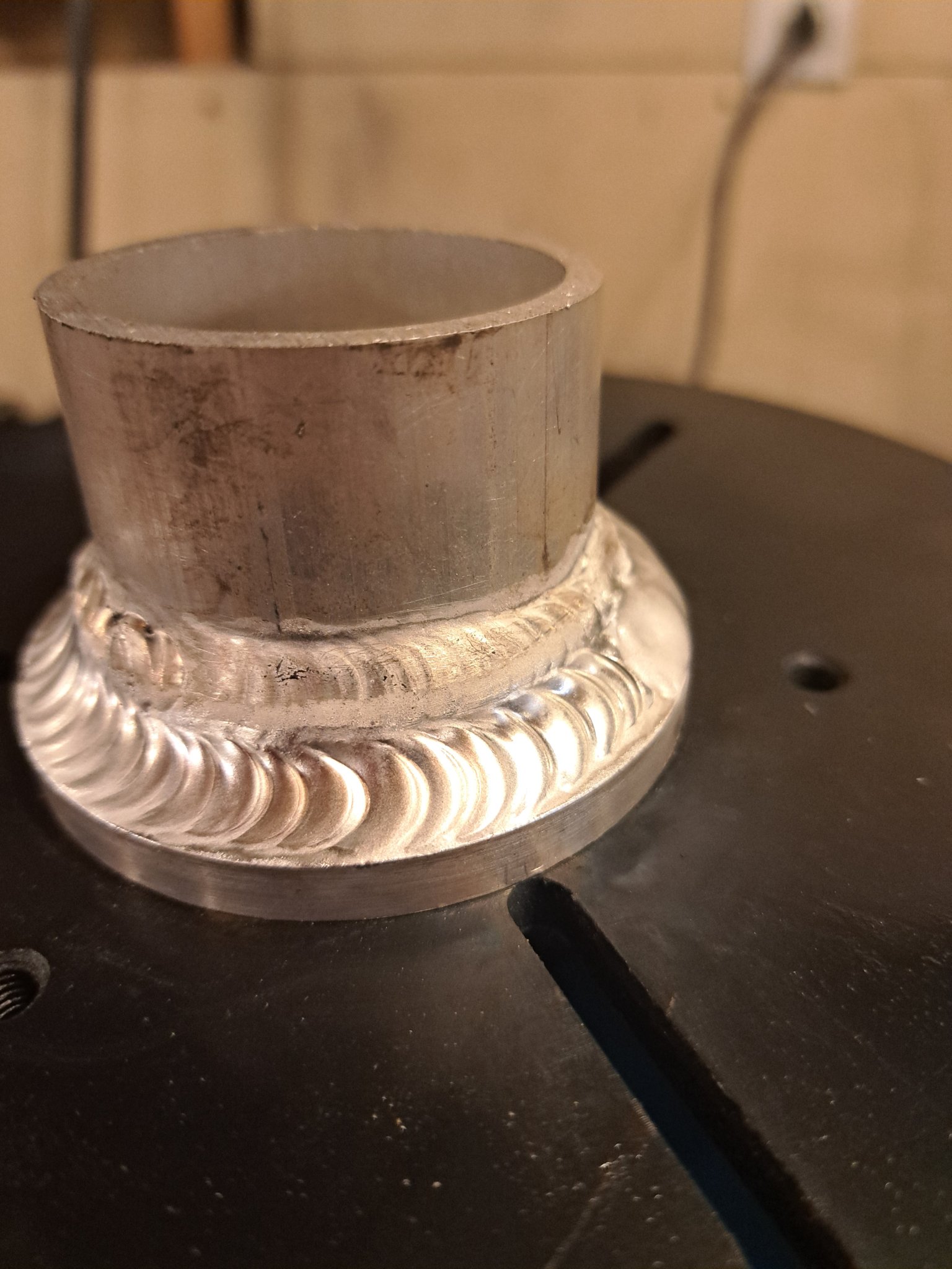

Ok lets have another go at it.....But this time in AC mode AND lets use shielding gas........
Not bad for the "first real try"......Not a "perfect bead" but with some practice I think I can get some decent beads going.
The potential is definitely there.

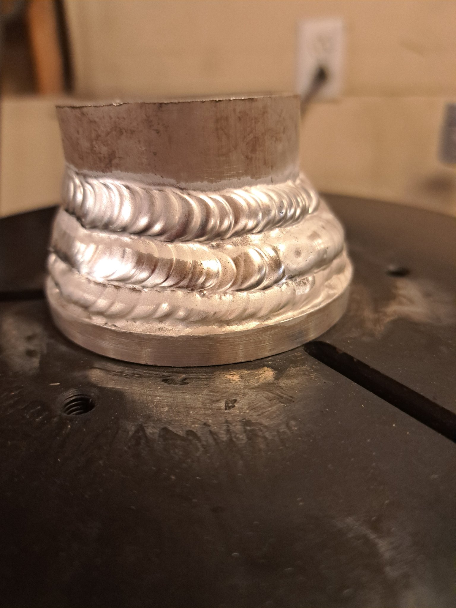

Here are some more passes. Some good, some not so good, but for day 1, hour 1, I am happy.
I still have a lot of practicing to do, but I do believe that this will be an overall "worthwhile addition" to the tool arsenal.

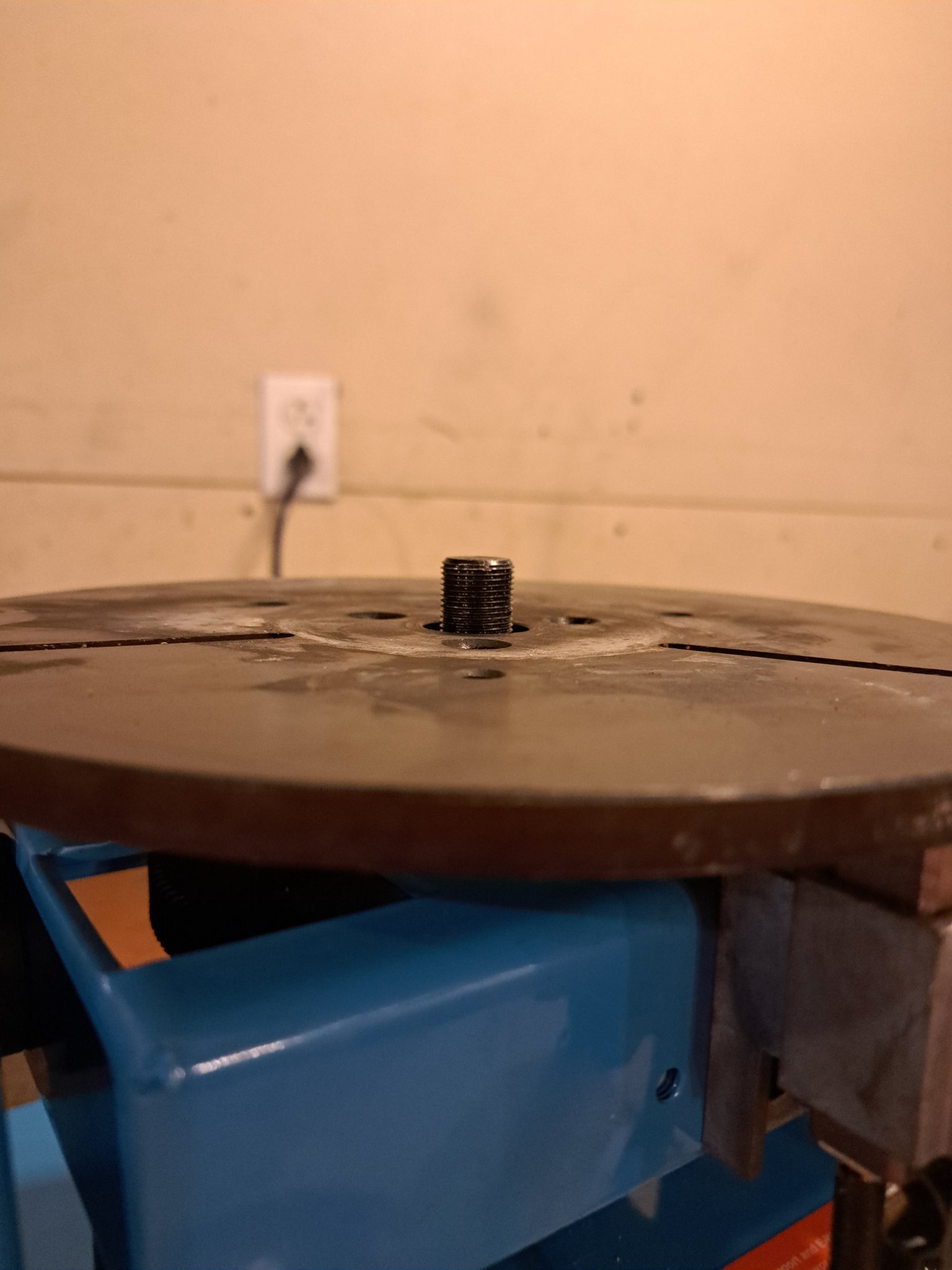

The one thing that I do not like is this "spindle" that sticks up for the chuck

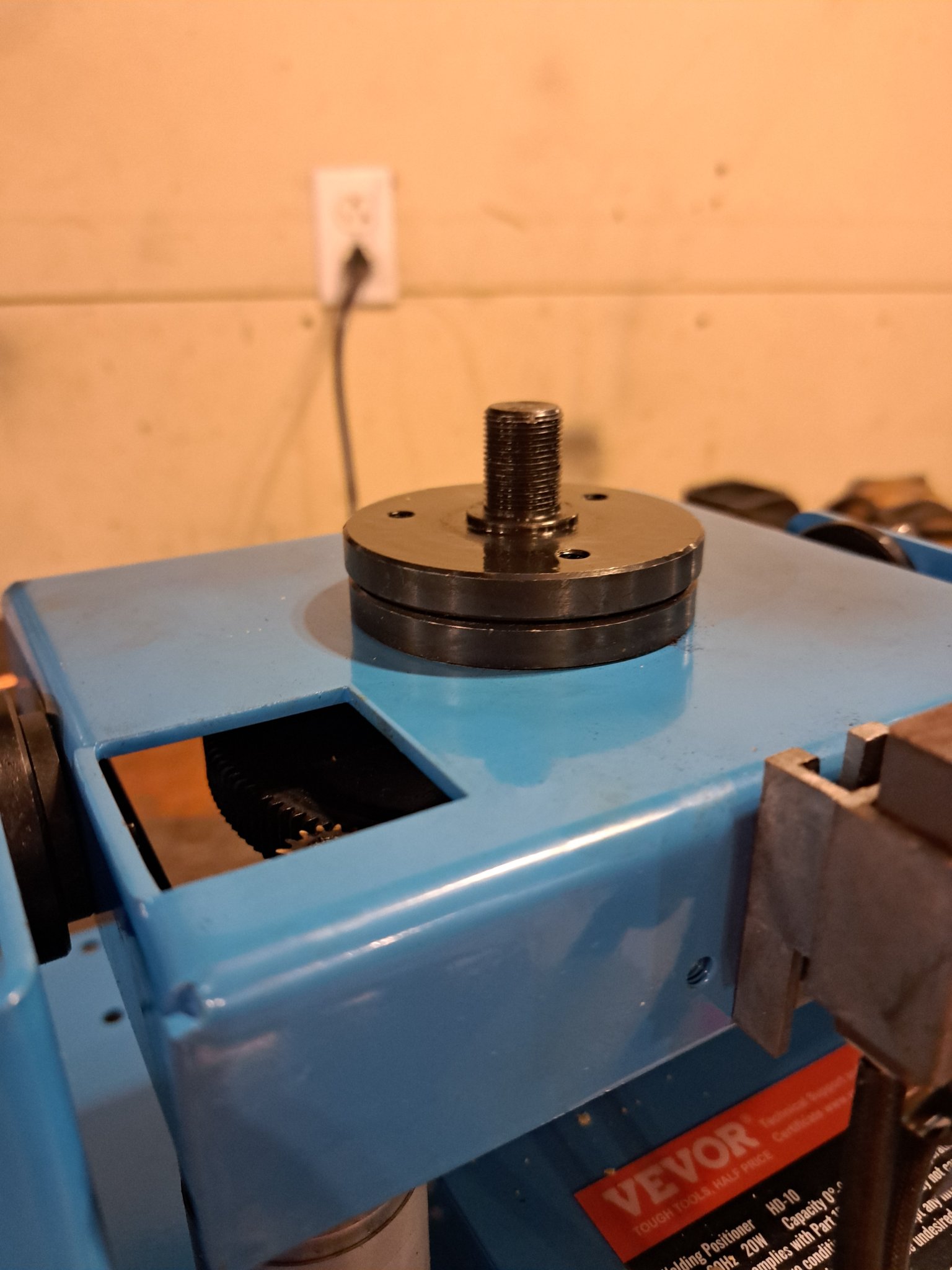

I then pulled the table to find this.
Hmmmm, that is going to be a slight problem.
For one of my projects, I will need a "flat table" because the part has no "hole in the middle"
It almost appears that the "spindle base" is 2 pieces, but it was not budging when I tried to loosen it and I did not want to put "undo pressure" on the tiny gears that spin this table.
I'm going to have to think about this???????

As far as the threaded shaft sticking up, can you make a threaded plate that will bring you up above it. Even better would be one thick enough so it is a blind hole so you can't damage (hope fully) the shaft.

I’m not sure what the machine does. Is it just something to rotate the material? If so, it looks like a small piece would work fine, but what about a large irregular length piece?
Yea, I have a few ideas floating around. I just have to settle on one.
But something like you suggest is top of the list right now, thanks! (y)
Yes, it is for small'ish round pieces. It basically rotates the work, in order to eliminate the need of the person welding to move around.
"Welding Positioners" for large work can cost many thousands of dollars; However, for a shop of my size, this little bugger will do for now.
I am pretty sure that smaller irregular pieces can be done too, I just haven't tried any yet.

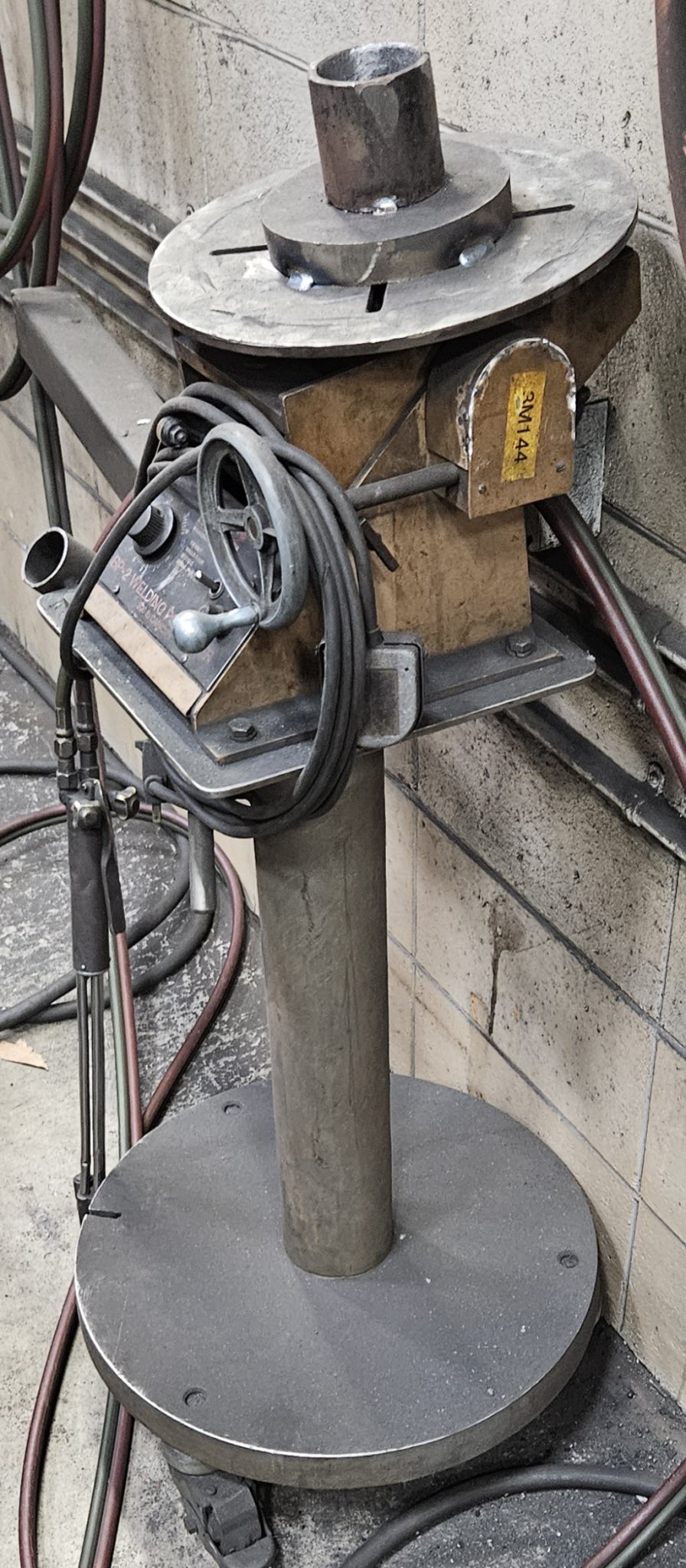

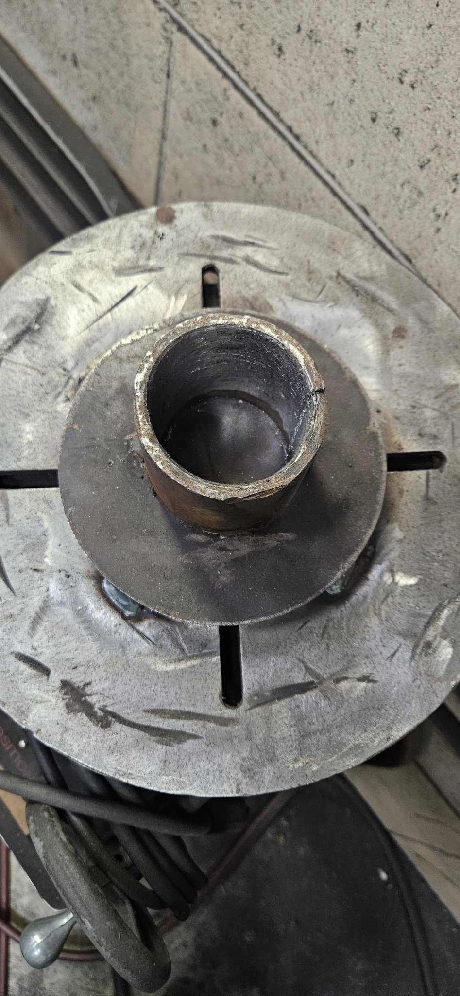

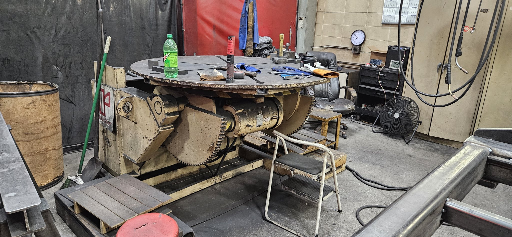

A weld position table is generally flat and the work is clamped to it via hold-downs that fit in the slots in the table. We tack welded a hub to one for a job where we weld something that looks like a brake rotor (and will grind the tacks off and remove the hub for the next job). The threaded spindle on yours hopefully unscrews.
We have a slightly bigger positioner too, if you're wondering.
