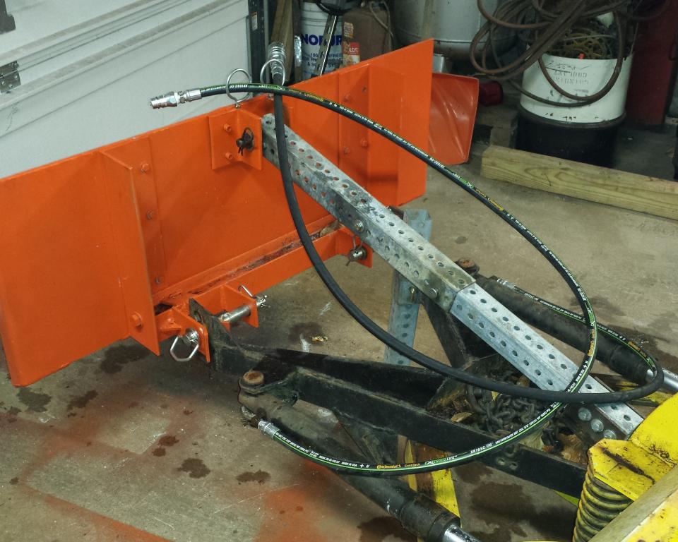

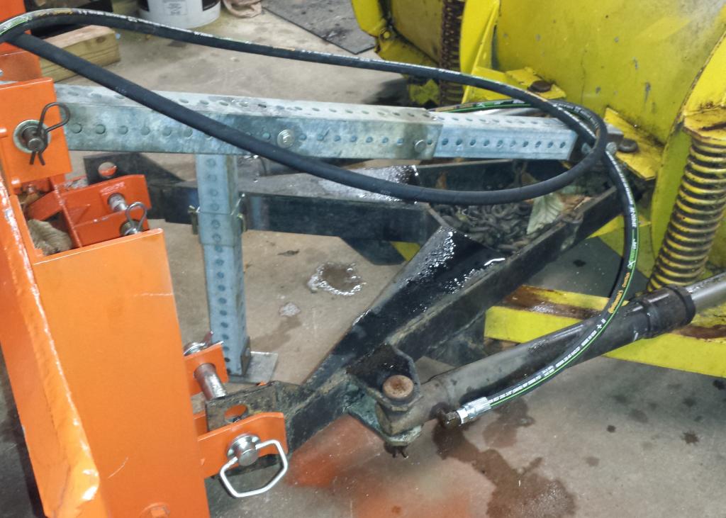

I attached a Fisher push bar from a 1971 International scout and a 7-1/2 foot fisher plow to a SSQA plate with third function hydraulics, it plows my 340 foot driveway with no real issue. I wanted my plow to have down pressure for back dragging snow from my under the house garage driveway so I made an adjustable stiff hitch and can attach the chain for full float as the fisher was original designed if needed rather than using the FEL float function.
The only issue is if angling the plow with a full moldboard or heavy wet snow the tractor front end will skate sideways a bit, front tire chains may help that issue, I am running R4’s on a L3901 HST.
I wanted my plow extended as far forward as possible due to the fact I push snow into large piles and over a steep bank and want my tires on hard ground.
