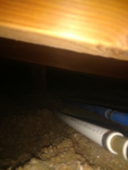

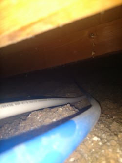

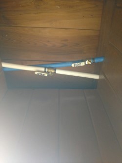

The water pipe flooding/failure mentioned above occurred in the heat of Summer. It was diagnosed having two failure modes… a 90-degree joint was installed immediately OUTside of the house… connecting the horizontal pvc from the attic meeting a vertical pvc external to the house….but due to the assembly-sequence the horizontal portion was glued and pressed-together without the requisite “twisting” recommended for glued joints. (Could not be twisted because it was first glued to the stationary vertical.) That joint served well throughout the winter and well-into summer before it “let loose”… and water pressure propelled the horizontal pvc backwards into the attic…delivering 5-gpm of water for two days into the attic. (We were away on vacation.)
The PEX replacement water lines (installed just this last fall) over a rebuilt utility room, were laid in the attic….then covered with blown-in cellulose. Two shut-off valves were installed at the junction of a pair (hot/cold) lateral lines leading to a utility sink. In order to access those valves, an access panel was installed, which incorporates a “riser” (square access panel needs short riser-walls to prevent cellulose from falling into the room when valves are accessed.)
Unfortunately…. this raises the pex at those valves…above the cellulose-layer, exposing the valves to cold attic air. (The cellulose is intended to prevent the loss of room heat into the attic…or stated another way….basically insulates the attic from the rising warmth of the room.) The pex/valves assy is therefore in free-air.…exposed to the cold attic conditons….and frozen. 😟
Yep… I’ll have to slide foam insulation over them. Meanwhile, I’ve opened the access panel (as if to access the valves) and allowed the heat in the room to rise to the valves….which has thawed them and now they are closed.
