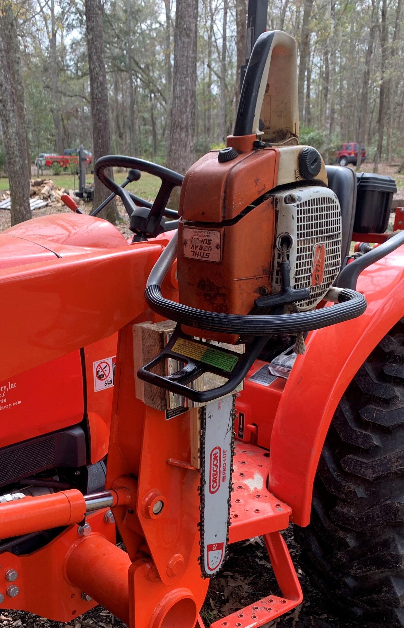

Any ideas floating around for a DIY chainsaw scabbard?
I know SawHaul will sell me a nice one for $129 +tax. I see Koplin has one which looks less than ideal for $65.
There must be someone who has solved this before me. A search didn't come up with much.

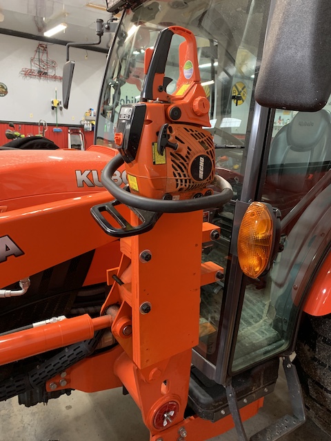

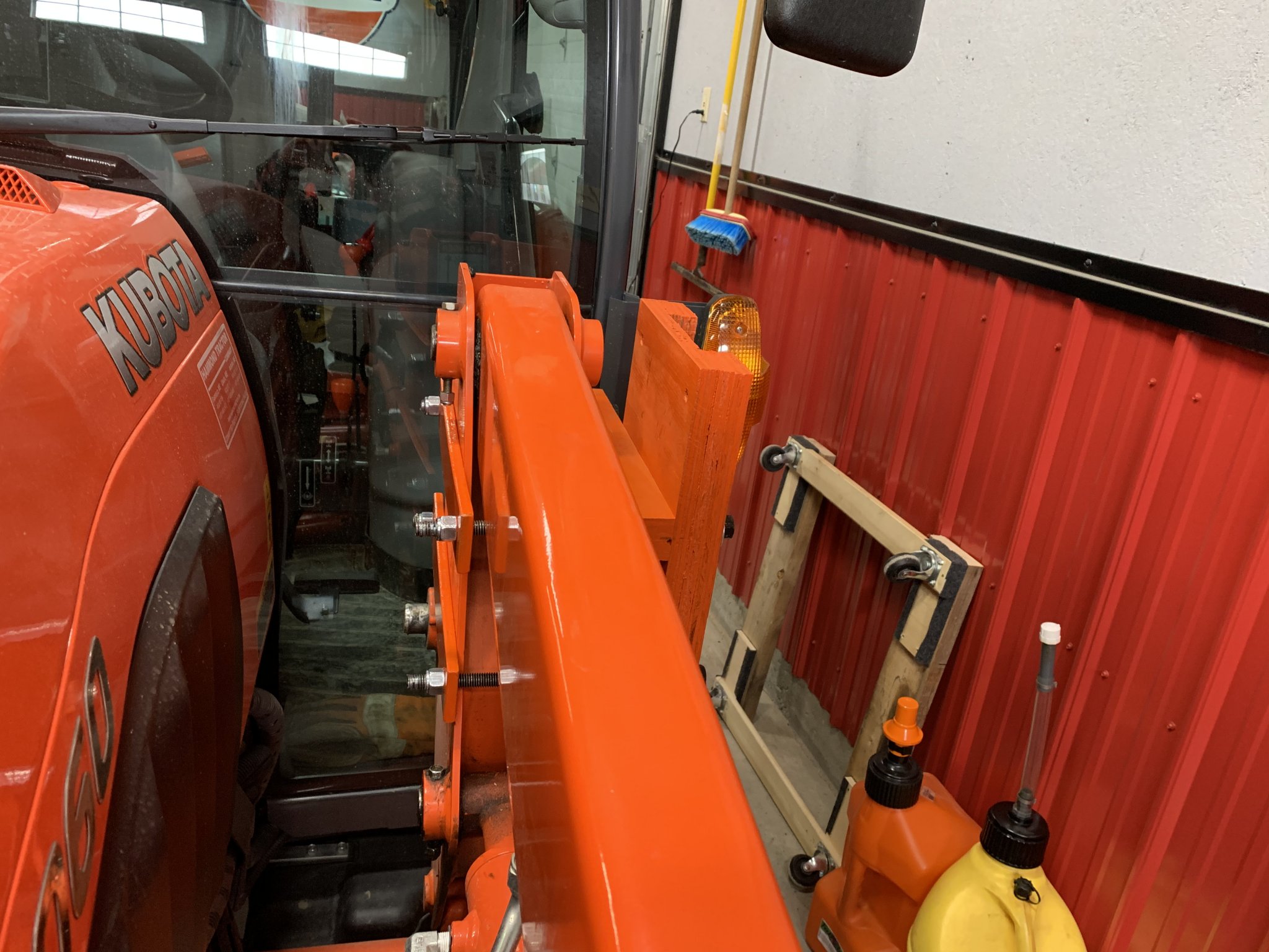

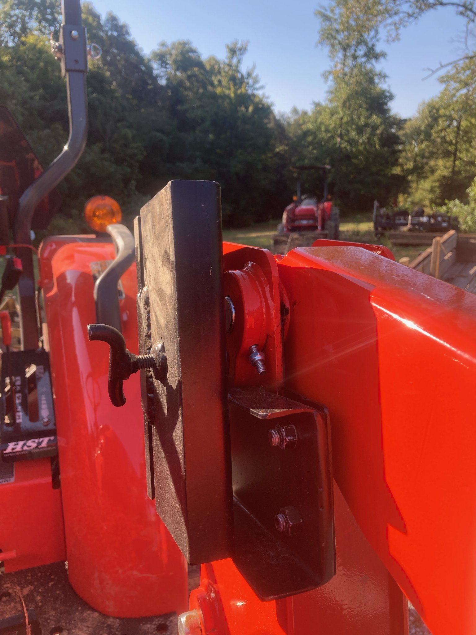

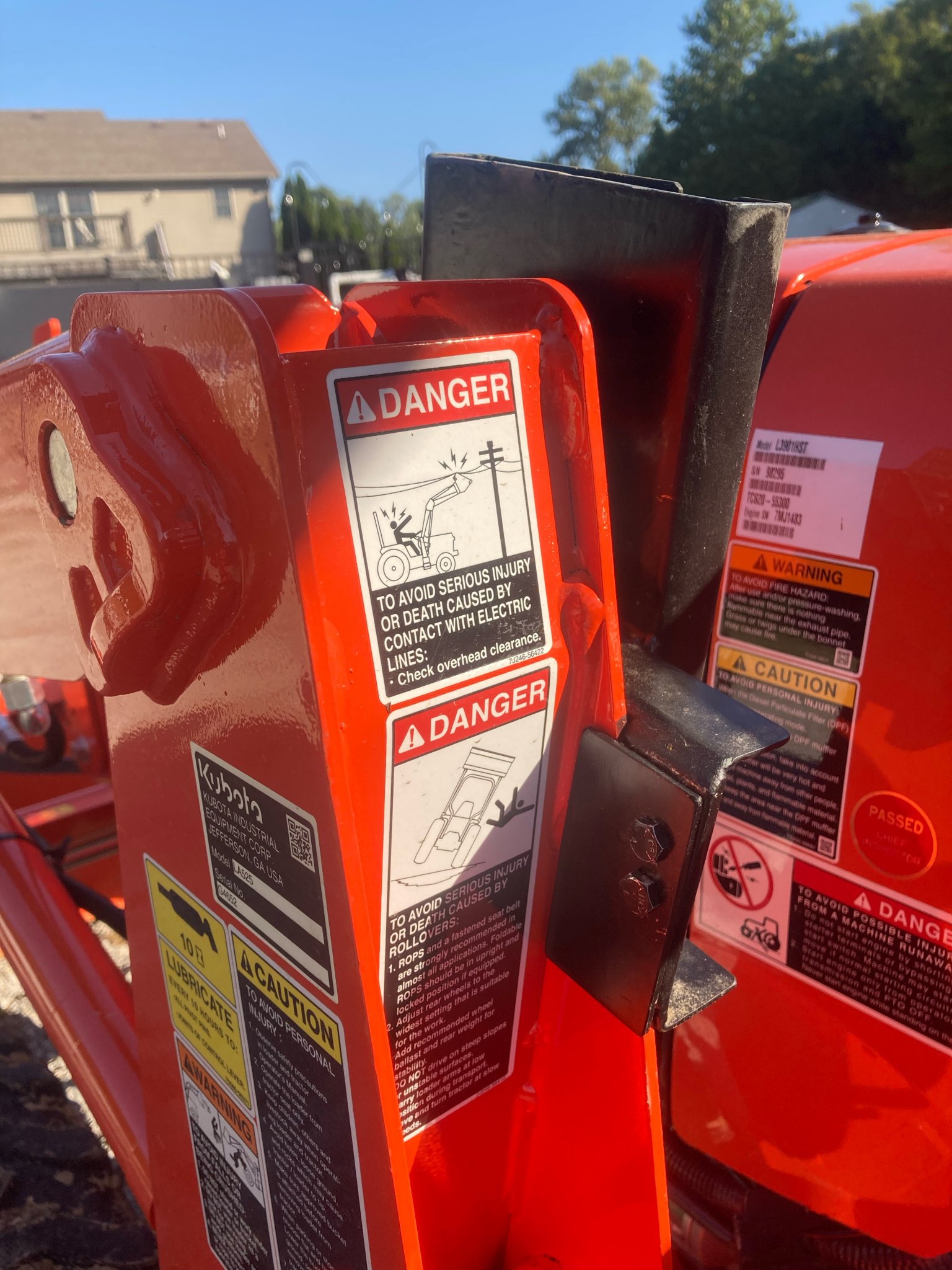

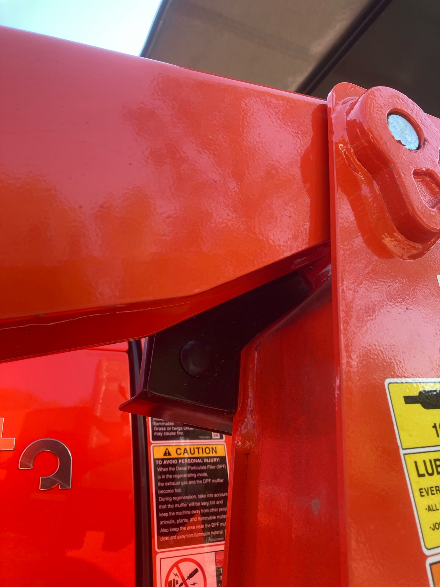

Here’s how I did mine, it attaches by what I’ll call “pinch plates” I couldn’t bring myself to weld on my new tractor. All from scrap I had on hand.
Mike

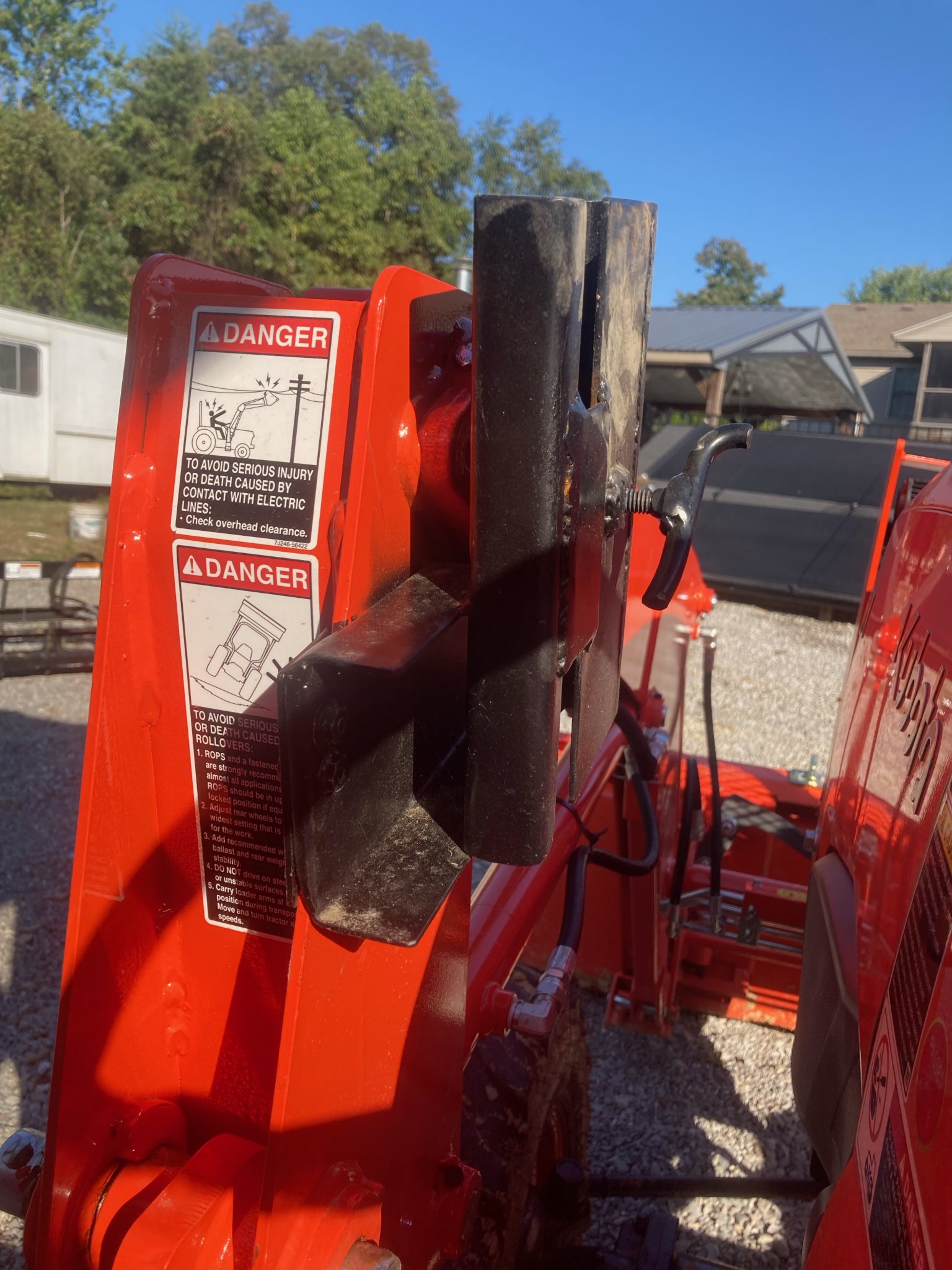

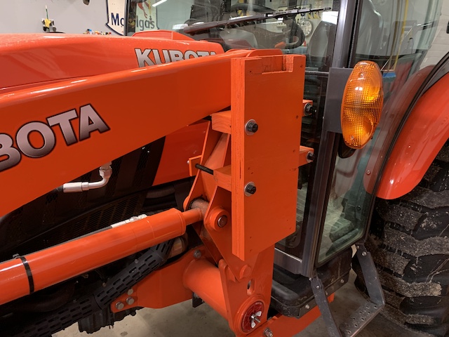

This one was pretty simple using the original scabbard.

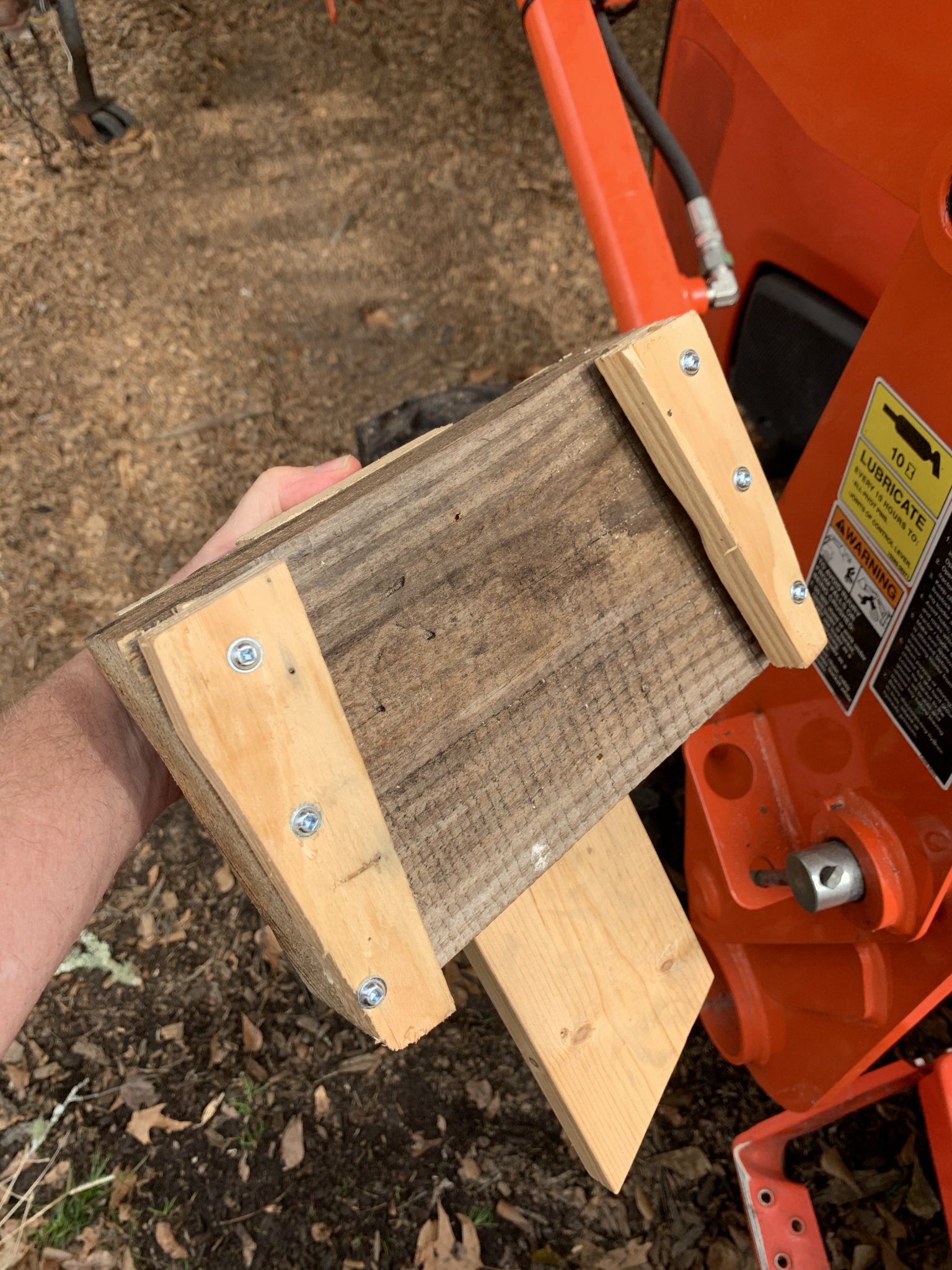

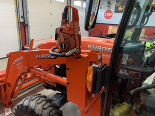

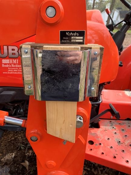

This is what I came up with. It just slides down and friction holds it down on loader arm. I have never had it come off due to bouncing up and down while driving in the woods. Also never hit the bar and chain with my leg getting on and off tractor. A simple DIY mod.
