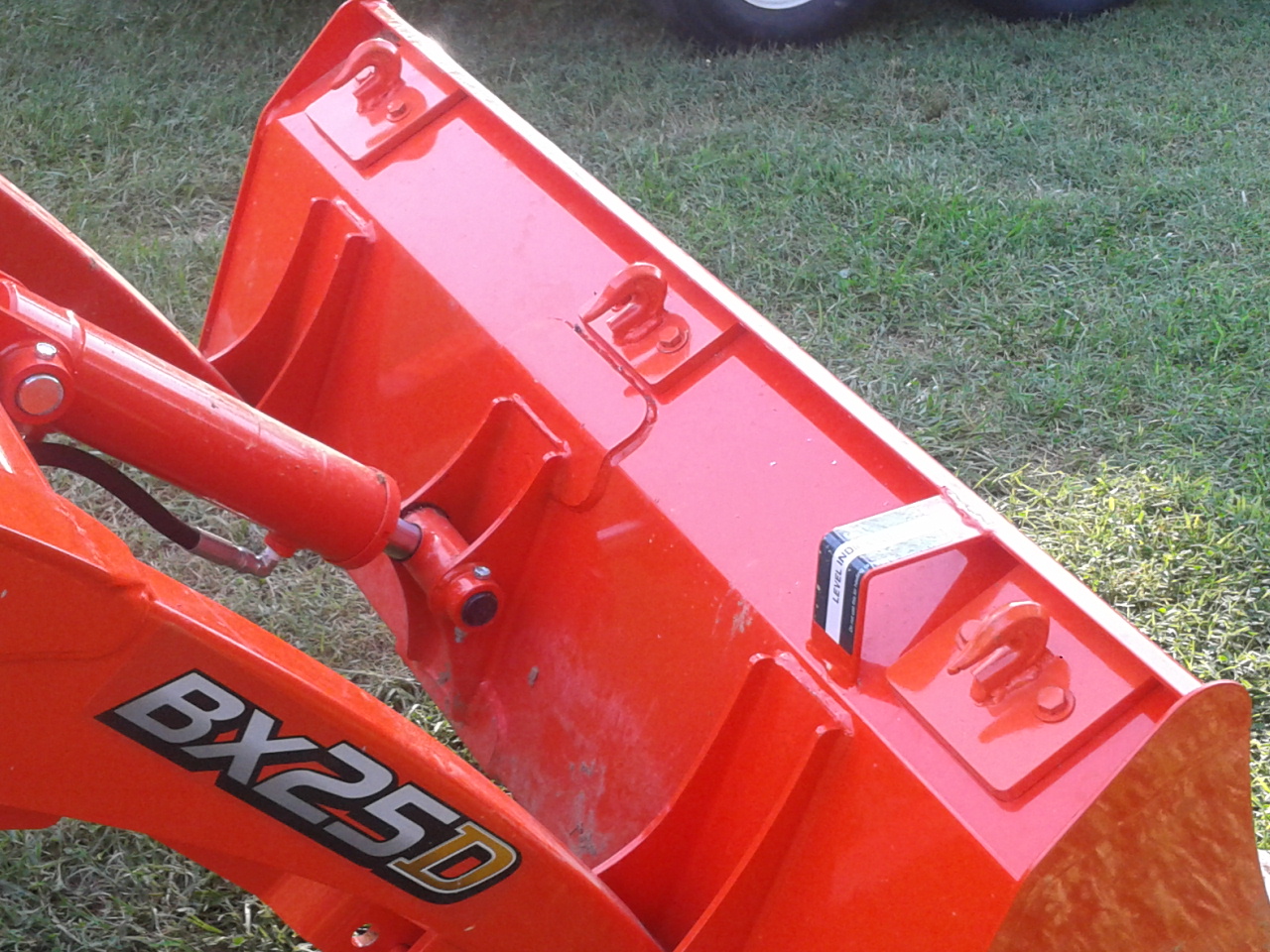

Dont over think this. If you can weld even remotely well stick some Grade 70 weld on grab hooks to the bucket AND forks. I prefer three as shown below. For a B2601 5/16 (8mm) chain should be all you need. You can turn grab hooks into slip hooks, D rings, or most anything else with a few links of chain and the desired ends.

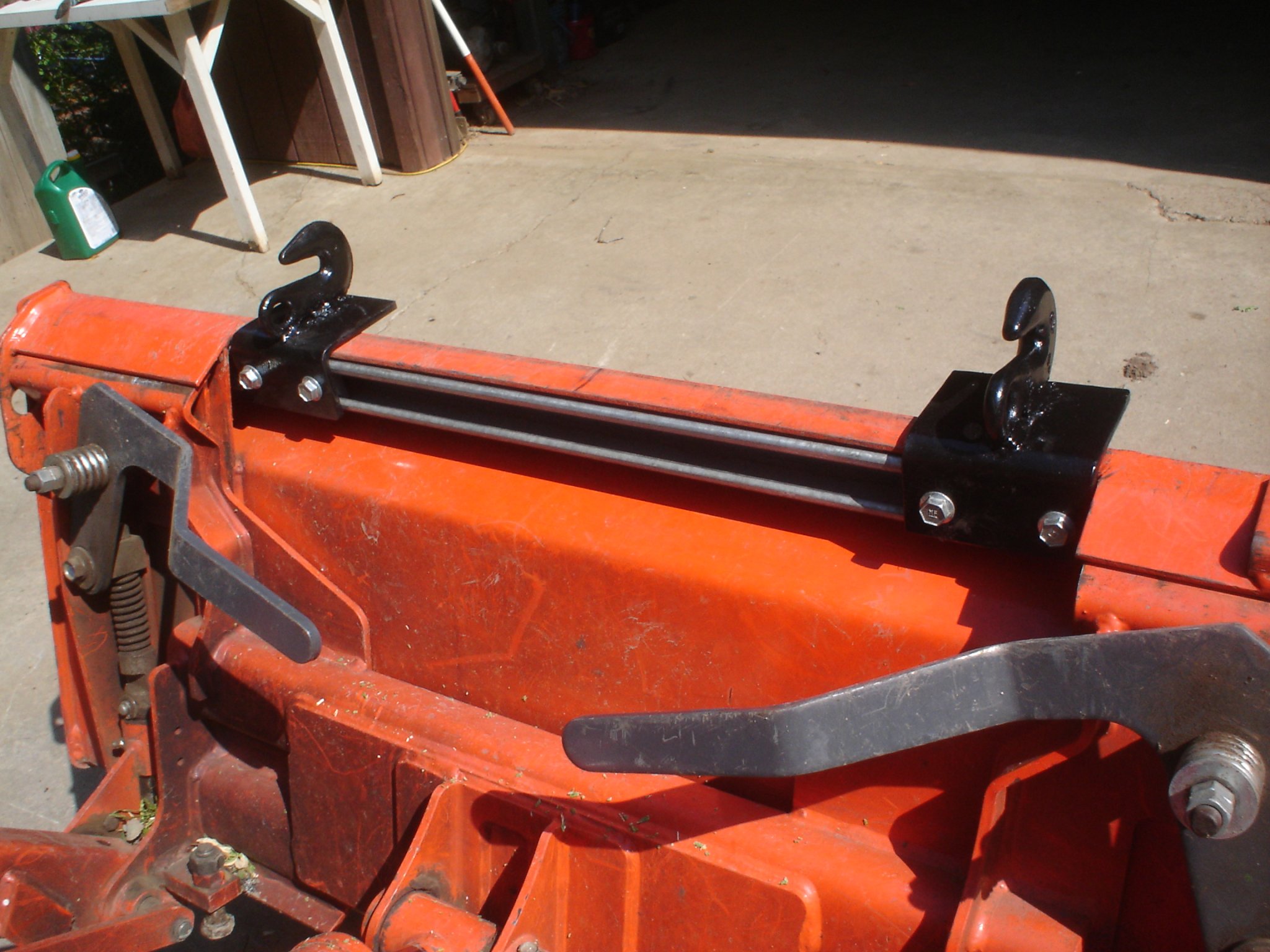

here's my no weld- no drill solution. Hooks welded to pieces of 2x4 angle bolted to a section of electrical strut. Makes it easy to carry 'fun' things like barrels of water , drag logs out of the bush.....
Looks like a good solution. Having trouble seeing how it is held on the bucket without drilling. Super magnets? :LOL:
May be missing something as I don’t have a quick attach set up.
Looks like it's just hooked under the top edge of the bucket. So you can just drop it on when you want to use it.

The electrical strut section is about 6" longer than the gap, so you angle it in, then back,so it overlaps each end evenly.The bolts that hold the hooks/angles on keep it from moving left or right. 'Magically', it also 'snugs' the strut to the bottom side of the top lip so the whole unit is firm and doesn't rattle.
If I was to make a version 2.0, I'd use 2 sections of strut to fill the 'slot'(not just the 3" overlap...) and have a 3rd hook or 2" receiver to join the 2 sections together. I have to admit it's mighty strong.
I think I see it now. The strut slips into and under the lip, and then you slide the brackets over and tighten the bolts to hold it in place?

yes Henro , that's how it works...
It cost me nothing to make as I have a 5 decade 'collection of stuff'.... and made for an interesting morning project.
Sure I could have welded the hooks on, or bolted them on but I like to figure out 'options'.
