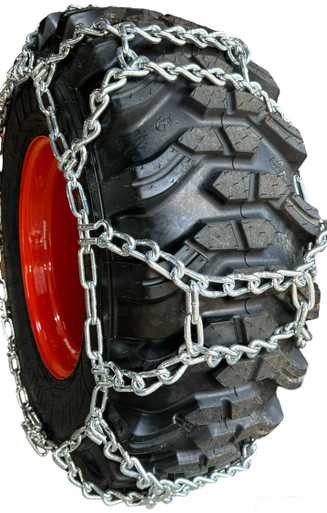

Have decided to invest in a set of rear chains for my B2630- practically new R-4's with Brotek rear spacers. Have settled on the DuoGrip H pattern from Canadian Chains after watching a couple of videos and reading some reviews. Where I am stuck (sorry-unintended humour) is whether I should spend the extra $200 for the V bar version. I'll be using tractor to plow road in which is basically a dirt track and might be skidding some logs and using tractor and grapple for loading logs onto mill in fairly flat field. I have a 900 lb rear ballast that would be mounted when not using the rear blade. Chains are a major investment, just not sure if the extra $200 would be money well spent. Any and all insights appreciated. Cheers, Erik

I think you chose the right style chains for the R4 tires. My ladder chains with R4 tires mostly fall between the tire lugs.
Prices are what prices are. Even simple ladder chains are expensive these days.
Whether the extra bucks would be beneficial or not, I do not know. But what I do know, that if you do not spend it, you will never get whatever advantage that $200 might have gotten you. Once you buy your chains you will not buy again. Trust me...

The DuoGrip (field chain) design puts a lot of chain to work and is what I am looking to buy. I have a variant of that design on an old Ford and they are very effective but ride on hard surfaces is definitely not "smooth".
The extra $180 for the vee bar is probably a marginal increase in bite (no personal experience) but not a huge investment in the long run. I would be very tempted.

So, yes, shipping is included in price. Leaning towards the V grip option a bit more. Sort of the mind that if I spread that cost over the lifetime of the tires/tractor it sort of takes the bite out of the extra cost. I won't be using the tractor on any paved surface but will be using in the woods and I have noticed that many actual skidders use pretty aggressive chains. I don't think you'll regret installing spacers when you get to that, has made a significant difference to my machine. Thanks, Erik

Where the V-bar chain will shine is on hard glare ice. In my experience, even a twist chain will struggle to bite under those conditions where the points of the V-bar will dig into the surface. Not sure where you are, but we can get some nasty ice storms here in New England where you need all the grip you can get. If you can afford the additional cost, I'd say definitely get them. If nothing else, they will add even more weight to the rear wheels.

I am exactly where you are with my b2620. Its helpless in the snow as is, so I pretty much park it and use my farm tractor all winter. But I finally decided to get chains this year so I can get around if I need the bucket. I have settled on Duo-Grips and no way would invest in the extra cost for the v Grips. As someone already said, they would help on glare ice, but I am not willing to spend the extra $ for that.
I really wanted double ring chains like my big tractor has, but they don't make them in that small of a size.
