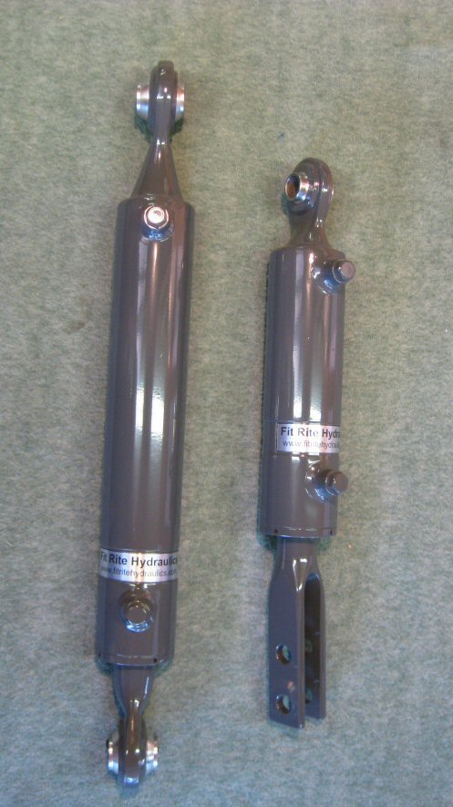

Technically your tractor is a cat 1-2. you can use either cat 1 or cat 2 implements. The tractor should have come with reducer bushings for the 3 implement pins to get down to cat 1 sizes.
The only off the shelf cat 1-2 top links that I know of have the wrong over all working length for your tractor.
I normally provide a 2 1/2" dia cylinder with a 1 1/2" dia rod with a 23 1/4"- 35 1/4" working length.
Unfortunately my lead times are a minimum of 36 weeks at this time.
If you want an off the shelf top link, I would look at this one and just grind down the ball swivels to 1 3/4" and use a reducer bushing.
Good luck.
